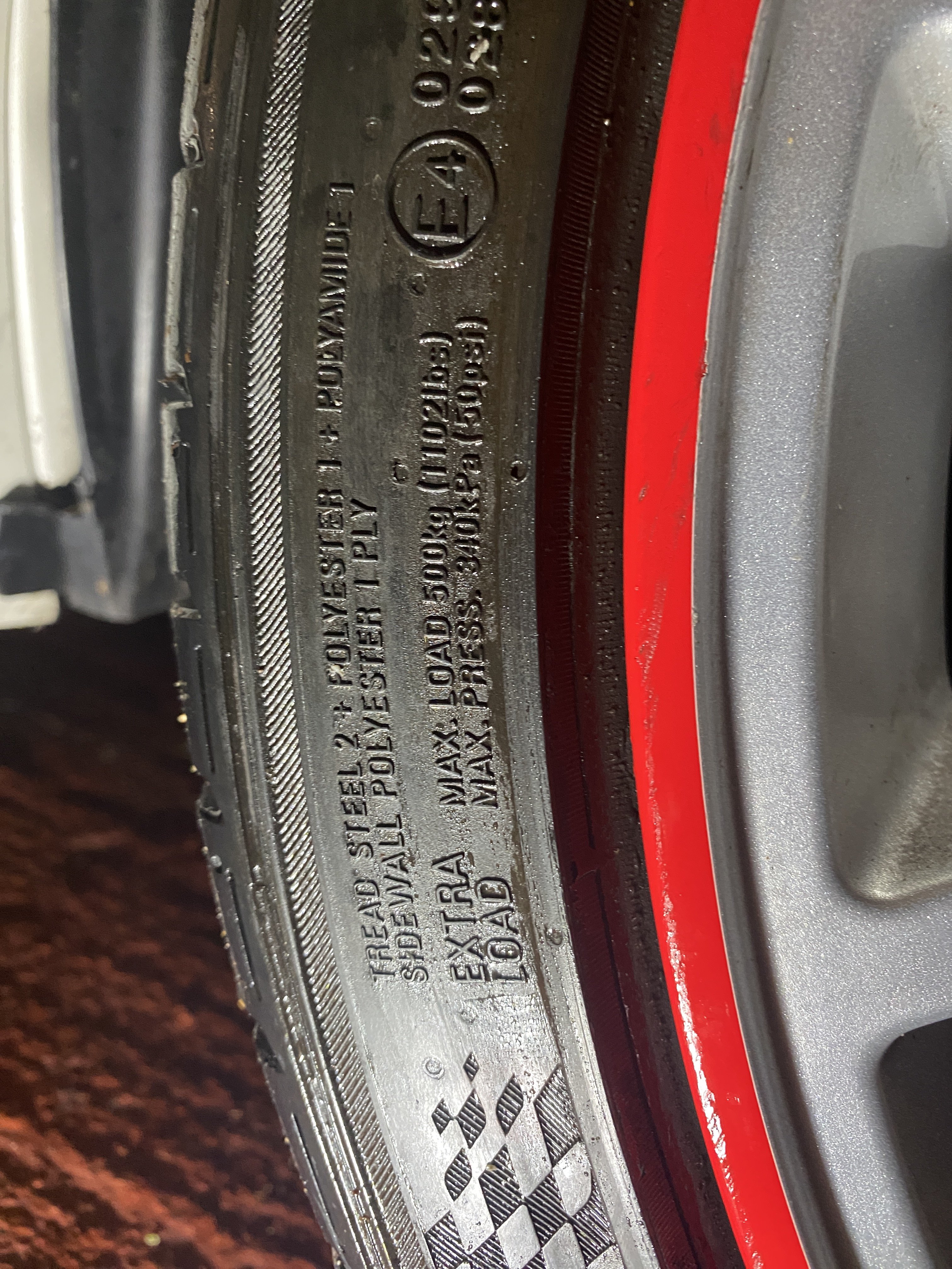

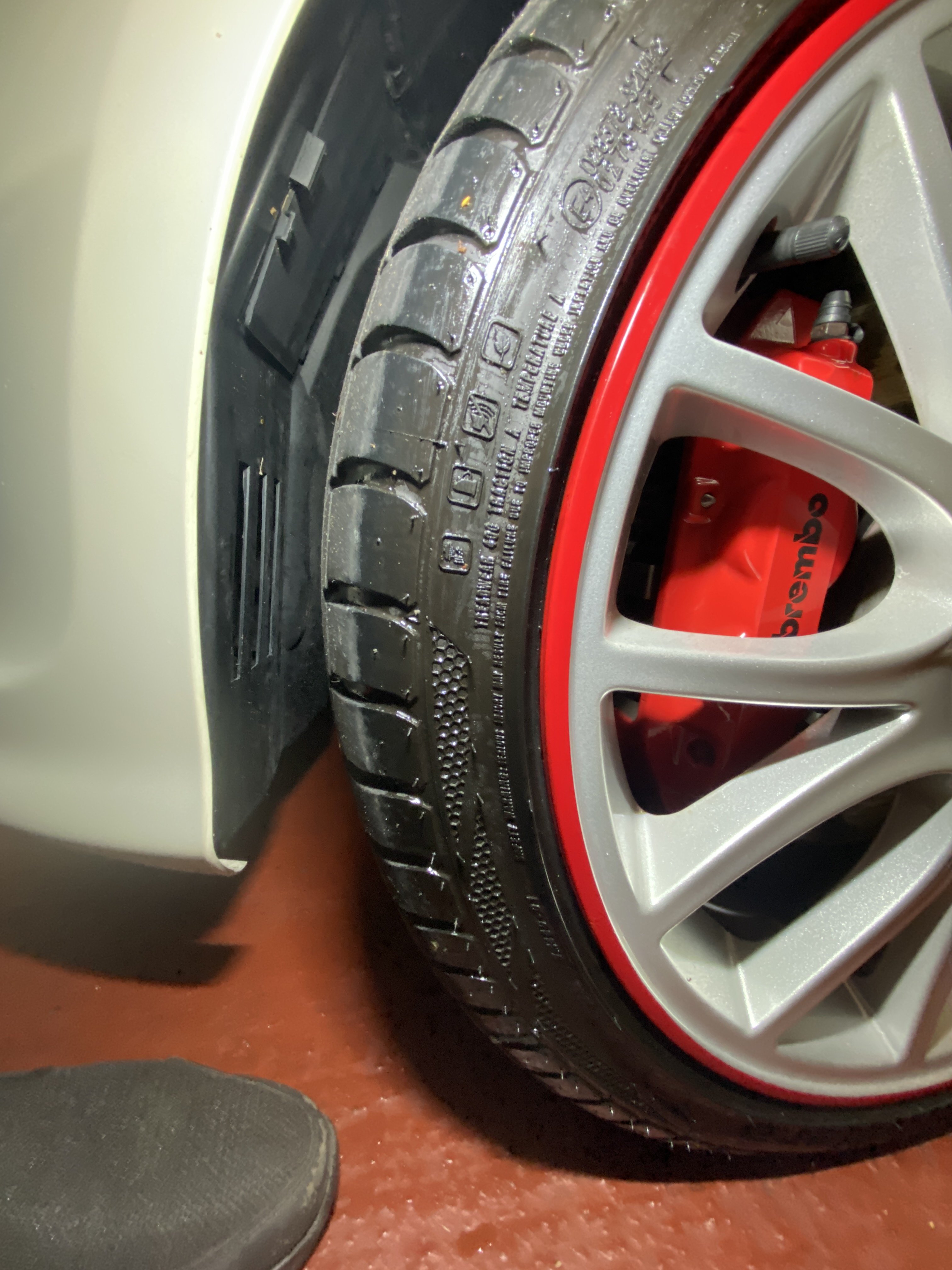

At the moment all 4 tyres are Kumho but as I said they feel every stone in the road. Do you think Mitchelins would be more comfortable or slightly softer ride.IMG_1671.jpegIMG_1672.jpegIMG_1677.jpeg
Zaphod is correct, you won't get a softer ride on 17s, not sure if the the Anniversario has bigger brakes, you could fit 16" wheel, if they go over the brakes, but you're in a world of modified car insurance.
I don't think Uniroyals are made in your size/spec., but if I'm wrong buy them. Otherwise Michelin, as said.
The other thing that would make a difference would be to drop the pressure by a little, say 2-3 psi, no more than that.

KUMHO 205 45 R17 84V PS71​
At the moment these were the tyres fitted to the car when I bought it 3 years ago. The DOT date is 2017, I was surprised the walls are cracking at least that’s what the MOT advisory notice said last year so I don’t want another advisory. Not sure if Kumho are any good, S/korea. It’s a nightmare as there are so many variations 🤔. really appreciate the response from everyone 👍
I'm surprised you don't get rubbing issues with a 45 profile, from the date of the car it would seem these were the 2nd set that were fitted.
And your speedo will be out with them.
And I'd also suggest cracking walls could be down to being driven with low pressures consistantly , although they are getting on a bit I wouldn't be surprised they were run low.
Kumho PS71 is a good tyre, nothing wrong with it. Thing is 45 profile (92mm) sporty sidewall. Best option for comfy is higher profile, if your MOT allows compatible tye sizes like 215/45/17 (97mm) and higher. May be going to R16.
