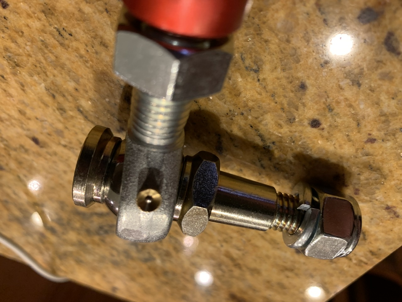

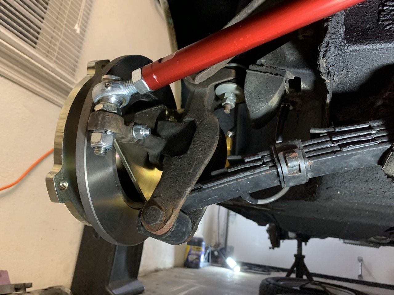

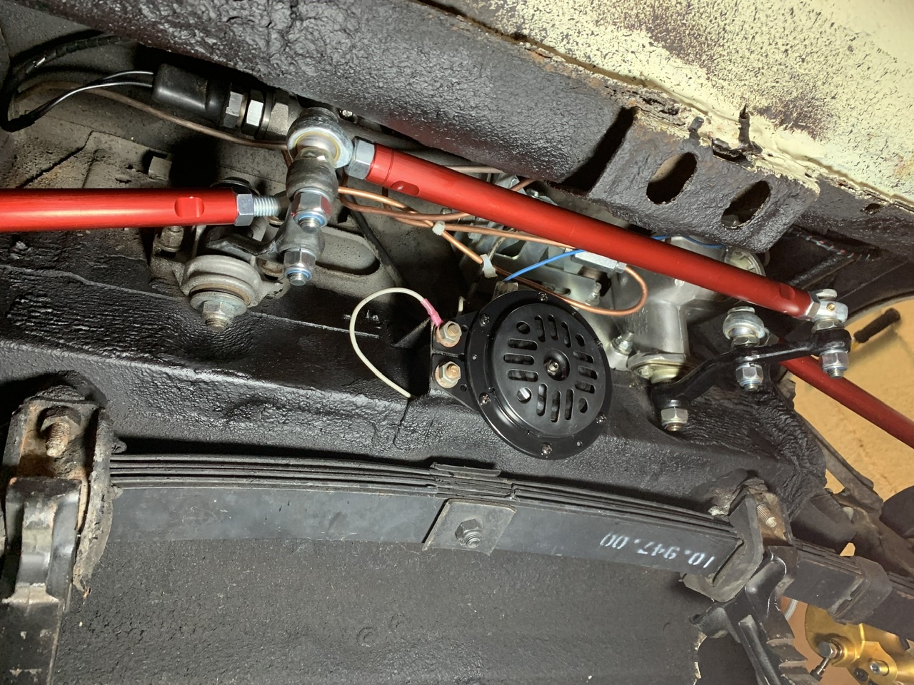

You mean uniball or heim? I have them only because I had a clearance issue for my new front discs. I had to discard relatively new conventional ball joints and center link for these. They work really well for me; steering has to be about as tight is it gets on these cars. Still a little bit of vague feel when going fast and straight, but not really any slop. Car steers well.

I think that for the mileage that the average 500 user does over a number of years, the standard track-rods will suffice. As 'Uaglio' says, he only got them for a specific reason.
Those are the ones I was looking at. I’m not super concerned with staying original here because it can easily be put back and I drive the car pretty regularly so better handling (relatively speaking) is what I’m focused on
Yup. Got them from Ricambio. They will certainly work. But they are really a racing application - they don’t come with rubber boots to cover the joints; you have to clean and reapply PTFE dry lube periodically to maintain them. That’s not an issue with mine - it never goes out in rain or bad weather. But these are definitely less practical than the original style traditional greased and rubber-booted socket ball joints.
