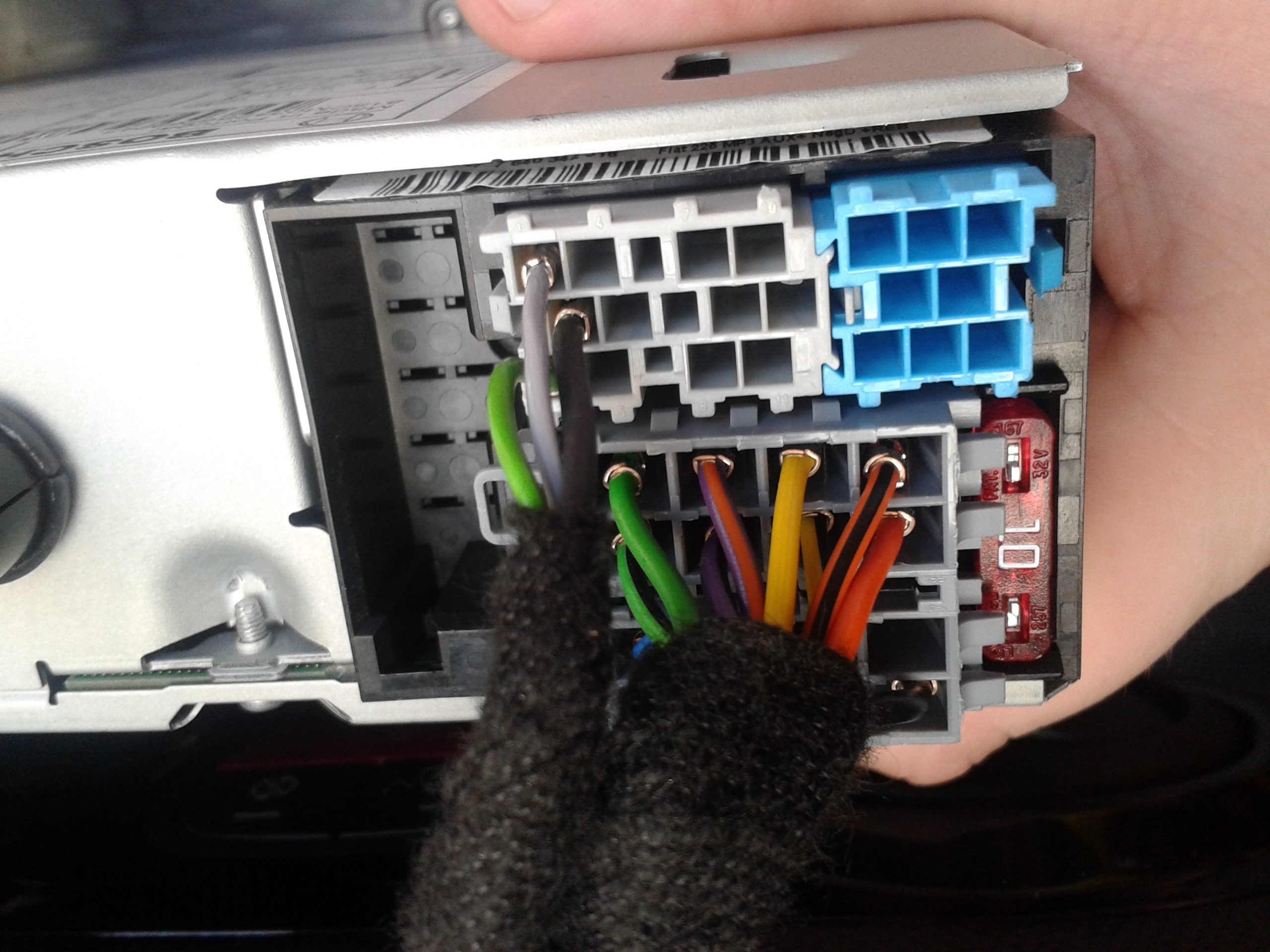

Got radio out **** of **** 2 seconds flat with the right tools but after getting the radio cage out I failed I couldn't find a way to pop the hazards out any ideas?
I have got a pic of the back of the radio to show the wires how do I upload them ?

As promised one picture of radio cables and one stupid picture was in a bit of a funny mood after work

I kinda get the idea that its beginning to be a bit of a 'bigger' job than perhaps you hoped for.
Good pictures though, well done, its like the 'black art' uploading to the forum.
