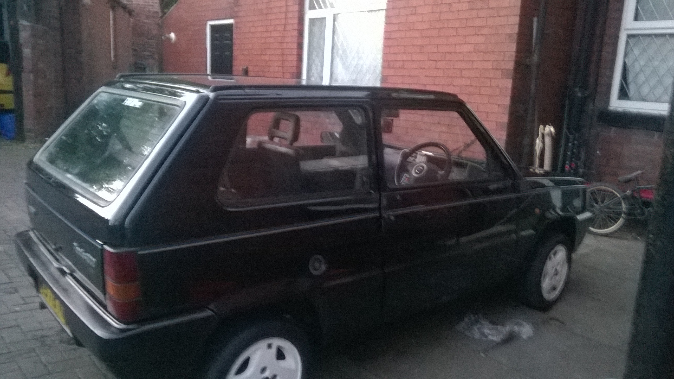

The panda as got a new name, (puntanda):D

just got, a few lights to sort, (rear brake light iffy)
wing mirror,
replace brake pads/discs -make up new brakepipes and replace,
oil change/filters plugs /leads, send wheel in to be repaired..
its been easy to work with, :)
