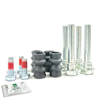

The back brake calipers seize up or the hand brake lever seal starts leaking. Special tools are needed to get the circlips out. New callipers are not expensive -
You might no need these -
Pads and discs if needed
