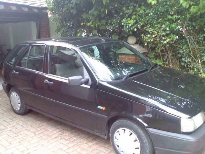

hey guys im new to this my fist car is a black fiat tipo 1.4 :)
does anyone know the offset on the tipo so i could stick alloys on it ?

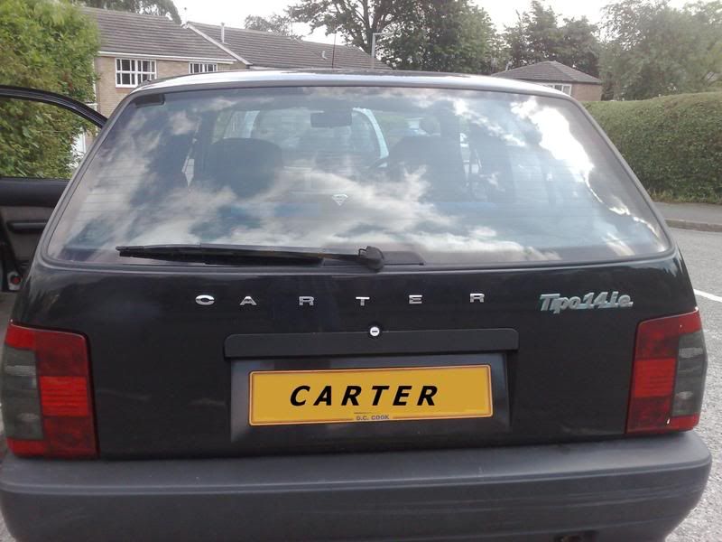

Hi, looks nice apart from the wonky letters on the tailgate!

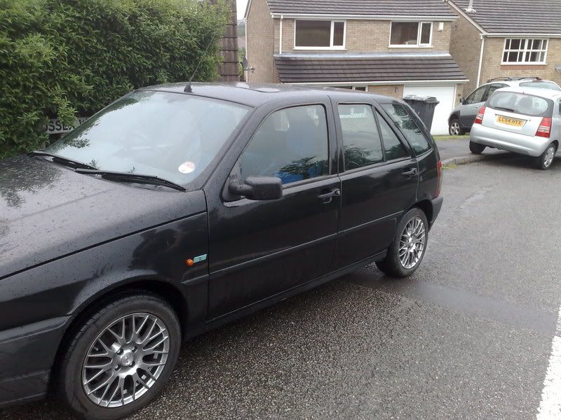

Don't have the offset for you, but basically any newish 14" Fiat wheels (or 15" if you want) should fit - you need the 4x98 bolt PCD. So wheels from Tipo/Tempra (obviously), Punto, Brava/Bravo, Marea. No point in going wider than a 185 tyre (185/60 x 14, 185/55 x 15). Should be plenty to choose from.
