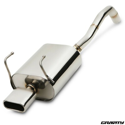

500 and Panda use (near enough) the same exhaust system. This one from eBay looks interesting
And this is stainless
