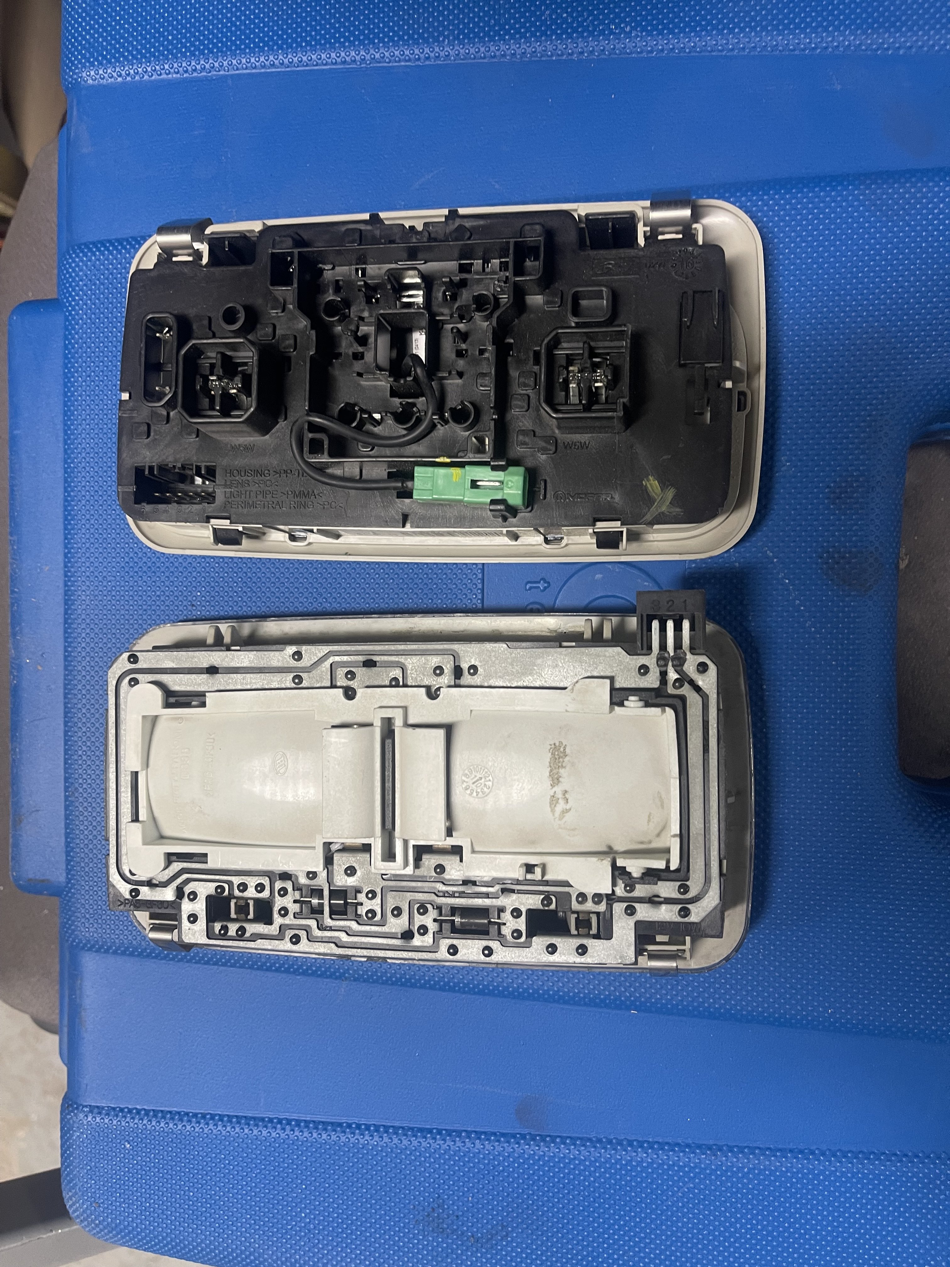

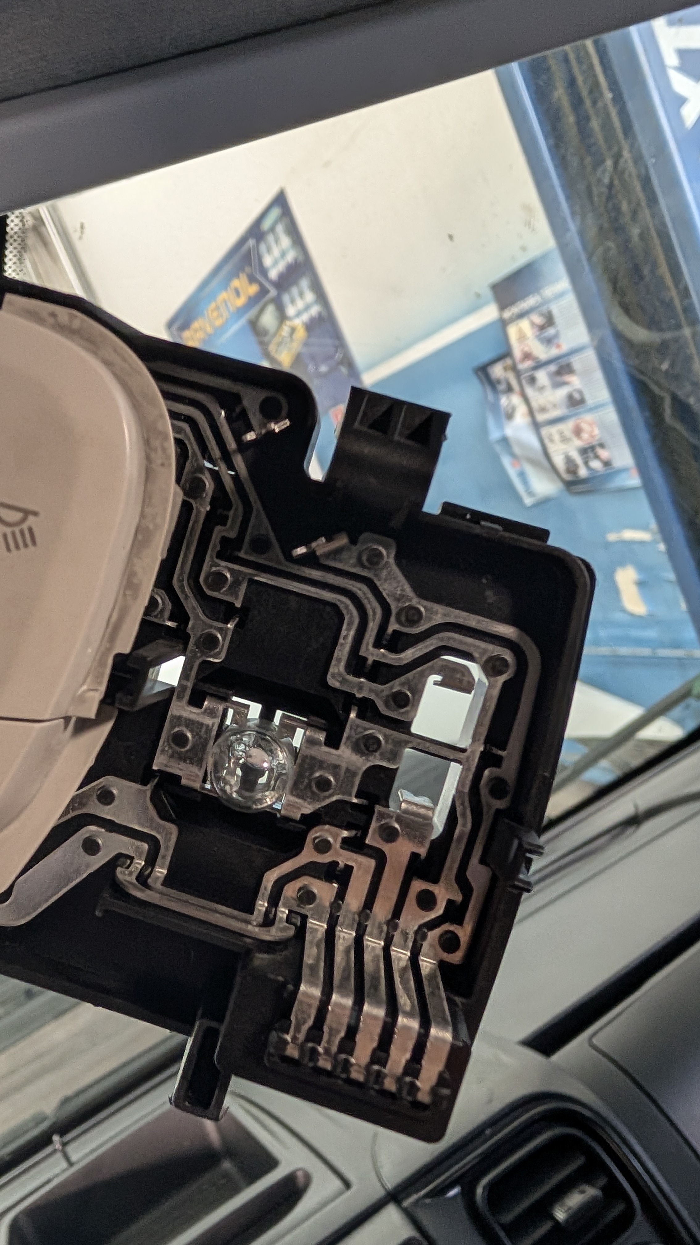

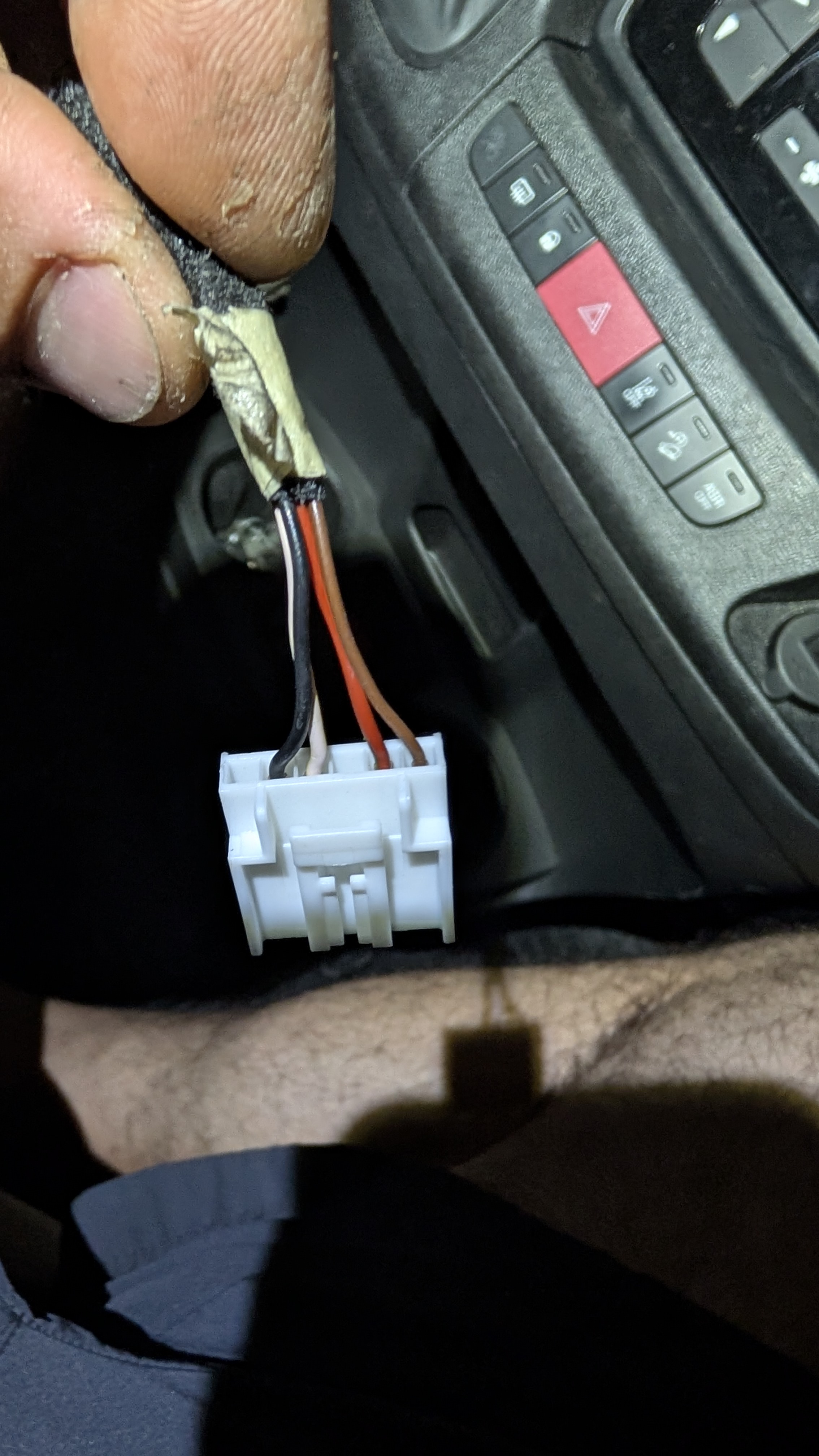

Old one 735529538 has 3 pin connector 3 wires

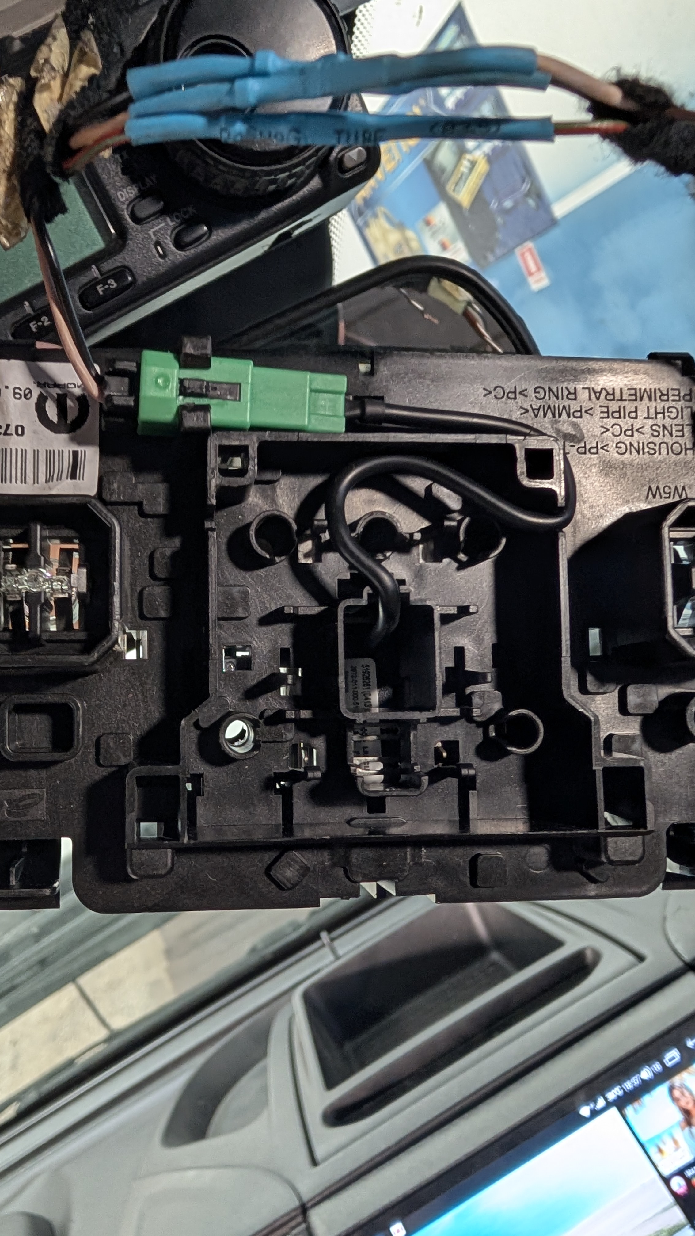

New one 00532961830 has 6 pin connector 4 wires.
Has anyone fitted the new one? Any wiring diagrams to compare the new with the old? What is the extra wire for?

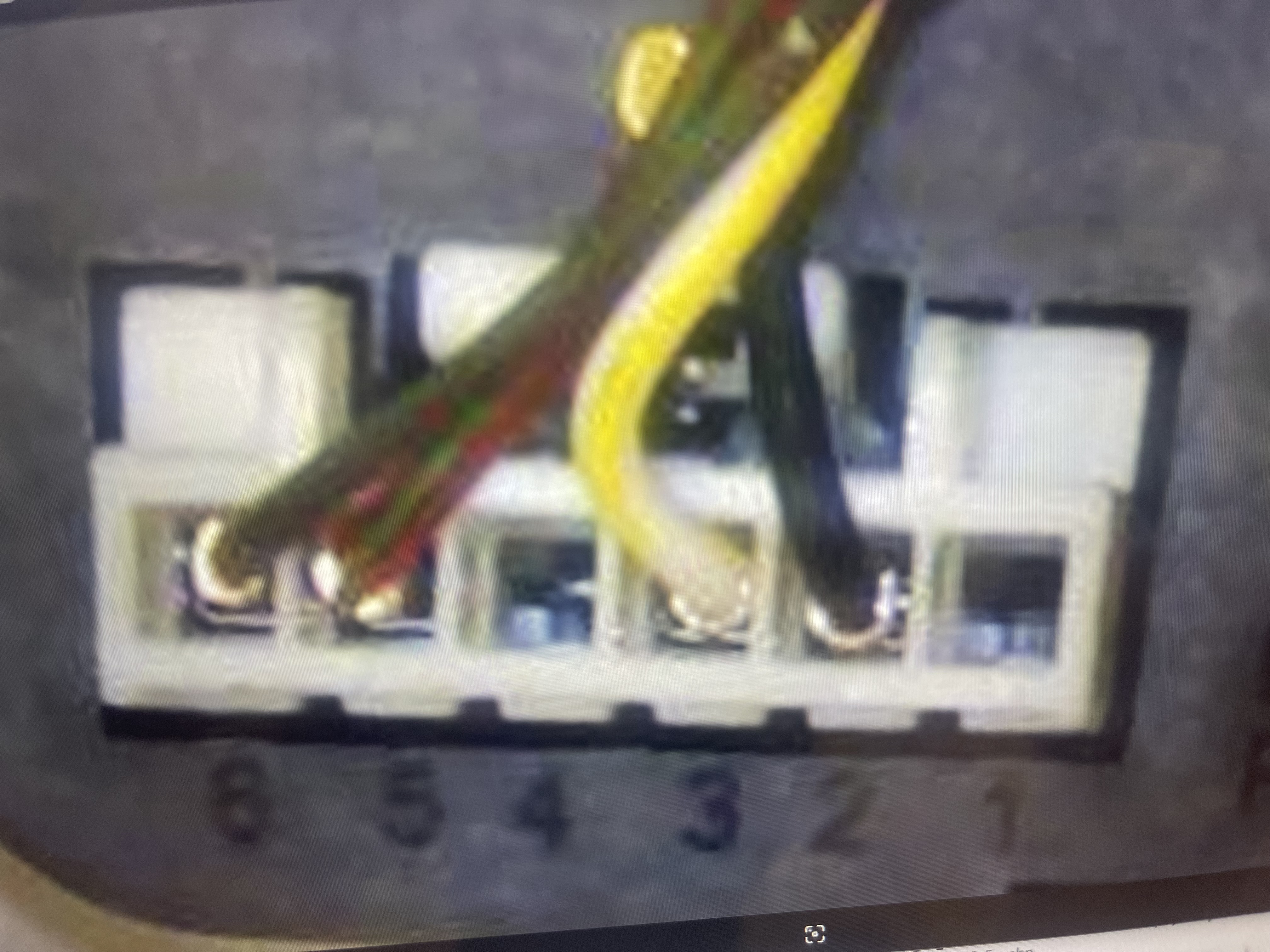

old one has wires on pins 1 2 3
new one has wires on pins 2 3 5 6

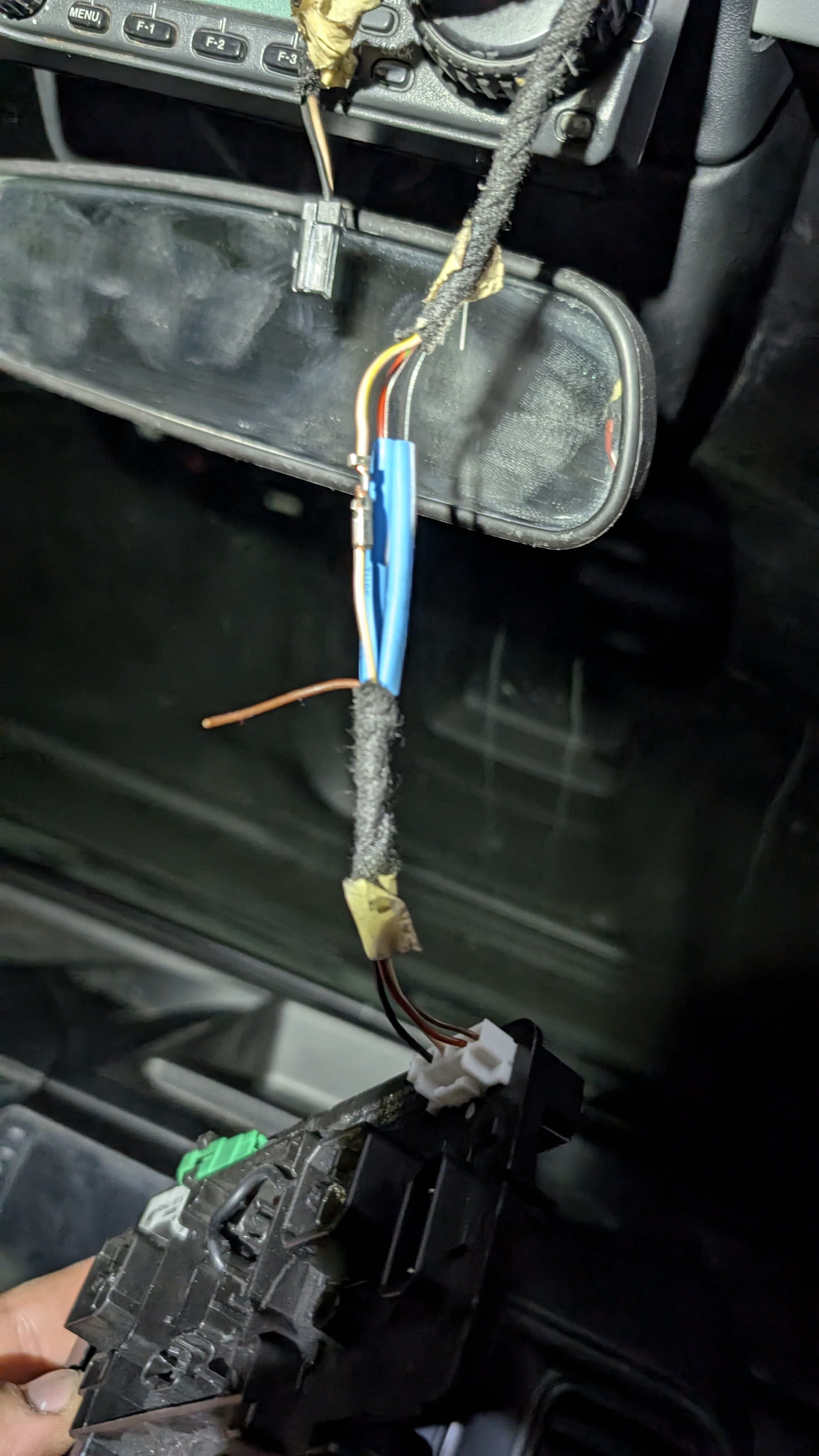

My guess is that
Old pin1 goes to new pin2 (black wire)
Old pin2 goes to new pin5 (red green wire)
Old pin3 goes to new pin3 (beige yellow wire)
New pin3 wire???? (green? wire)

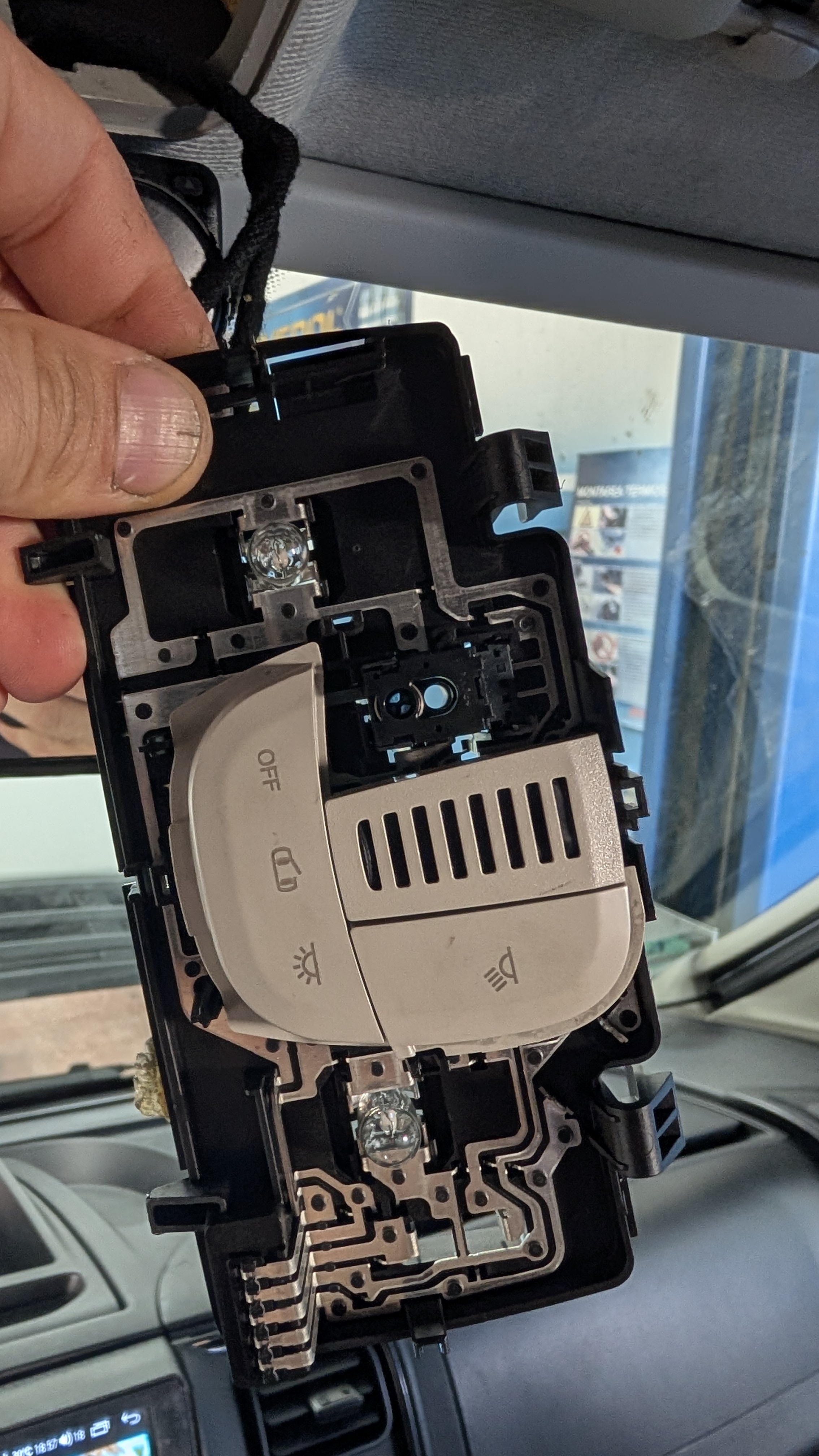

The one on the bottom of the first photo is a standard x250 interior cab light I assume. It's the one I have in my 2011 built chassis. Is it the 'old' one, or the 'new' one?
The three wires are I assume positive, negative and a signal that one of the door is open OR a positive feed when the door is open. Black being the ground.

I forgot to tell you top is the new one and bottom the old one
Any description and diagrams about the new one to compare with the old one?
Where does new pin3 green wire goes to?
Any insight from somebody that has the new light?
