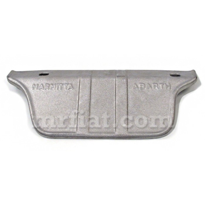

My car came with one of these Abarth heat shields. I’m not sure where and how it attaches. I assume it’s above the exhaust on the right side?
Should I even bother with installing it?

Yes, definitely; it says "Abarth" :D
It helps to keep the ignition coil less hot and gives some protection to the wires above.. ;)
Any ideas how it gets attached? Any photos?

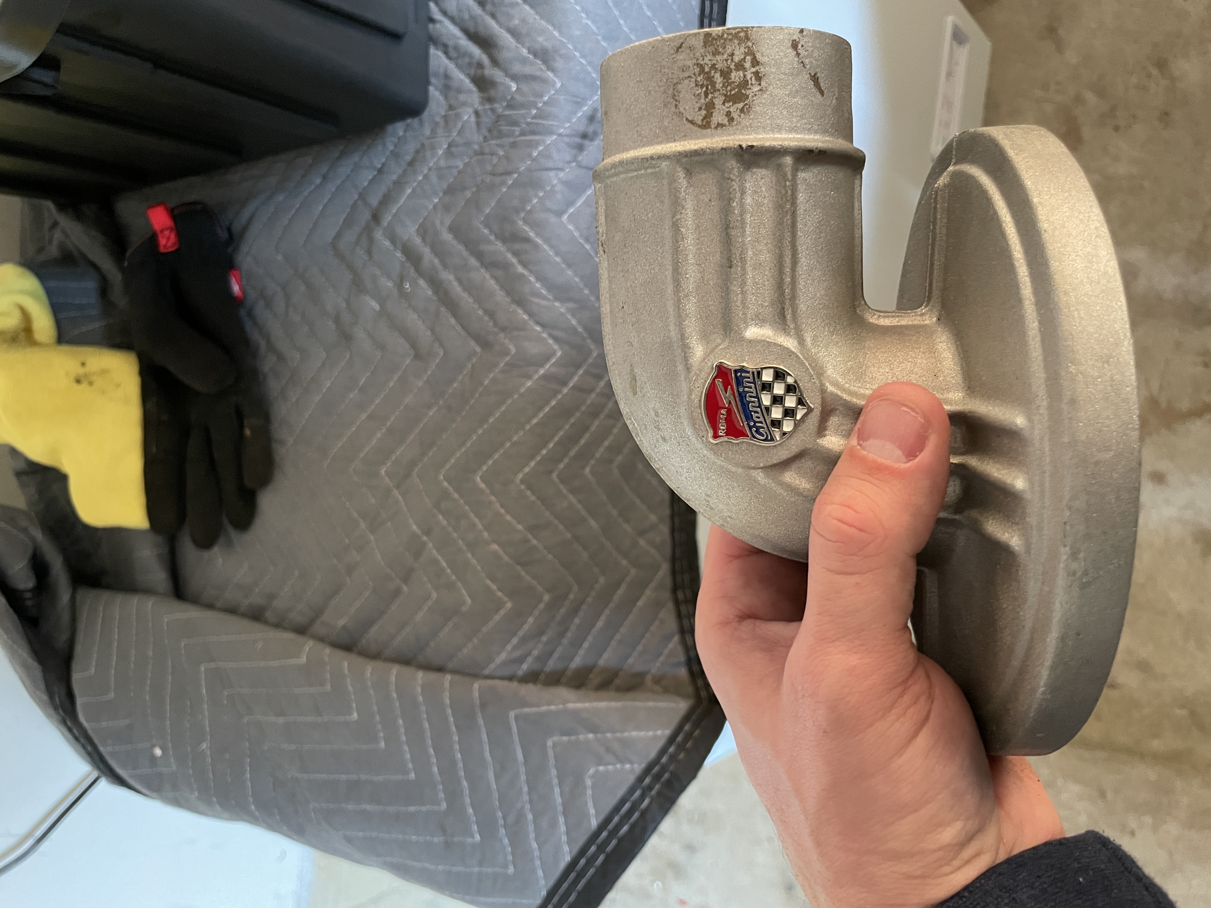

The car also came with a Giannini intake cover (no clue what pipe to use or if it’s worth the effort)

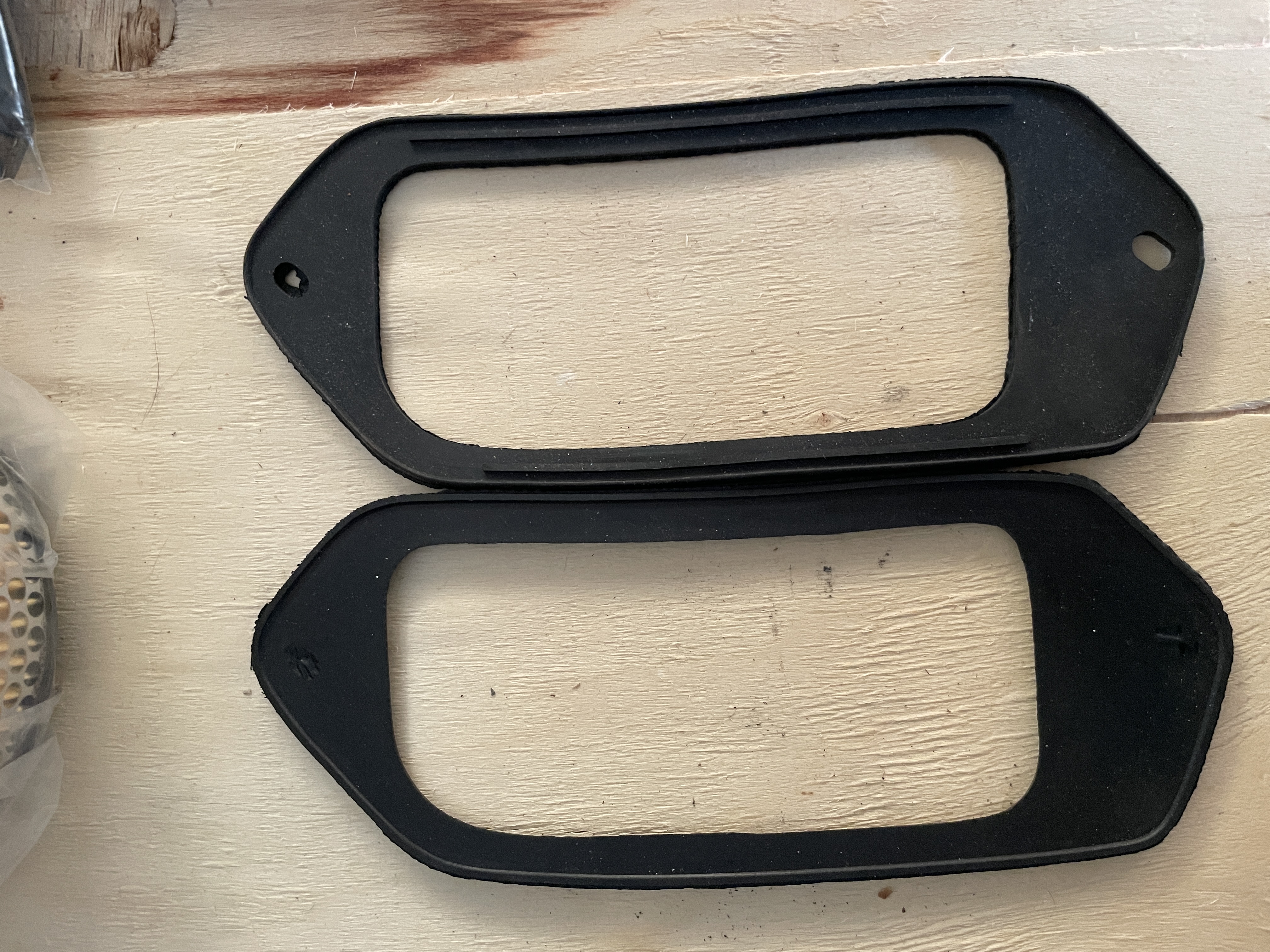

Any thoughts on what these two gaskets could be?

The gaskets look like rear light unit gaskets. The air-filter cover fits (I think) in place of the normal Fiat tin version. Giannini was a contemporary of Abarth, and very good they were too at tuning the 500, and later, the 126 models Giannini still exist as a company, and as they never received any financial assistance from Fiat, cannot be touched by Fiat in their drive to attack the 'pattern' part makers for Abarth (as well as Alfa and Lancia). Lots of Giannini replicas in Italy. Look them up on 'U-Tube'

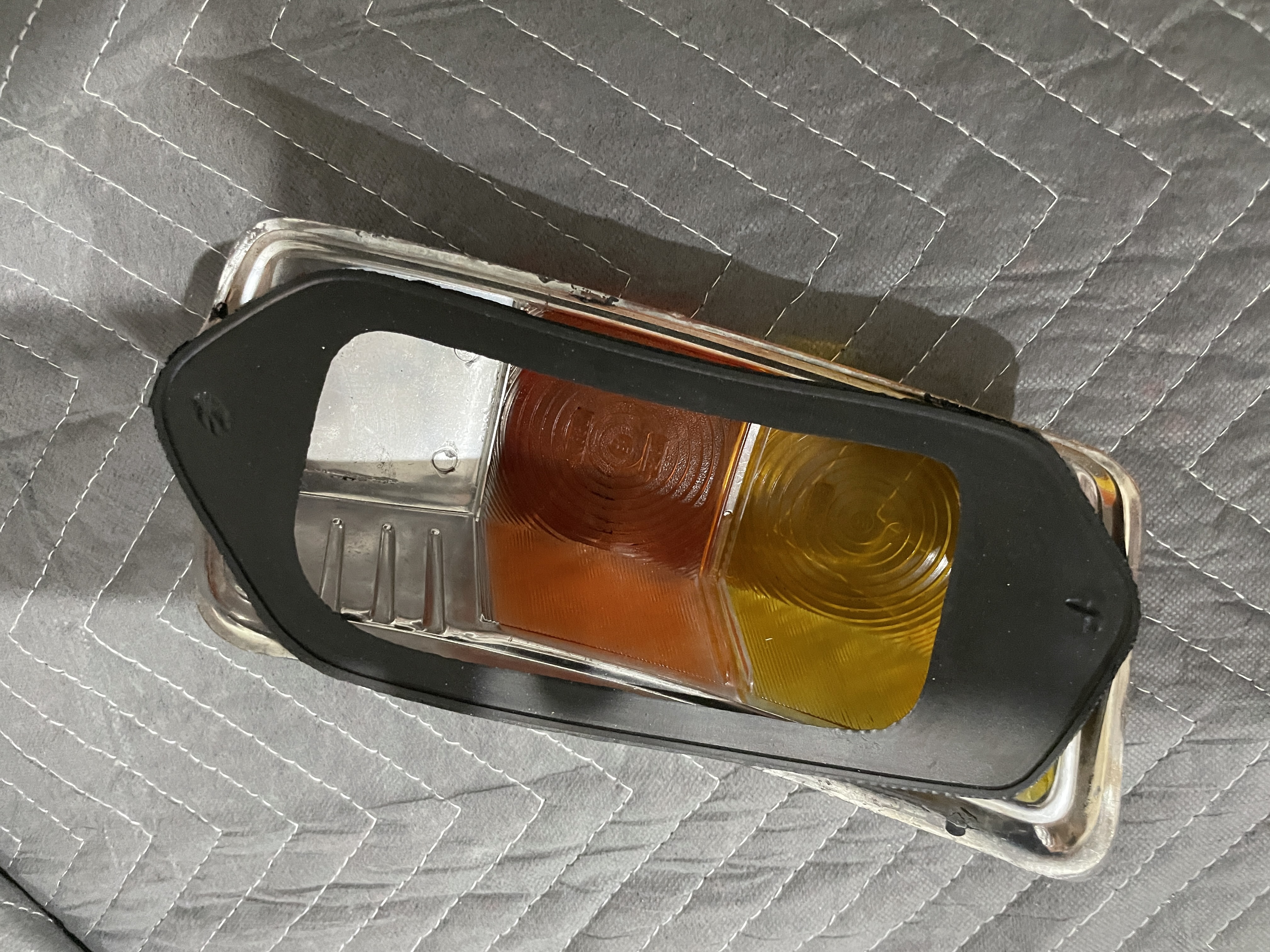

Thanks Thomas! I thought they may be rear light gaskets but they don’t match up. Maybe it’s for another year?
