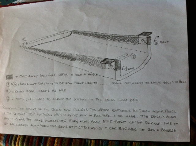

Hi Tim
The console is sitting on the tunnel, to which I have secured the console at the bottom using a bracket that screws to the bottom of the console and down the sides of the tunnel. I covered this bracket with the tunnel carpet so only the self tappers show, which when painted black vanish. Note the photograph shows the console positioning. It slightly overlaps the clutch pedal but does not interfere with it at all or with its operation. As far as fit goes, I have attached a drawing of the glove box and how to cut it down to reduce its height, thereby allowing for a good fit whilst retaining a thinner aperture glove box. The console upper fixing is through the glove box bottom and the glove box original mounting points remain the same, all be it reworked at the front fixings as per the drawing. The glove box is the original in compressed cardboard, it would be more difficult to try this with a later plastic glovebox. The overall fit up does not restrict anywhere and with my svelte self, there are not issues with driving or comfort at all. Other than for a big bloke the normal scenario. All in it is a decent addition, not one for the purist granted, but I'm not a purist, more of a stylist ha ha. :cool:
The rear shelf comes from Ricambio and Van Der Laan, same sort of price. It is already badged and has the speaker cut outs already done. 4" speakers with about 1 5/8" depth fit. I chose Kenwoods for the size and then wattage which is 220 W combined, plenty to beat the engine noise.
Cheers
Hugh Jarce

Hi Hugh or should I say Gary.
Thanks for the consul and speaker info. Also cutting down the glove shelf is helpful too. Mine's an original cardboard type.
I didn't want to appear critical when questioning the space, sorry if it seemed that way. Being in graphic design, I'm more for style and looks too and your interior looks great, plus added practicality of the consul.
