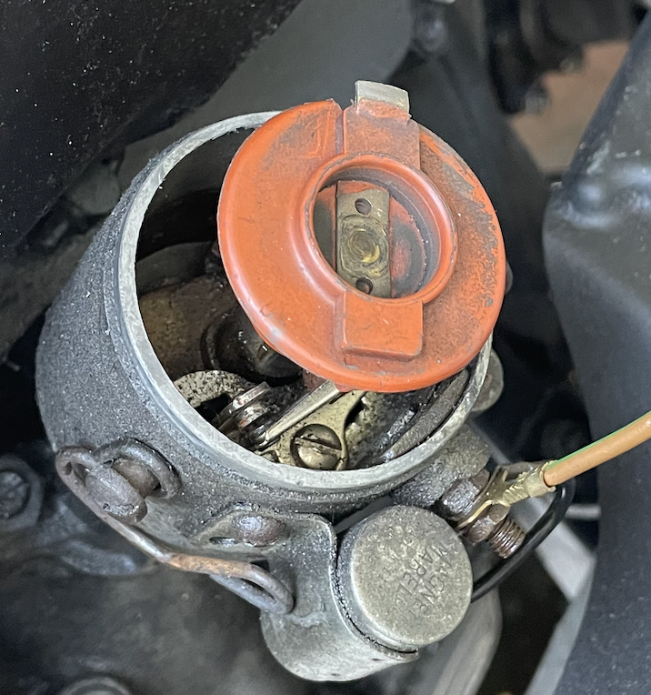

Hello everyone,
I recently upgraded to a 28IMB, have new bakelite spacer, new gaskets, new fuel pump. I'm struggling to get her started properly without cranking for a while with the choke on. Even with the choke, it doesn't always start properly at first. Tends to lower revs and stop.
I was reading other members similar issues, and it seemed to point towards incorrect gap in the breaker points of the ignition. So today I tried setting them to 0,50, moved the pulley until the gap was at it's furthest, measured and then set the gap. Nothing changed.
I replaced the points with a new set I had, and that too didn't change a thing. I have a new condenser to install but I don't think that will make a difference...
I've uploaded some pics, maybe you guys can see if something is wrong? Could the rotor arm be worn out?
Thank you for your help

Looking at the photos , you could "drive a bus" through that points gap ;).
Regarding condensors in my experience they will give you an uneven misfire, but a good clue is to look at the set of points it has been running on , if the contact area is blue and pitted then replace the condensor and points as the condensor is there to prevent arcing at the points as well as giving a quick collapse of the current at the coil to give a good spark.
Another thought if someone has been too enthusiastic cleaning the rotor tip they can increase the gap to the distributor contacts making it hard to start. If you don't have a new one to compare try resting the rotor in it's correct position and see if there is too much of a gap to the contacts in the cap. We never used to file or sand them, just rub against the side wall of a tyre to clean them.
A common reason for condensor failure is leaving the ignition on without the engine running whilst working on it causing it to overheat along with the points and coil.
Thanks for the explanations. The engine is not an original 110 engine. It has a 126 head, and I don't know about the internals. The stamping show 110, but who knows if that's original...
With that said, would the 0,50 gap i adjusted to (manual says between 0,47 e 0,53 mm) be wrong if it's not a true 500 engine or distributor? I was under the impression the 126 and 500 had the same gap spec.
Am I correct in adjusting the points when they are at the biggest opening point (or when the lobe around the center of the distributor) pushes them open?
I will look at the original points and see if there's any blue or pitting. How would I check if there's too much gap in the cap? I'm not sure what you mean by resting the motor. Sorry
I'll be changing the condenser just to be safe and report back.

I am not a Fiat specialist, just retired after 50 years in motor trade, gap looked wide to me visually more like 50 thousands of an inch than .5mm (some say .37 to .43mm in metric, generally around 15 thousands of an inch in imperial terms works for me and as you say when the lobe of the cam is pushing the points open the most.
By the way it was "resting the rotor" as in turning the distributor cap up facing you and positioning the rotor arm as centrally as possible so the carbon contact in the middle of the cap is directly over the normal contact area on the rotor arm to see if the gap between the end of the rotor arm and the terminal in the cap that goes to the plug lead is excessive as if someone has sanded or filed the rotor to clean it. It is only a rough guide , if you have another rotor arm you can match together to see if one has been sanded away.
Regarding the points, if working correctly the contact area will be a smooth grey surface on both parts.
Incidentally has the ignition timing been checked correctly also as that could be part of the problem too.
I tend to over explain as it's always difficult if you are not standing beside the engine listening to it etc.;)
