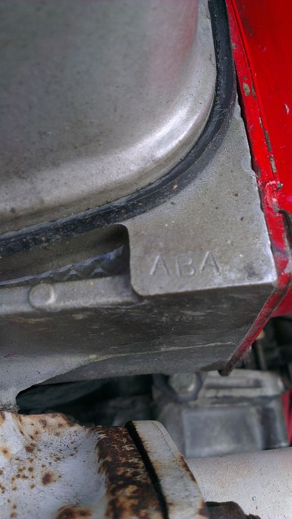

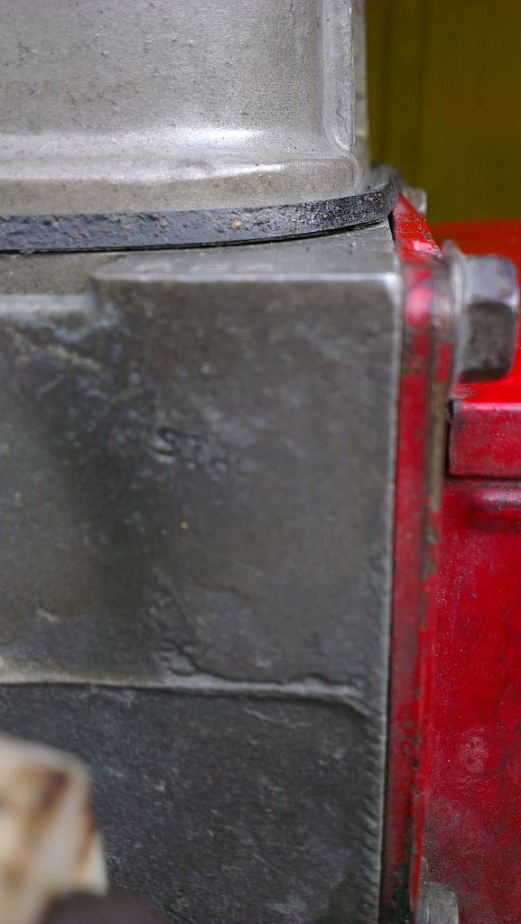

Notice the "ABA" on the head, any ideas?? I can also see what seems like a STa on the side aswell.
Any clues???

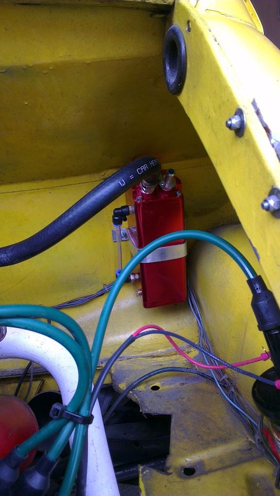

I did find that the breather on the rocker has a bit of pressure in it. The previous owner had added a oil catch and this was nearly full. Is this normal? I am putting another one myself, something a bit prettier than a washer bottle. However I am bit concerned as how much pressure there is but it doesn't seem to do anything to the engines performance.
Any advice on this would be appreciated
Bit puzzled by this - can you clarify please?
Oil catch...... ??
Photos might help! (y)
Thanks Dave,
I've tried removing the dip stick to see if it made any difference but doesn't seem to have. I think I'll get it on the road and run it a bit before contemplating an engine strip down. The oil level does look a bit high so will replace that and get it to the right level.

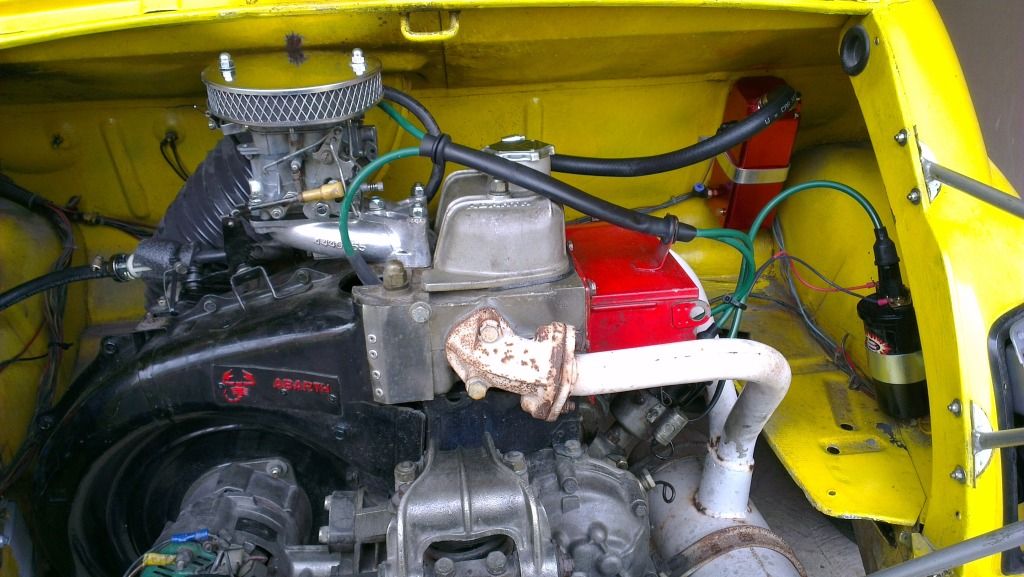

Here are a couple of pics of the revamped engine
Actually that the new one I fitted :) so I would hope it looks cleaner :).
I had a couple left over from when I tuned my Harleys ( funny that being 2 cylinder air cooled too) . Ordered the oil additive on ebay so will have that put in next week. Car is nearly ready for MOT and registration. Engine is really sweet very happy with it.

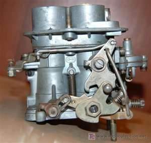

Hi Chris , was just looking at this thread again and noticed you posted a pic of an engine with a carb identified as a weber 30 dic (purple car). I was just wondering if it might actually be a weber 30 DGF instead (see attached jpg of 30 dgf and 30 dic for comparison). These seem to be the carbs that came with the panda 30 head as standard and seem very similar to the 30 dic. I was wondering what the differences were between this and the 30 dic and if anybody knows which was the better carb.

Colm,
You may be right - well spotted.
Both are progressive opening, twin thoat, down draft units but differ in the construction details. I think the DIC was mainly used on the Fiat 850s (817 - 903cc, 4 cylinder) and the DFG on the smaller Panda 30 (652cc, 2 cylinder) engines though I'm not absolutely sure. I've definitely seen 30DICs on Panda headed engines, so as long as the jetting is OK, I guess you can use either.

The Weber 30 DFG was also fitted to the water cooled , 2 cylinder , 704 ccs Fiat 126 Bis :)
