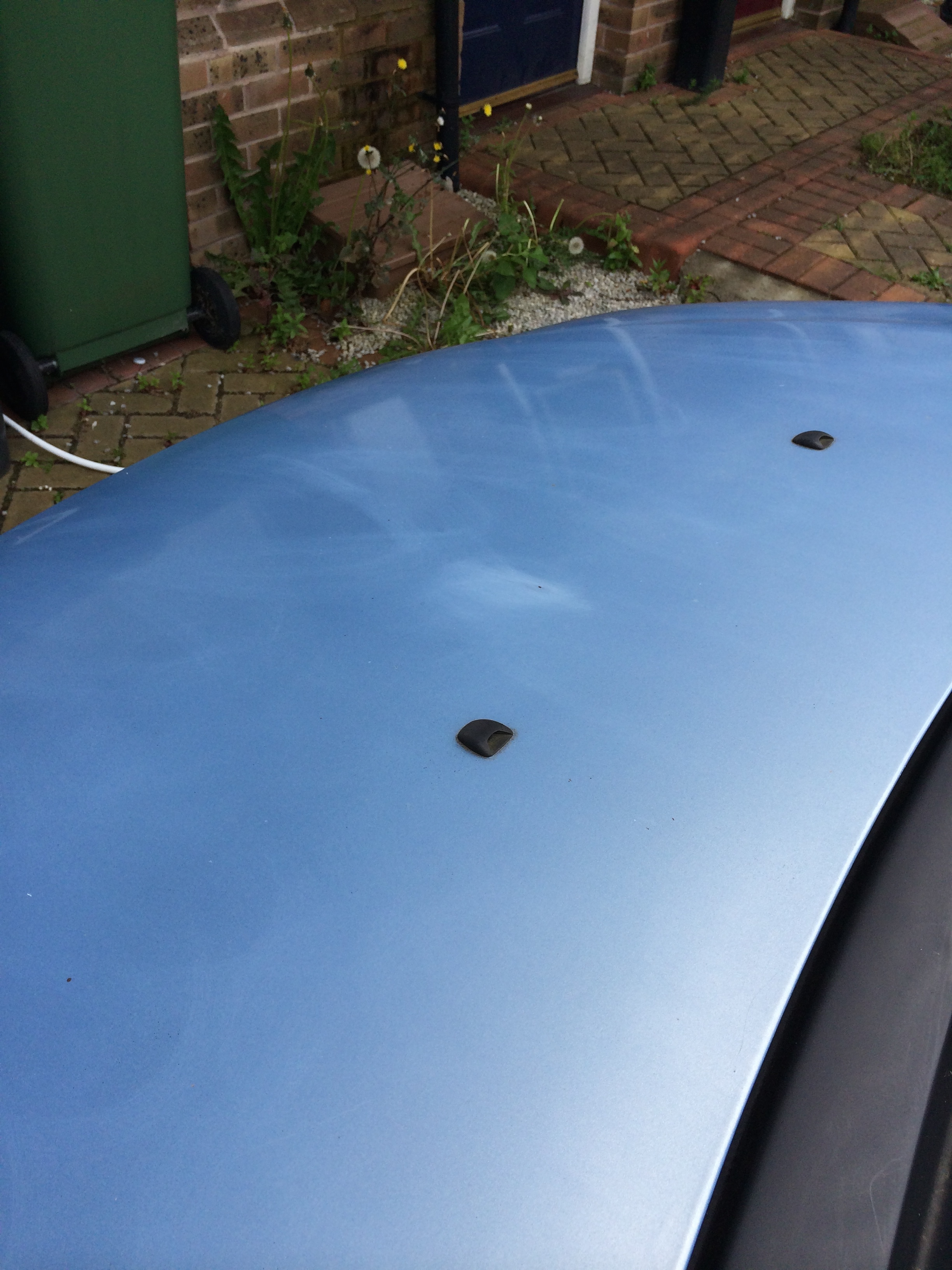

Ok, i've been a complete ****. Because my car was so filthy, the dirt seemed to have binded with the paint, I decided it would be a good idea to use a sponge with scouring material on it to scrub off the dirt...
Low and behold, I thought i was a genius, the car was clean - the cleanest ive ever seen it before. I was happy... until it dried and I noticed that the paint work underneath and has been scuffed and scratched (lots of tiny little scratches).
I'm in the process of buying some touch up paint, but could somebody point me in the right direction? What paint/method is best for this situation? I'm finding out the colour code of the car tonight and would like to get this sorted asap because there is a big scuff on the bonnet and it looks terrible.
Any help is appreciated.
Its a fiat punto mk3 by the way.

It will need polishing to remove the scratches.

So no paint is needed? The scratches aren't deep they have just made it look scruffy.
Can you provide me a link to a decent car polish please?

it depends on how well you did the "job" :eek:
You wont be the first and you wont be the last to do this but we will TUT loudly in your general direction TUT TUT.... :p
As dom said get some pictures up ... How much of the car did you attack in this dirt busting spree?
if its only a few small areas you should be able to shift all but the worst marks by hand.... using a couple of polishes and a few "german applicator" pads
if its all over your either going to have to grow some arms the size of popeye or get involved in the machine polishing world just be aware there are many who will do more harm than good....

once you find your shifting them use the harsher compound then work down the level of abbrasiveness till the shine comes back,,, but its going to take a lot of rubbing if you have large areas to do
work in 30cm square areas no more and rub like mad.... till the polish goes clear...

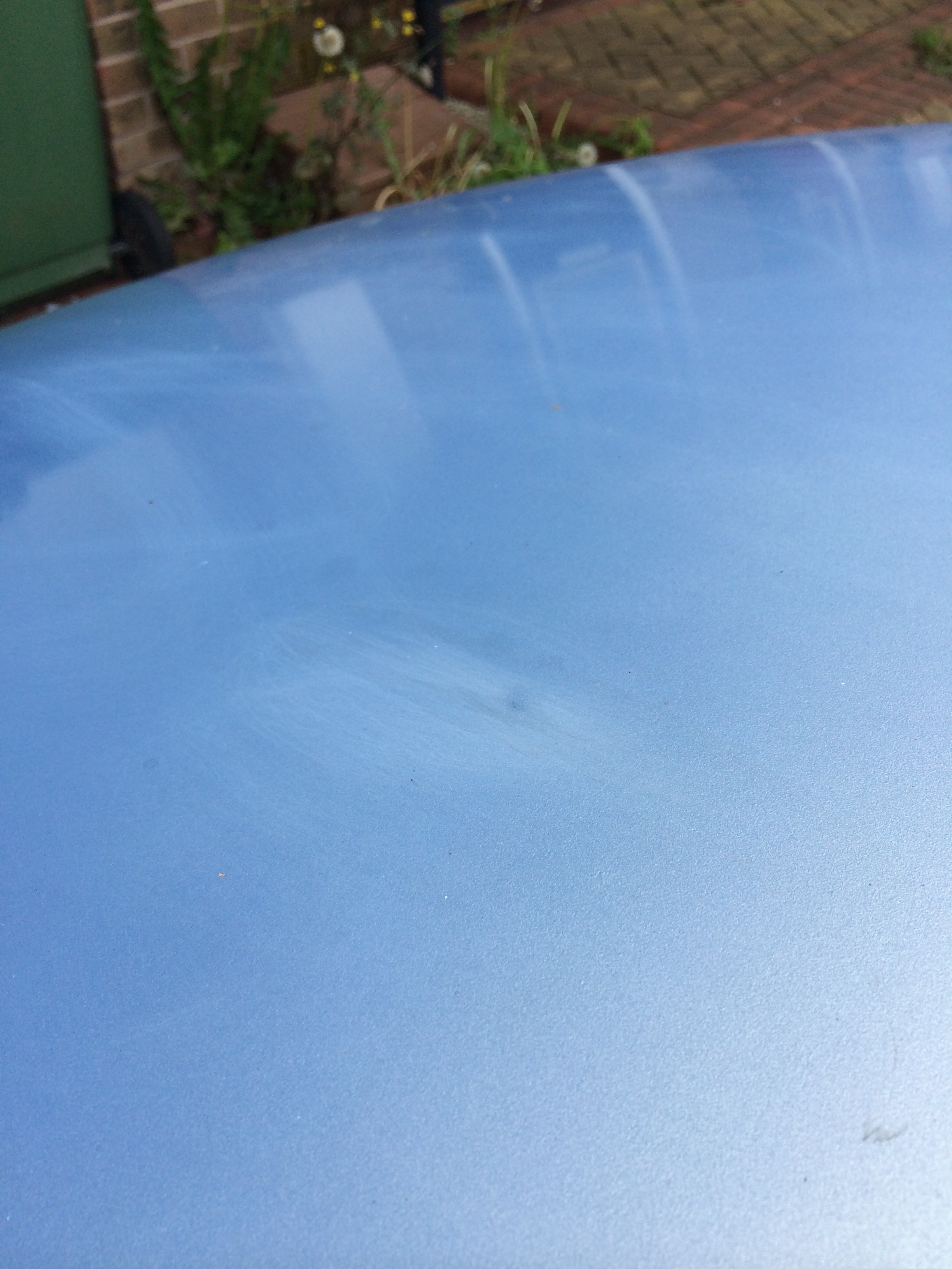

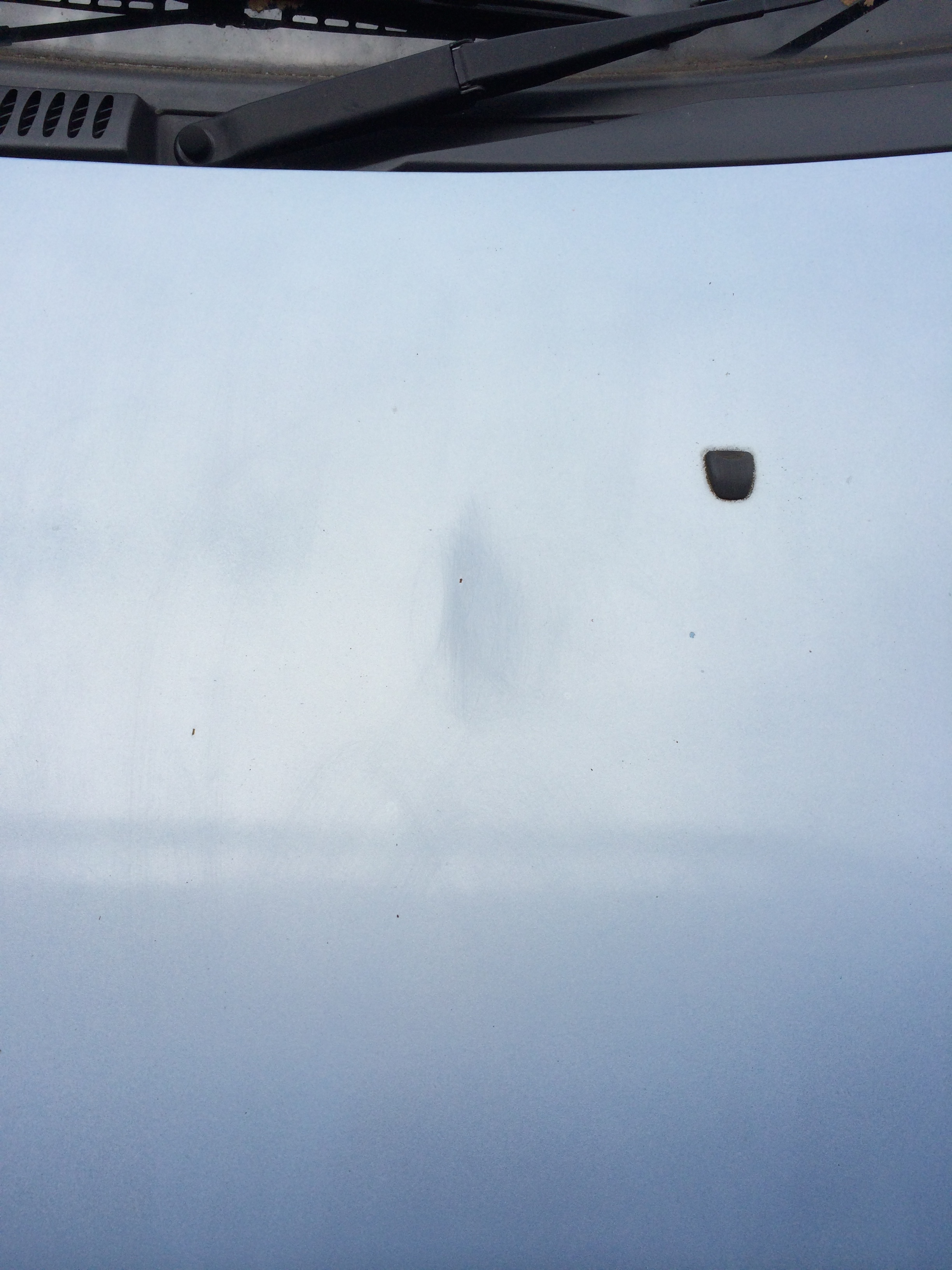

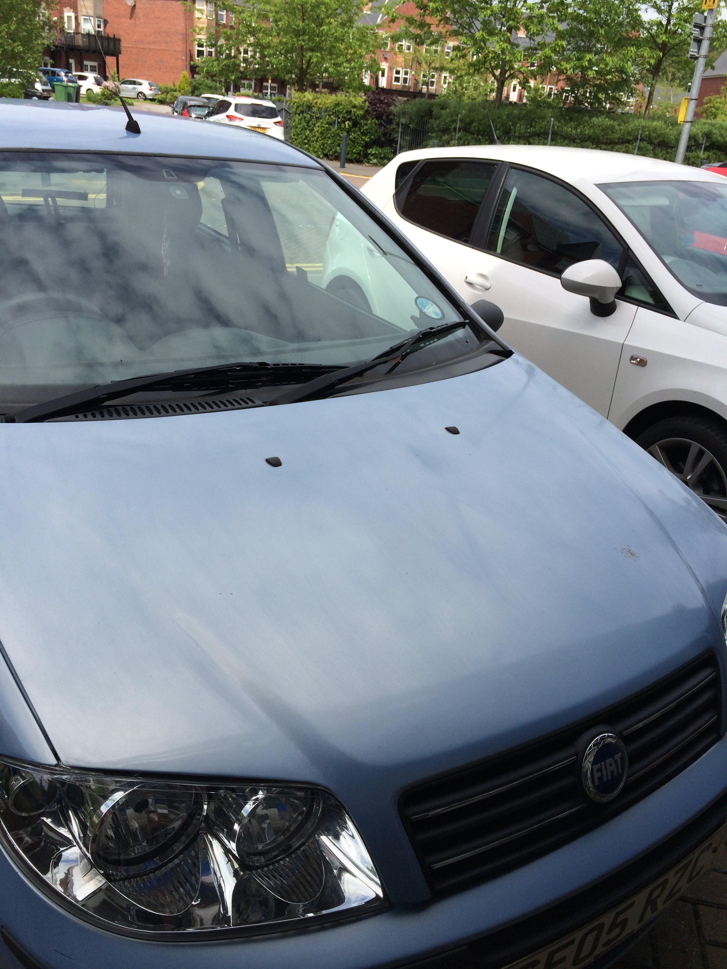

Apologies for taking a while here are some pics. Its only the bonnet that needs doing (thank god).
Pics attached, let me know which applicator you guys think is best, I have a week off work now so hoping to have it sorted by end of week!

you should have a fighting chance of removing some of that but its going to be hard by hand so be prepared for sore arms...
