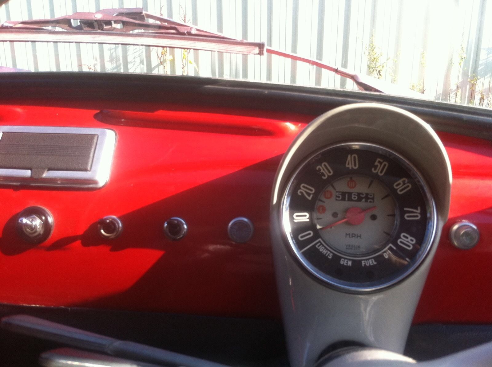

Hi everyone,
I've just got myself a '72 500 (But still haven't collected it yet!)
Last owner had the car for 25 years. I may be making myself look like a complete plonker here but can you get a rhd 500L with a round speedo??? It has carpets, plain door cards with no pockets. 'Ribbed' stitched seats if that's the correct term.
I don't think it's had anything major done to it in 25 years of ownership.
I realise that lots of these cars have been changed, modified, altered being the proverbial Meccano set. If anyone could chip in and point me in the right direction it would be much appreciated!
No...you've got an "F" I think.:) That's a nice find. The speedo, steering-wheel, door handles and cards are correct.
It's likely the seats, carpet and centre tray around the gear-lever are later fitments from an "L"
It sounds like a good car.(y)
Please keep posting more news and images of your car.
As Peter said it's a F.
In 1972 there was a bit of a crossover period when the L was first sold, so an F with a round speedo was still available. I assume it has the winged badge?
In the picture the ignition switch in the centre of the dashboard looks like a toggle switch, where's the ignition switch? On the column?
Oh and the door handle is at the wrong angle but that's part of the whole new world of classic 500's on this forum.:D

I agree with Peter and Tony--it is a 500f with 'L' (Lusso) parts. All the 500s, with the exception of the 'L' had round speedos---the 'L' had a unique-to-it square instrument cluster, complete with fuel GAUGE. I have a 'L' and the door-lock release pulls are at the bottom-front corner of the doors and are pulled OUT, not over. Also, just to baffle people, as Tony pointed out--the 'F' and the 'L' were both available at the same time---a case of 'yer pays yer money and makes yer choice' I am willing to be corrected on this, but I think that your car is old enough to be allowed to fit 'black 'n silver' number plates. Where about do you live ?--always nice to know where Forum members are.

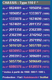

Thomas, if your car is 1965-66 then it was not made as an "L." As Tom pointed out the L did not come out until 1968.
I have seen L's made into F's. Other than the instrument cluster, it is not hard to put the exterior and interior L parts on an F.
Attached is an accurate chassis number to year guide found here: http://nuova500.free.fr/pagine/fiche500f.html

It looks like I have the very rare 500F/L prototype then! :ROFLMAO:
..... so I can add a checkered sunroof and nudge bars without spoiling the cars originality!

My s/n is 110F104XXXX as per table is an L but how can explain the square cluster which looks factory installation and not a modification? All holes on the dash are perfectly cut so i doubt that it is a modification. If i have a special extremely rare model i am asking 80.000 euros for anyone interested:yuck:
