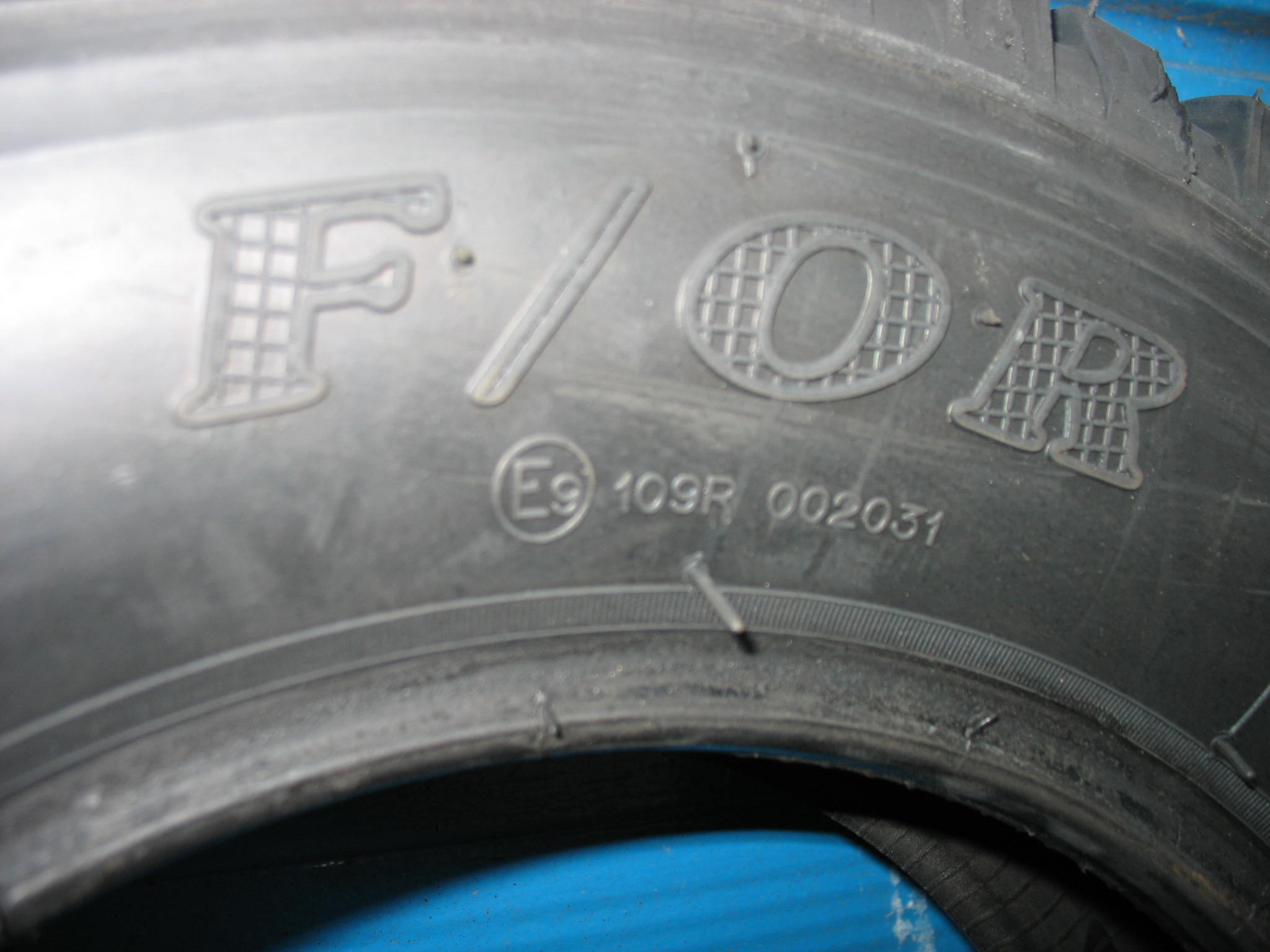

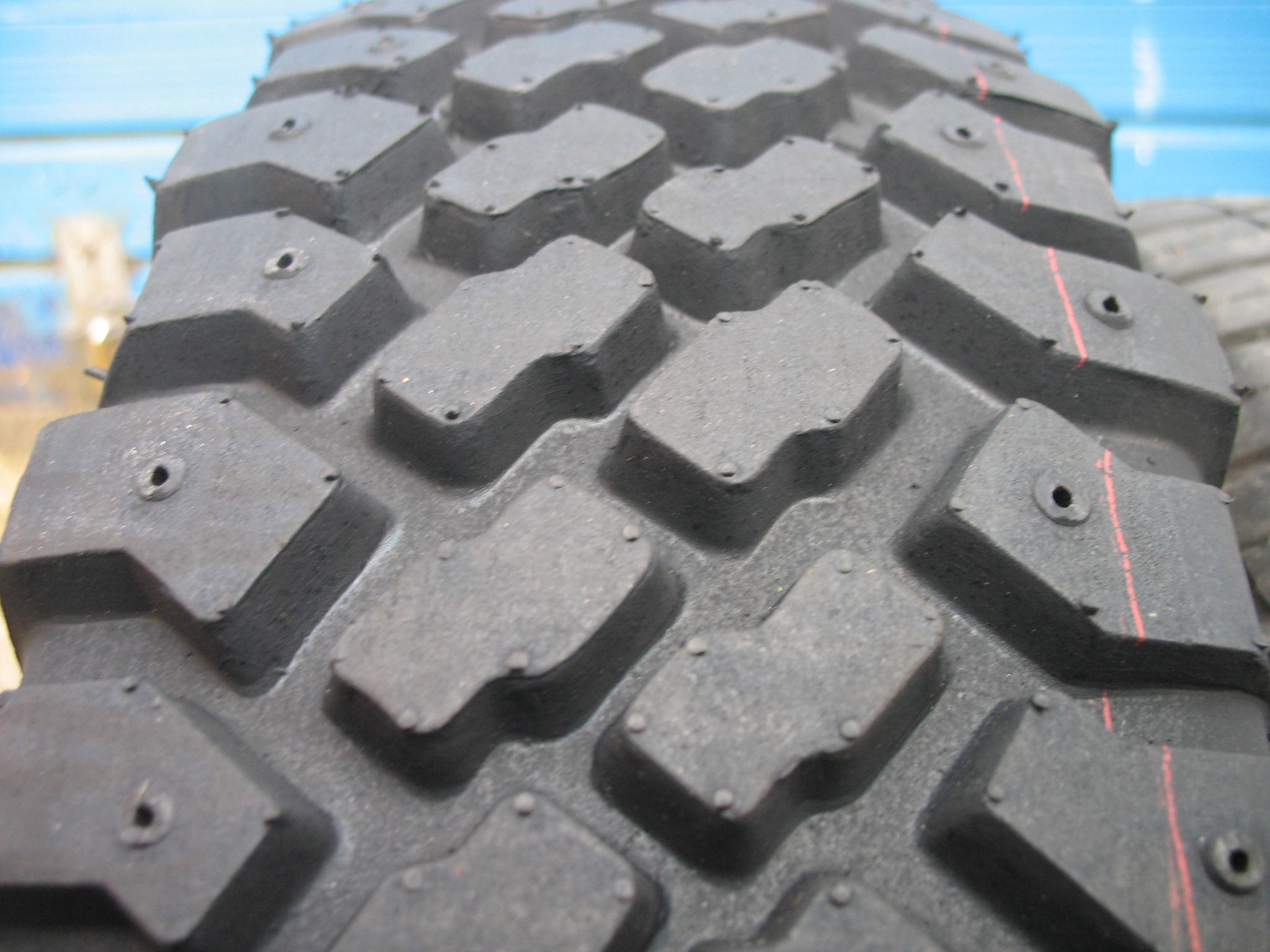

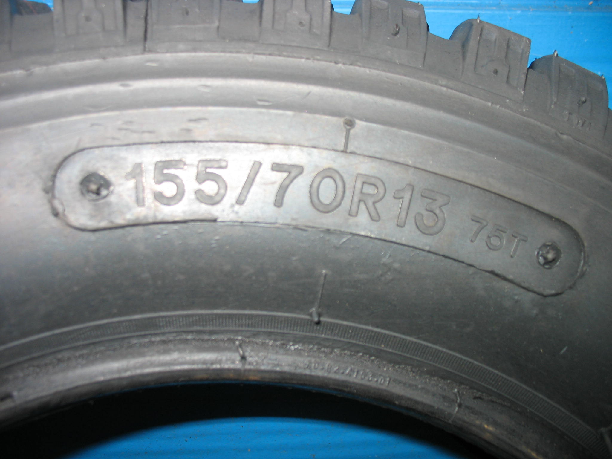

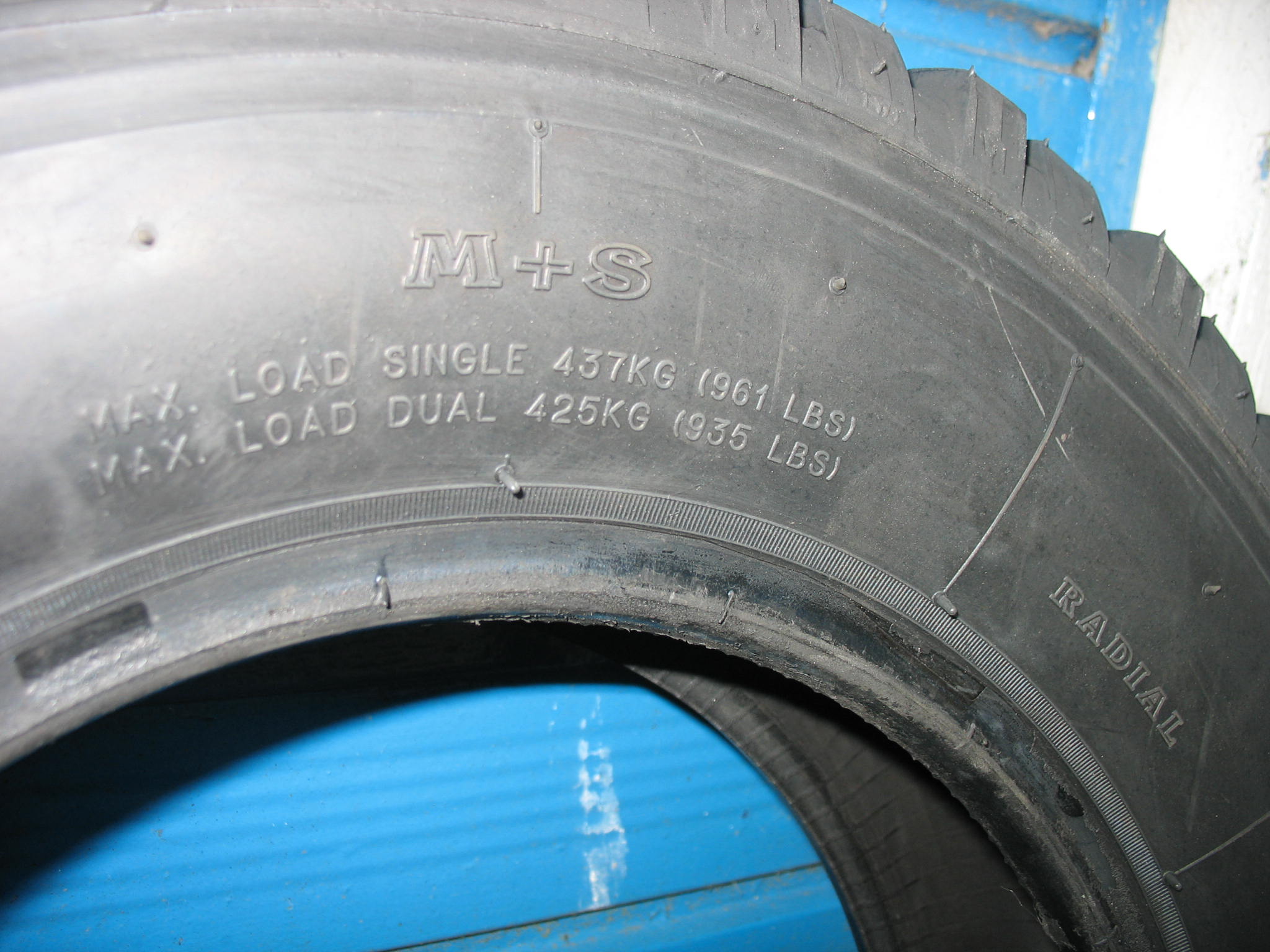

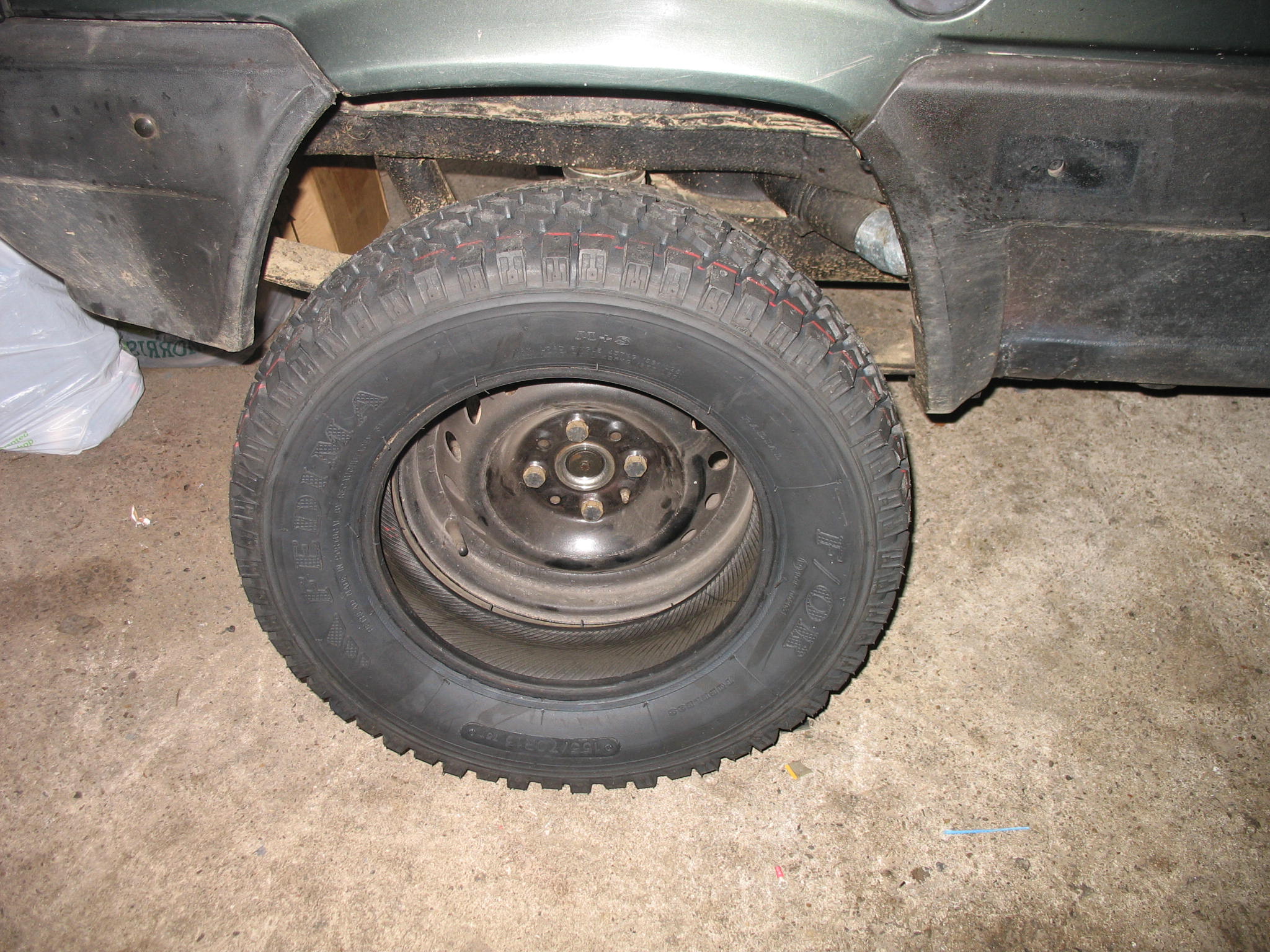

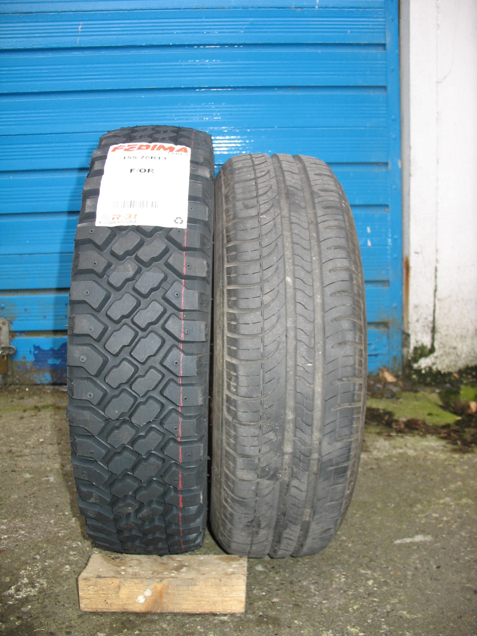

As there was some interest from number of members with more road friendly but still offroad capable tyre for panda here are Fedima's F/OR 155/70R13 which will be fitted to my sisley.
565mm OD, thread width 140mm
Fedima F/OR 155/70R13 vs road tyre 155/70R13
Thread dept; 9.5mm
Nice to know that they are only few weeks old
No punctures repairs
Light fift might be required
they are retreaded tyres, they may be older than coal:D .
Being serious now ,they look good ! similar but less agressive than "pneus ovada" from Italy my friend has on his 4x4

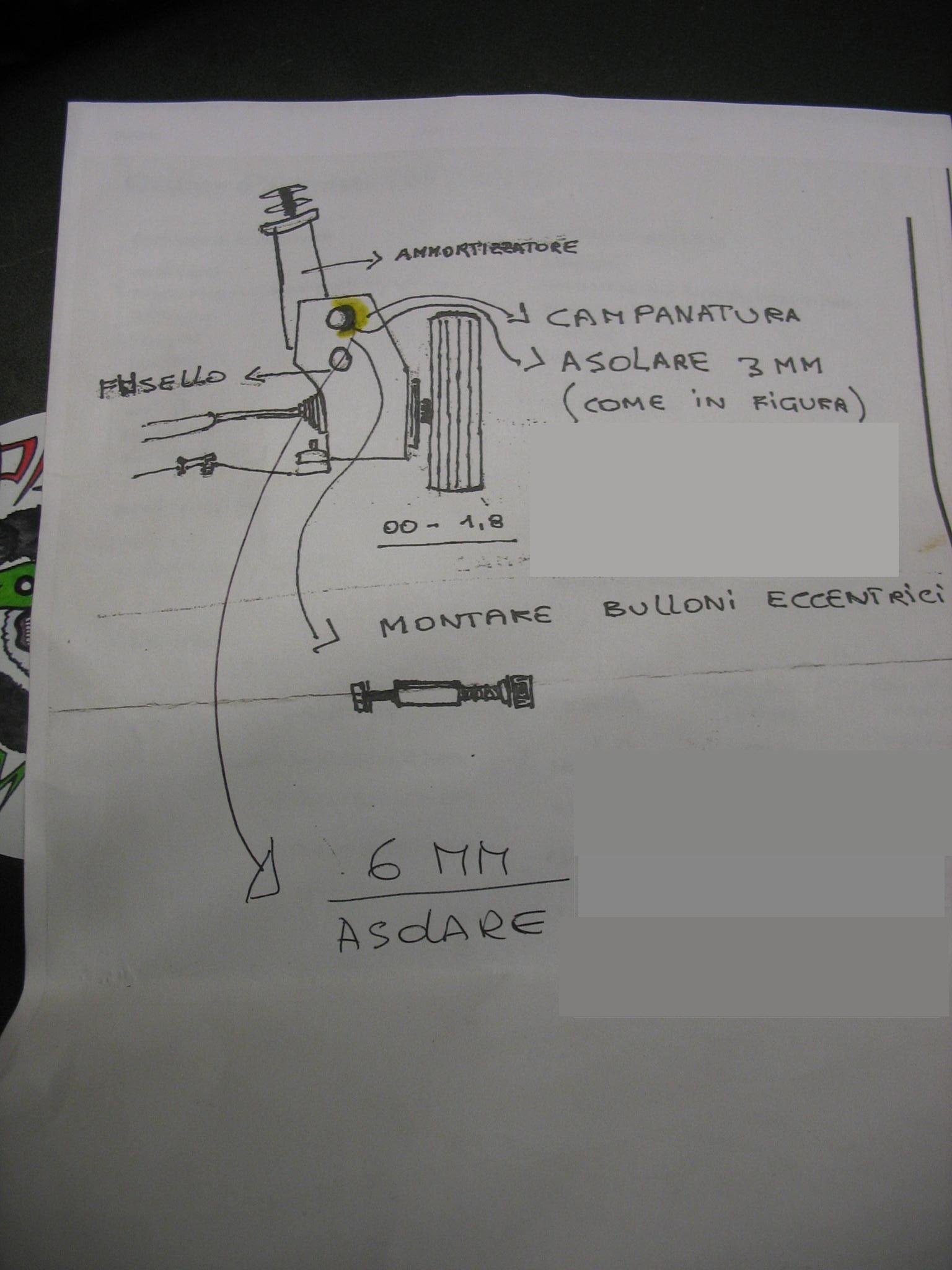

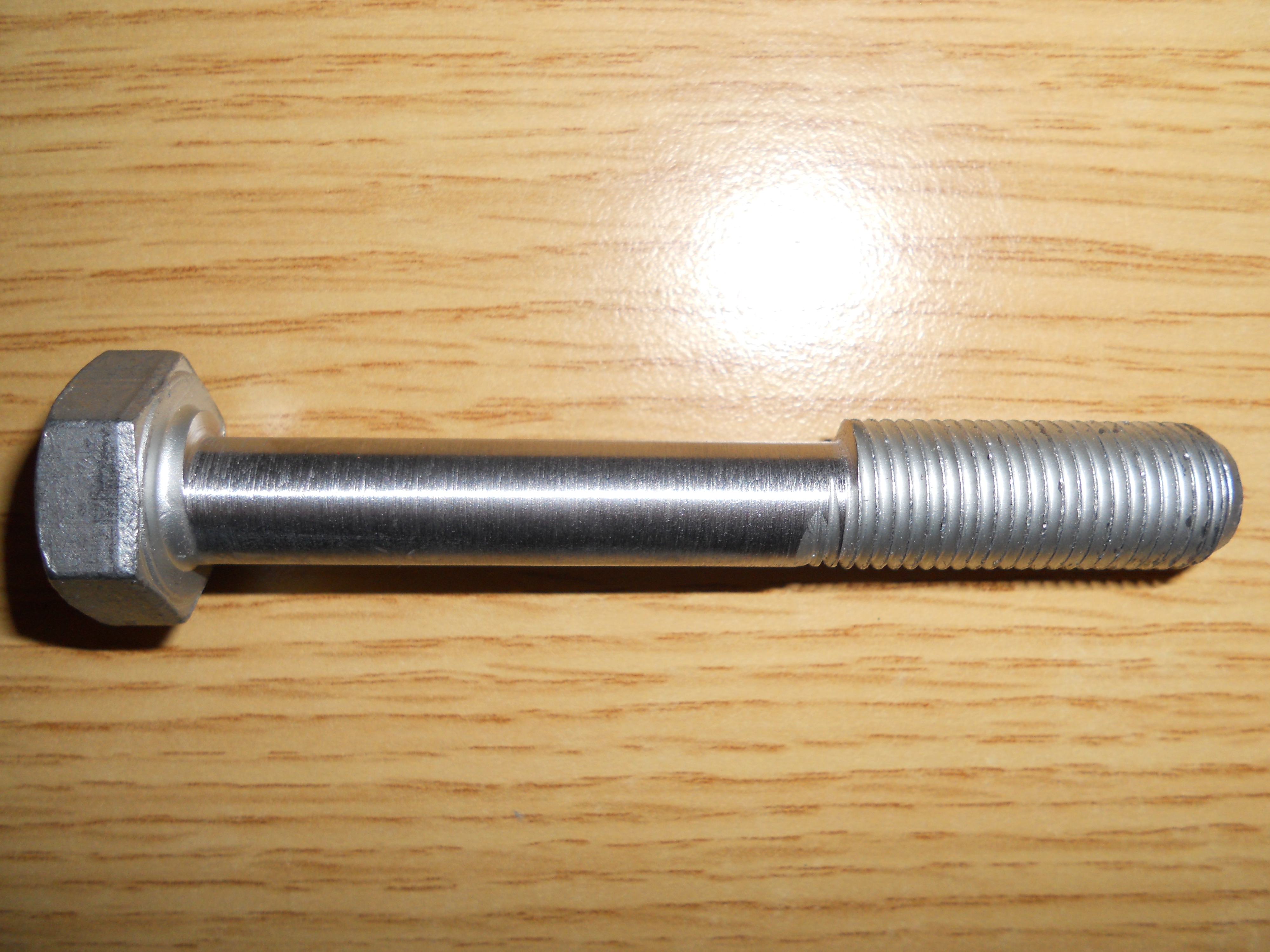

Finally, my magic camber M12 hub bolts are ready.
Two options available 2 and 3 mm.
Required if opening the top hub bolt hole is not enough to get the camber right.
Number of pairs and nuts available.
The general rule of thumb is roughly 1mm widening per 20mm of height, so 60mm lift would require 3mm drilling out :)
I'll see when i'll get to that point.
I've got 10mm top spacers only, the rest of lift is the coil spring and longer shock with relocated boils spring base plate.
At the rear i've got just the shackels, shocks and secondary coil spriings, no leaf to axle spacers.
There seems to be hundreds of different configurations.
Mirko, could you translate attached sketch, please?
