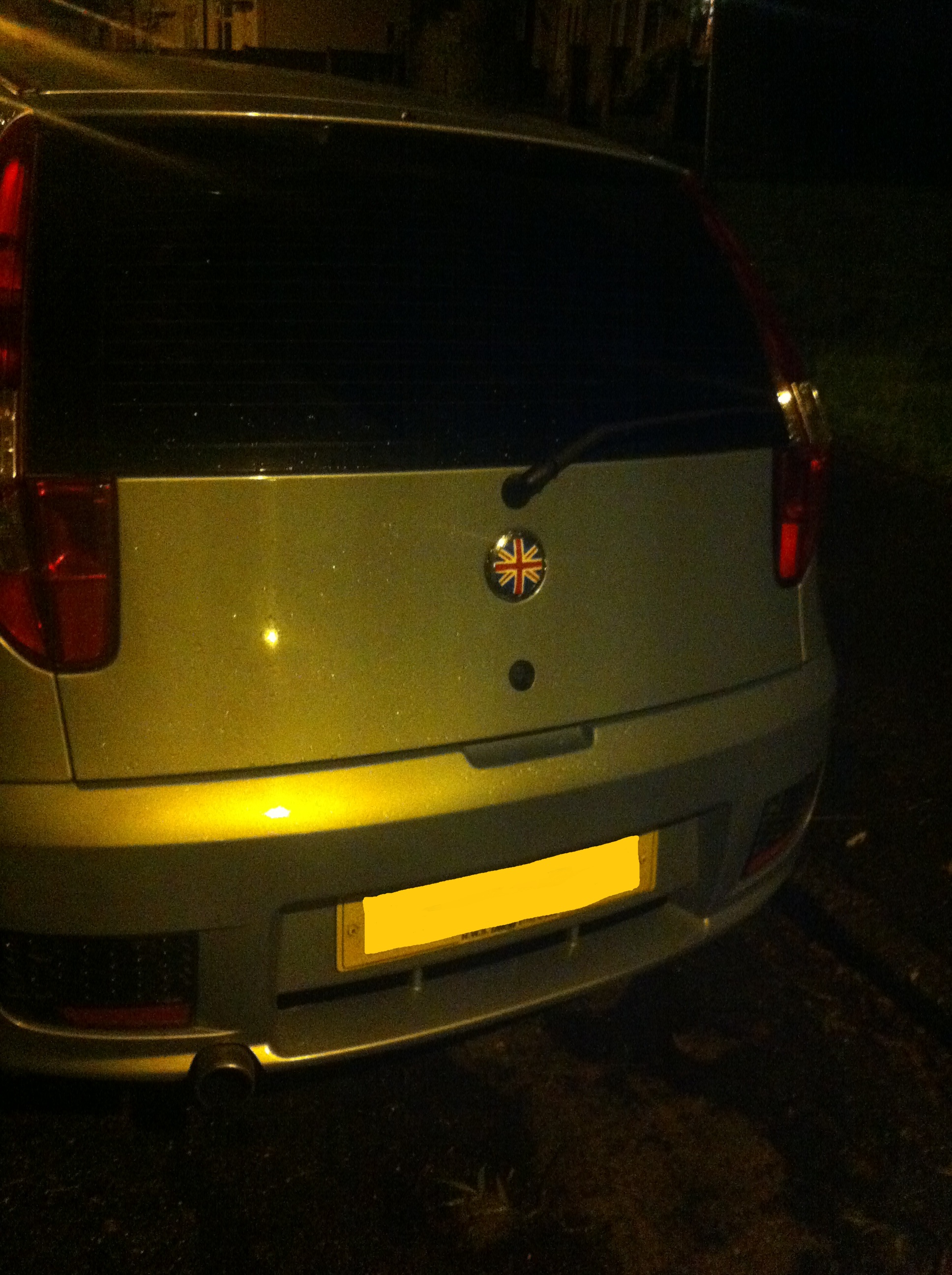

-paint boot emblem to union jack

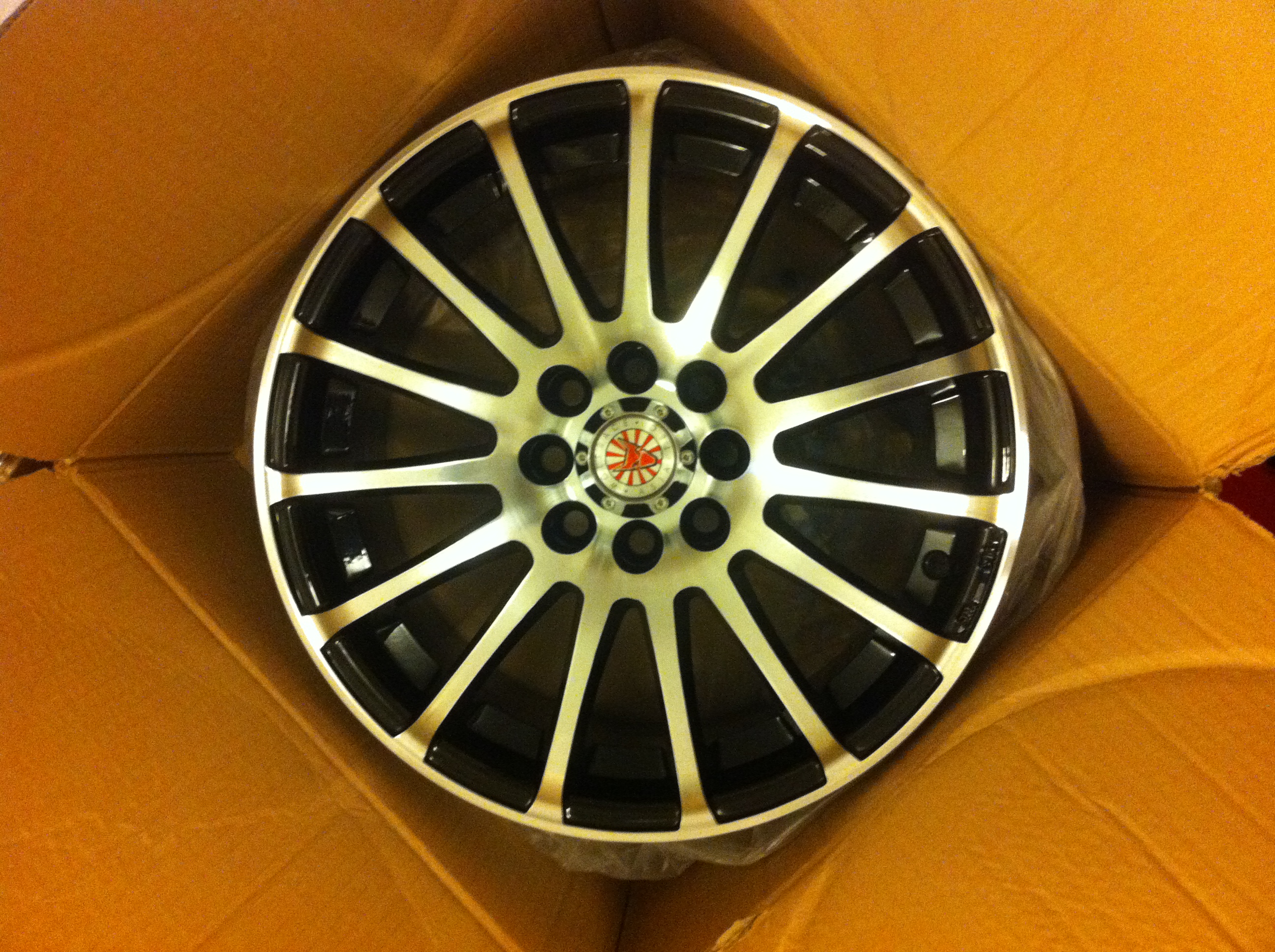

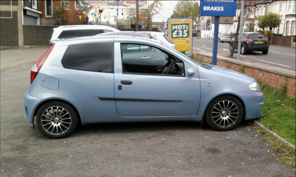

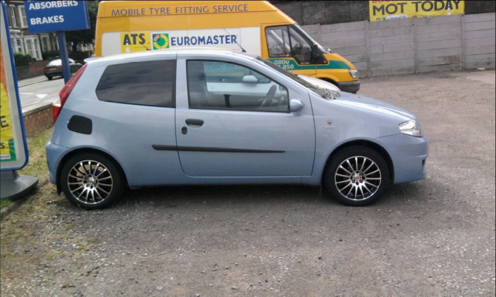

-New Alloys
-air induction kit *k&n*
-Black center console
-lowering springs *FK AK Street Coilovers*

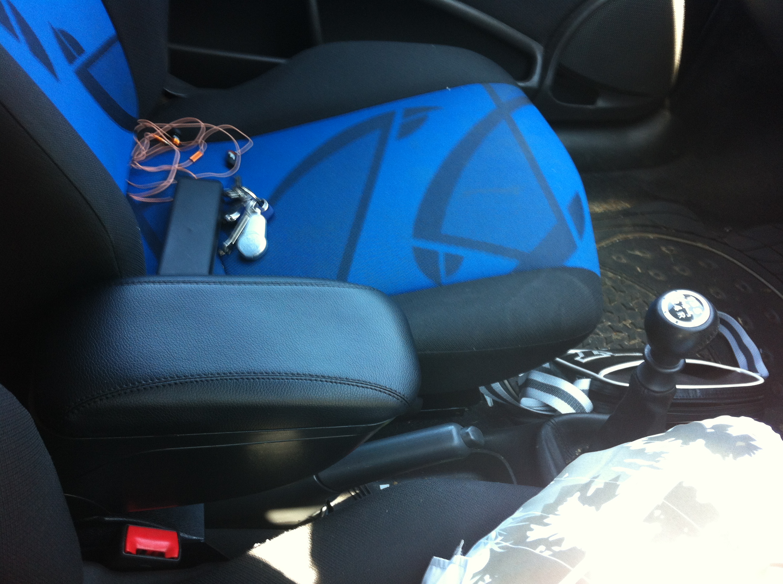

Almost finished :)
first i had to adjust my handbrake cable by tighting it (easy to do) so handbrake works on the shortest range without over stressing the cables,
you need to be prepared to drill holes in the centre console plastic.
you can screw it in but i prefer bolting it with nuts alot more stable,
i drill the holes first where the arm rest will sit, then taken the whole plastic console out so i can bolted it from inside aswell,
heres the pics
to take the plastic console off, at the back astray area theres a 10mm nut, underneath the handbrake pop the plastic out and theres 2 10mm bolts, take the gear stick gater out and theres 2 philips screws thats all
Looks to me that you cant adjust your seat position with that in the way? I just lean my arm on either my gearstick or handbrake lol
the final parts to my car and done :slayer:
