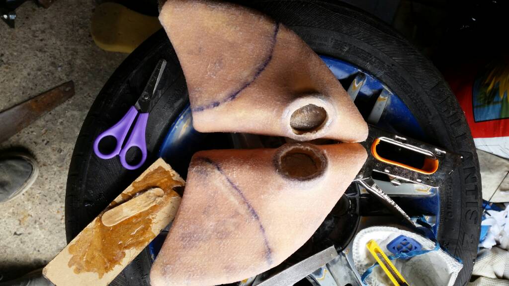

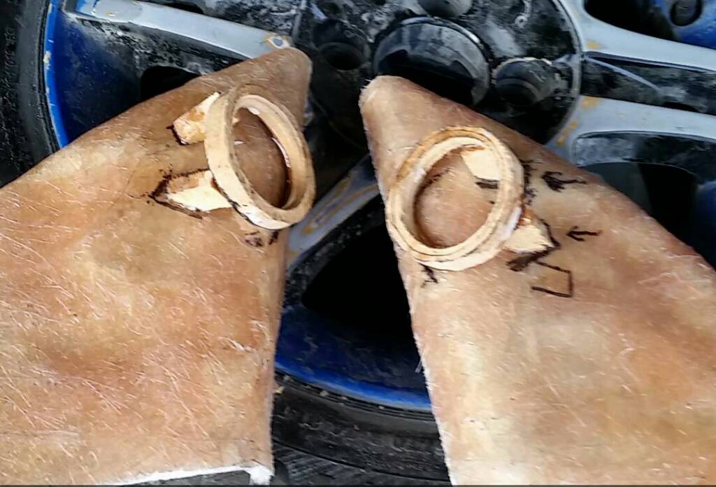

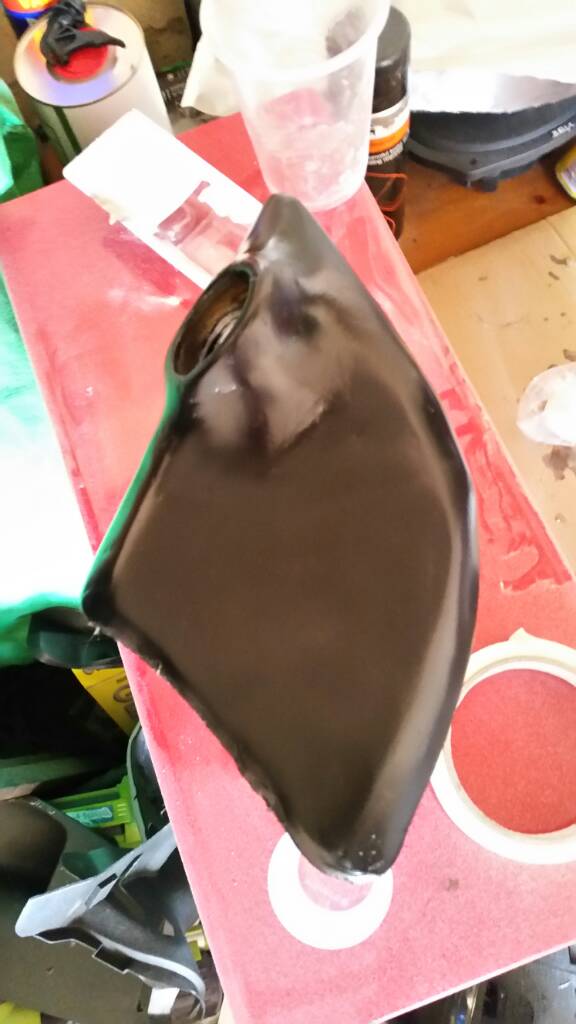

how did you make the Custom tweeter housing ? any pictures also how did you fit your rear seats did you follow the tut on here its a very nice colour
[QUOTE how did you fit your rear seats did you follow the tut on here its a very nice colour[/QUOTE]
I'd like to know too, becuase I've got a 147 leather interior. I have the front seats in, but ran into issues with the rear.
i made the custome tweeter housing by using mdf to make speaker rings to start with. Then i continued to covers them in felt material which will make the shape i need. Once that is done i put fibreglass resin on them to make it solid and used body filler to make it smooth before a lot of sanding and then painting :) hope this helps i will try to find some pictures of the process :) glad you like them :)
If you have some pics that would be great thanks
Hi hope this helps this was all the pictures I have of the process to make the tweeter pods :)

I have made them press fit into the car by using the fibreglass it slightly hang over the original plastic piece on some edges allowing it to at in place. Bit u would need to cut and modify the plastic piece by cutting the adjuter bit off flush and smooth, this allows the wiring to also come through for the tweeter
