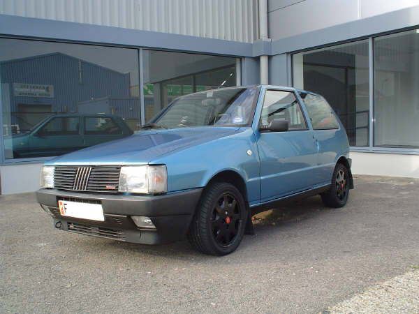

Hi All,
I’ve Just got my new Uno home :D
Now the work begins (y).

This is how the 45S was when I purchased her
The rear turrets were replaces three years ago. The front turrets and sills look good. There is a nominal amount of rust at the front O/S rear arch. The door, hatch, and front O/S outer wing bottoms are starting to rust through. The boot floor also needs some TLC.
The engine is a non-runner. It likes to spray oil through the cam cover when hot. The car has been stood since October 2004, and the battery is flat.
The Seller tells me it started OK till the battery went flat. He was unable to get a spanner on the positive connector to recharge the battery and wouldn’t jump start.
I removed the battery in no time, and connected his spare. The engine turned a couple of times, then just the sound of high current flowing and nothing else.
I’ve just been to try and start the engine again in the hope that something could have rattled free during the trip home. Clunk! ZZZZZZZZZZ No such luck :(.
I’m going remove the starter motor and test it. Then take the plugs out and turn the engine over by hand (big spanner on the crank) (as advised by SFC julian). Wish me luck :).

Engine state of play...
Crankshaft pulley turned OK. Shame the timing belt jumped teeth :( .
Camshaft pulley won’t budge with over 70 Foot Pounds (98 ish NM) in either direction :confused:.
The sparkplug electrodes are dirty, bit in tacked. I’ve put them back and called it a day.
Any guesses as to the top end problem? :eek:.
