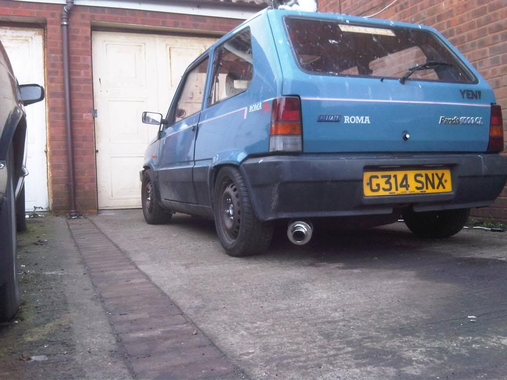

new springs today =] i orderd some really stiff ones so the back isnt so bouncy haha
Are they the 'proper' lowering springs for the Panda?
I have them.......they arne't really that stiff. I'm looking for another set maybe another 50% harder. Was gonna head to the breakers yesterday see what cars have similar size coils.
yeh they are mine are stiffer after i choped them abit drives really well now
What wheels has it got out of interest? Not standard Panda are they?
nope there not panda steels
I think they're Vauxhall wheels Jon, but I'm sure scotty will confirm.
you guess corect they are mk1 vauxhall corsa steels
They fill the arches very well and look brilliant. Do the tyres catch the inside of the arch? Or have you cut it out / rolled it?
yeh man they fit real good =] you know vauxhall steels / 20mm spacers and 175/50/13 coninentel tyres =] and the only thing i have done is fold the metal lip up on the arch so the steels sit right behind it so its got a little bit of stance =p

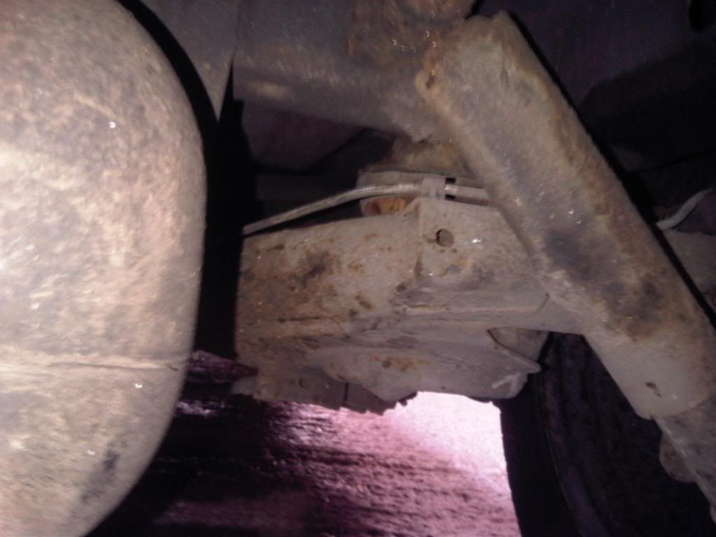

i thort i would take a pic of how less room i have left lol
there is a inch befor its sat on the chassie
yeh there is 4 coils still in there =] and escort van bumpstops =] dw i no what i doing

thanks alot man =] ive been trying to get to ride hight perfect and i think its pritty close. as for the wheels there vauxhall corsa steels =]
it handles so well with the low pros on it and at the hight it is at its like a go cart =]
yeh the bumpstops are pritty much the same just a bit fatter =] i really like how it sits on the back
wel i had my welder and a set of wheels in there plus 2 guys and it didnt scrub =D the bumo stop is close but not touching yet hahah
