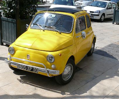

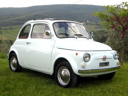

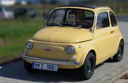

No I have not seen this. It looks like a cross between a 500F and a 500L. There were three style front ends used on the later 500's. The 500L used the style Fiat center badge on your car with nothing else. The 500F used a different center badge with the side "whiskers." The 500R used the more modern block style FIAT badge with no whiskers. Not sure if the block style badge was used on the late 500F's.
You will see that various cars have different incorrect front ends on them. My car is a 1969 500L, but has an incorrect late model 500R front end panel (FIAT in block letters). I think it is just what was available cheap in Italy at the time to replace a damaged or rusted front panel.
Pics below show the three styles.
Your car also has the nerf bumper guards which would have only been on a 500L, but some owners add to their 500F's.
