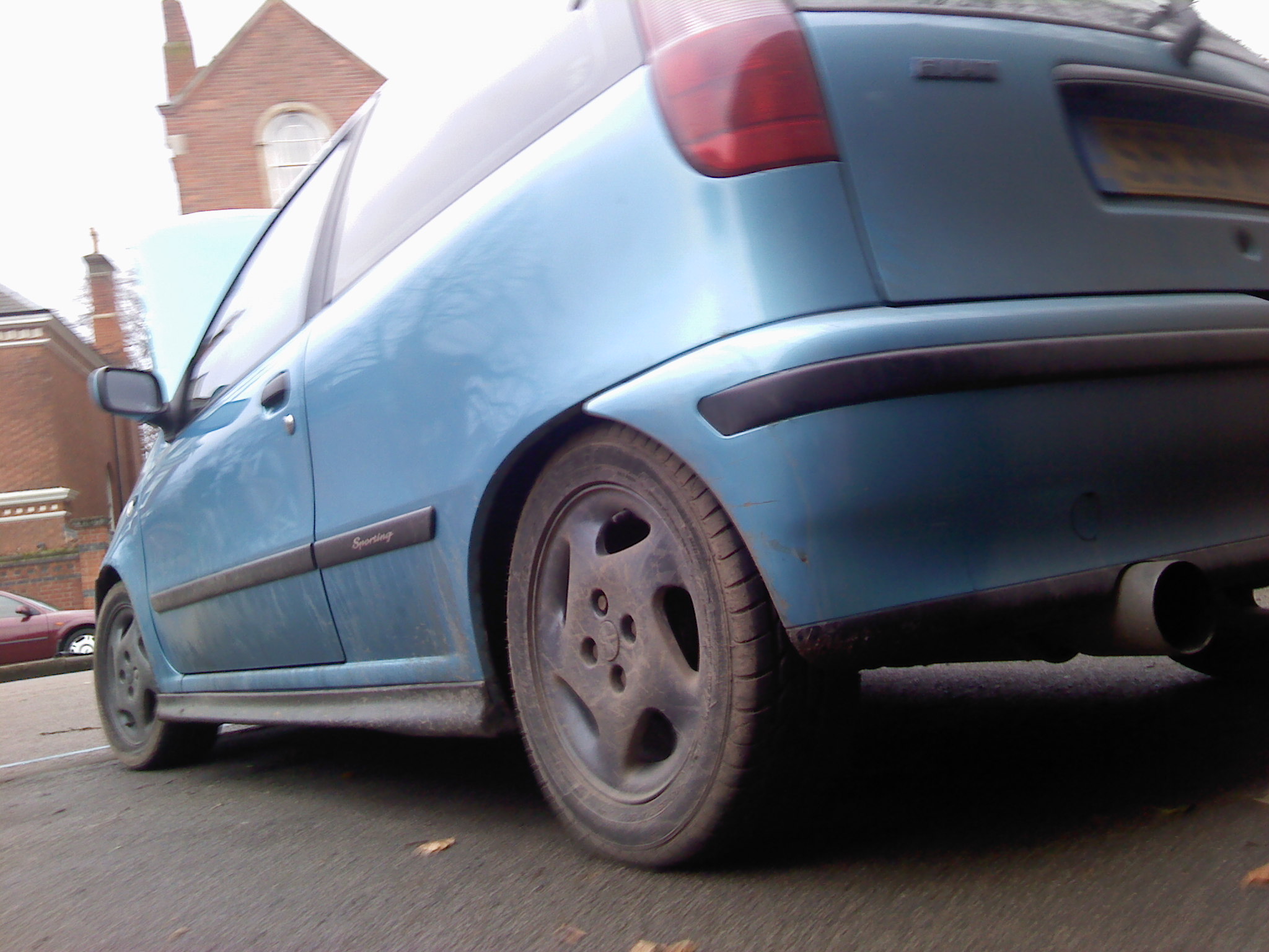

ok i'm back (again) behind the wheel of a fiat after a very short break, and this time i have done it properly and got me a lovely mk1 sporting which is mint apart from the NSF wing has some rust around the arch
let me know what ya think
body wise i am leaving it how it is as it is lush standard lol
but what i have got in mind is
1:- wheels spacers off cinq so 10.5mm rear 9mm front

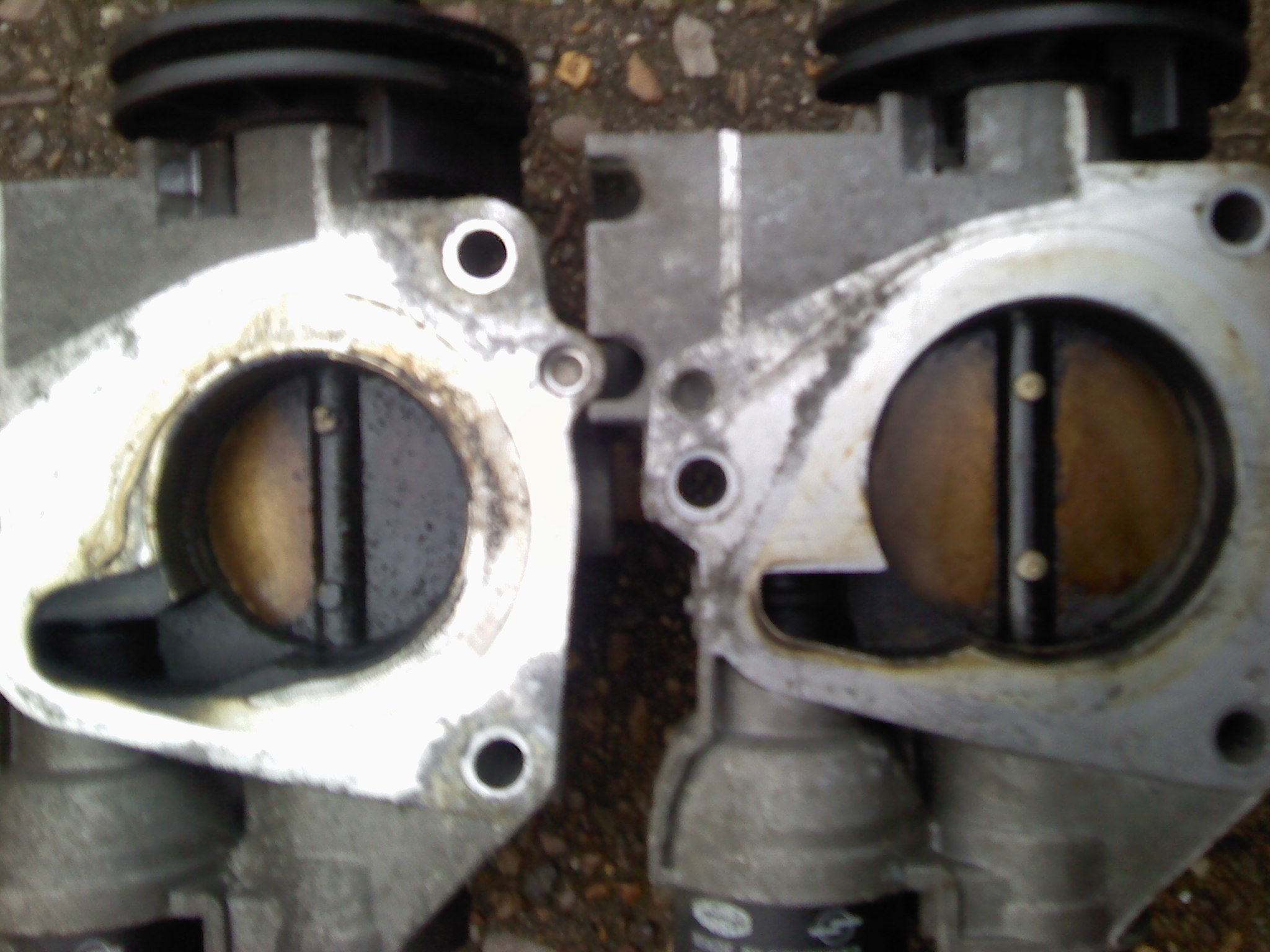

2:- 1.6 16v TB of a marea (just bought today)
3:- 4-2-1 mani with sports cat
4:- re-map or superchip
5:- cam but not sure what type yet as i dont know whats available for the 16v's
i would be happy if i could get 100bhp out of it as its very nippy as is with around 85bhp

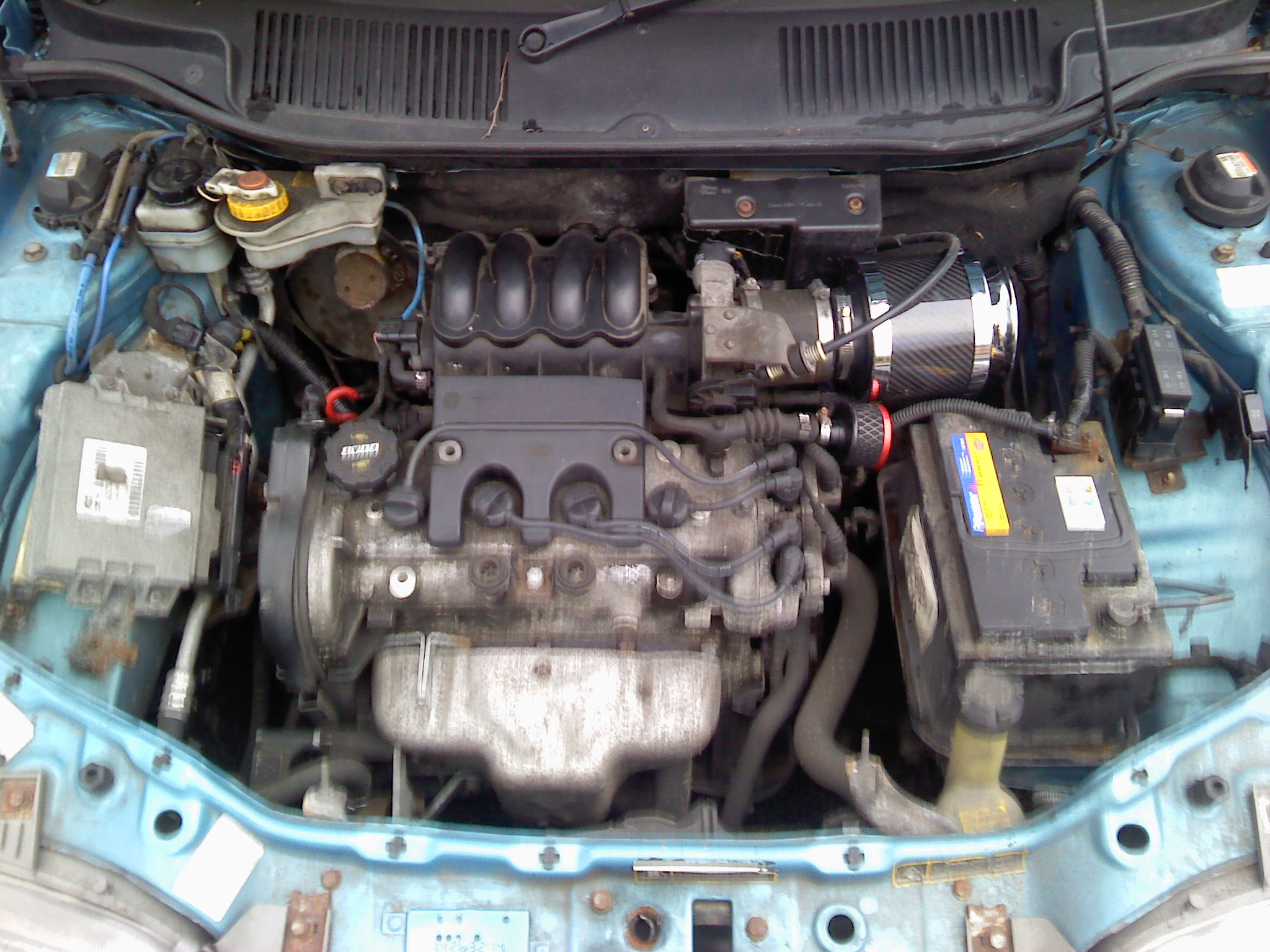

ok took my beloved punto to the dyno a couple of weeks ago and engine mods are as follows
46mm 1.6 16v marea TB
cat back SS 2inch exhaust
sports filter (badly positioned and restricting high end air flow)
stage 1 chip
it did 97.1bhp but is running rich over 4250rpm which we think is down to the airfilter position
with the airfilter sorted i should be over 100bhp (1368cc terrotry with only simple mods) and looking to go further

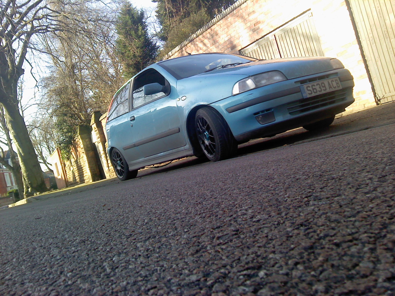

oh and its sitting on new wheels too oh and also fitted a brava engine cover too which looks well smart

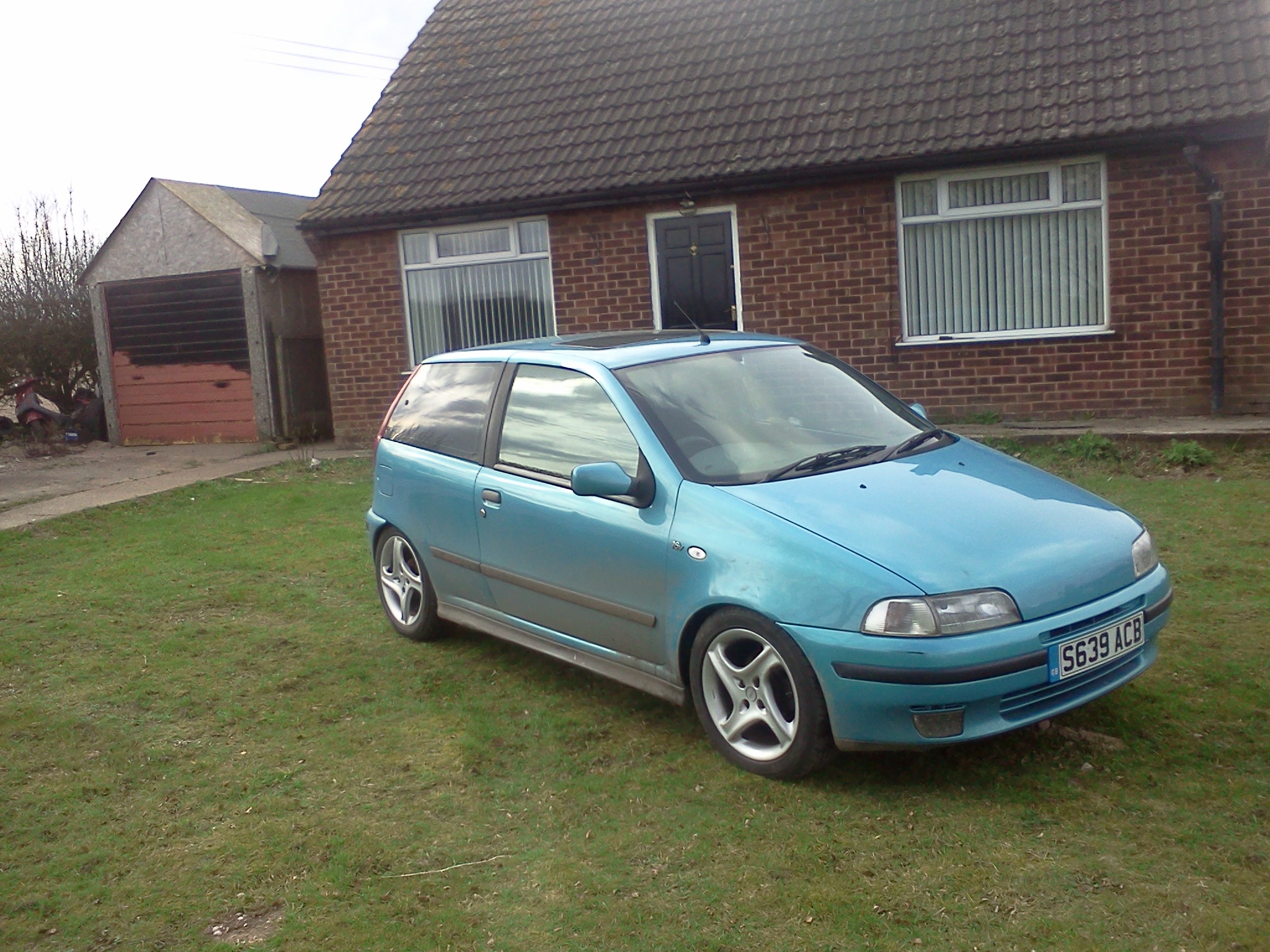

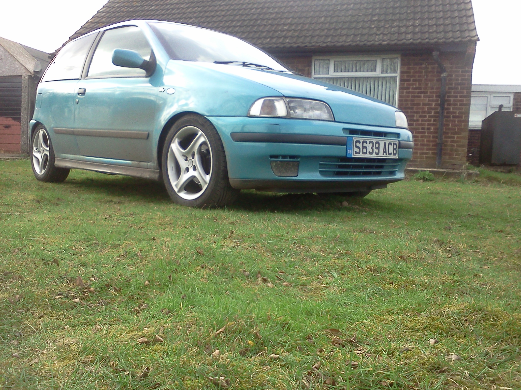

well heres another update, finally got myself a nice straight set of coupe turbo 16s and got them fitted, there has been alot of cutting and modifying done but got them on with the 205/50r16's and there is no rubbing

as for the wheels i still have them
future plans are a little in limbo at the mo as she might be up for sale in april as i might be buying a race car and this wont tow a car trailer, if i do sell her the black wheels will be going back on and i will be keeping the coup 16's for my replacment tow donkey lol
