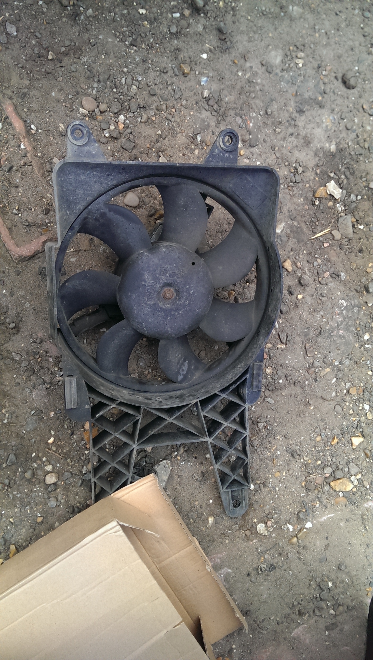

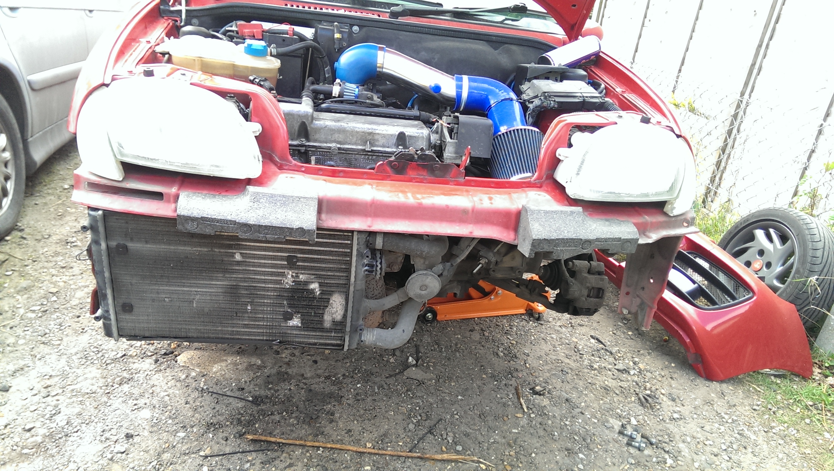

Today was a total fail really. Had the wheels, bumper and inner arches out to sort the radiator out so it stops dropping out, sorted that problem so now its reasonably secure. The slimline fan I ordered turned up too so that went on and I replaced the 30A fuse for it again, so now I have a cooling fan for the first time since roughly December. Stangely the standard mpi fan still works so it must have just been a dodgy connection :bang:
Just fitted:
Anyway when I got the car home again the mounting ties had melted a little and the fan partially fell out and now obviously won't go back on since it's all mushy plastic. :cry: This has greatly wound me up so I've messaged the bloke to see if I can get a refund or a metal mounting kit that can cope with the heat of an actual radiator :mad:
To top it all off the front bumper mounts are all ****ed, I have no bolts at all on the drivers side as they have all sheared off and the passenger side ones are there but just spin in the holes :bang: So it's partly mounted on and cable tied, I will probably be looking for a black plastic mpi bumper to fit in a few months since no red one will be the right colour.

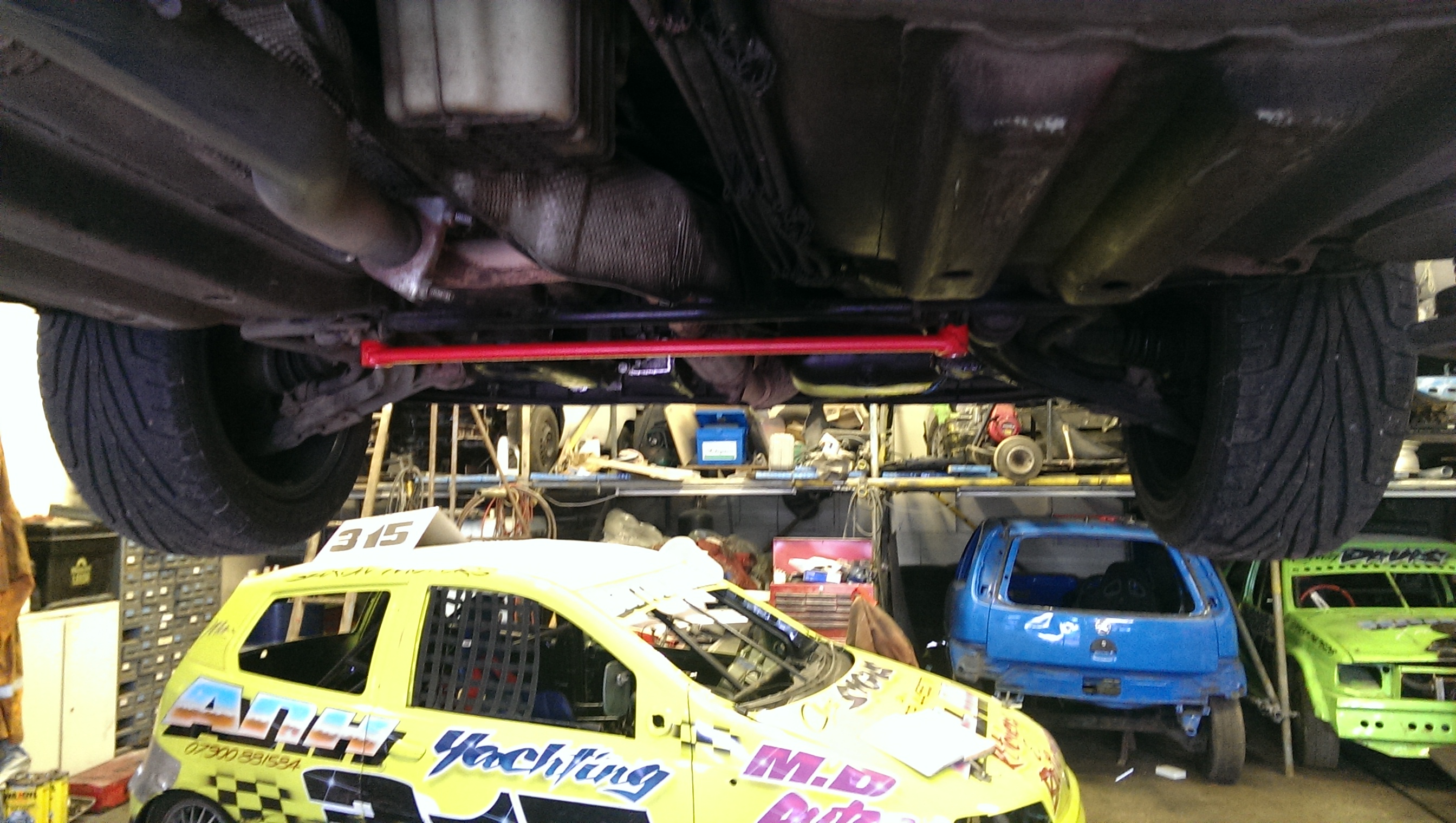

Well after yesterdays failure at putting the brace on it's on today! The holes needed widening as the brace was too short to bolt on however it's now fitted and rather awesome!! :D
It handles really well, there are a little more vibrations which is to be expected but this means I can now feel the road through the wheel alot better. I think there is a little more road noise too. There is no longer any s***ty axle tramp if you make a fast start, just proper wheel spin. Also it accelerates much smoother on bumpy roads and is less unsettled by bumps. The steering feels a bit more precise and sharp in general :woot:
Most of all it no longer feels like the front wheels are folding up under the weight of the car in a hard corner, it has way more grip and I can now actually feel the tyres letting go whereas before the car would understeer much sooner and you couldn't really feel what was happening at the wheels.
Main point - it's superb and I can now take roundabouts much faster. Downside being even more possibility of oversteer in the wet :eek:
Next on the list will be an upper brace :slayer:

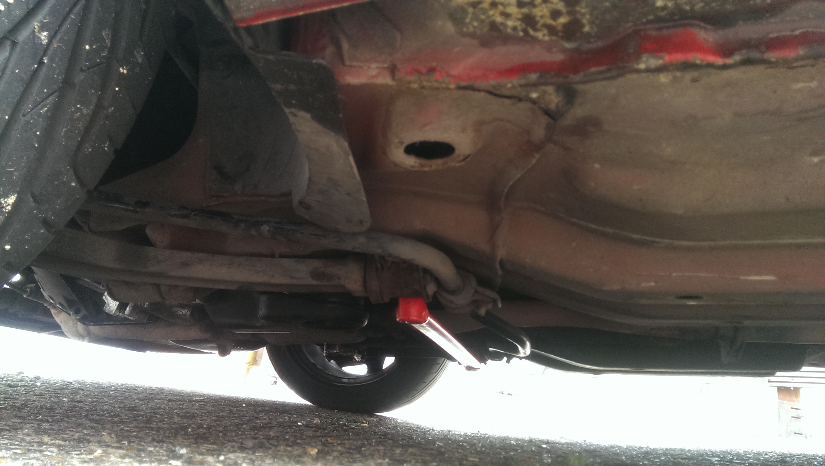

Oh and this fell off earlier.... Just after I overtook someone so I had to stop in shame as they drove by while I removed it from under the car :(
I don't run heat shields on mine... i probably should but i ripped them off when them rattling off the exhaust got too annoying, plus one less thing to fall off :p
