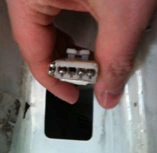

Ok ill try and explain... here we go.
1. Take your passenger side plug and trim away the clip on the top that keeps it in place, then rotate it 180 degrees and attach to the evo light cluster (not using the pin at the very left of the cluster).
2. Now get your drivers side and copy what is done in the picture below. Same again trim the clip of the top of the plug and then attach it to the evo cluster.
Now this should be working, but with a light on you dashboard. This is because the led is not drawing enough power so the car thinks the bulb has blown :p

RyanBox Mind if I just run through the procedure on here and you tell me if I've got the right idea?
1)Unscrew ordinary rear lights from chassis
2)Unclip white (plug?) with 4 cables from original lights
Then it's at this point that I'm not sure - on the photo in the guide you linked me and just used as a thumbnail, what is that metal tooth on the far left and how did he move it there?
Sorry if I'm sounding stupid here! Just clueless, ha!
Do this only on the drivers side. Get a small screwdriver and poke the metal contact out and remove that wire from the plug, then simply tape it to the left hand side of the plug with black insulation tape.
Ah ****e, see I had no idea that you treat the driver's side differently to the passenger's - thanks mate. Don't think I'm ready to install yet!

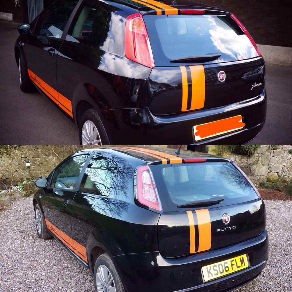

Yes mate! I followed your instructions and got them in this morning couldn't be happier! Thanks so much for your advice, couldn't have done it without you! Thought I should just pack it in the other night, very glad I didn't! View attachment 131574
Your more than welcome :) glad to see you got them on! They look awsome, wait till nightfall they look amazing at night ;) all you need now is a spoiler just to finish it off ;)
