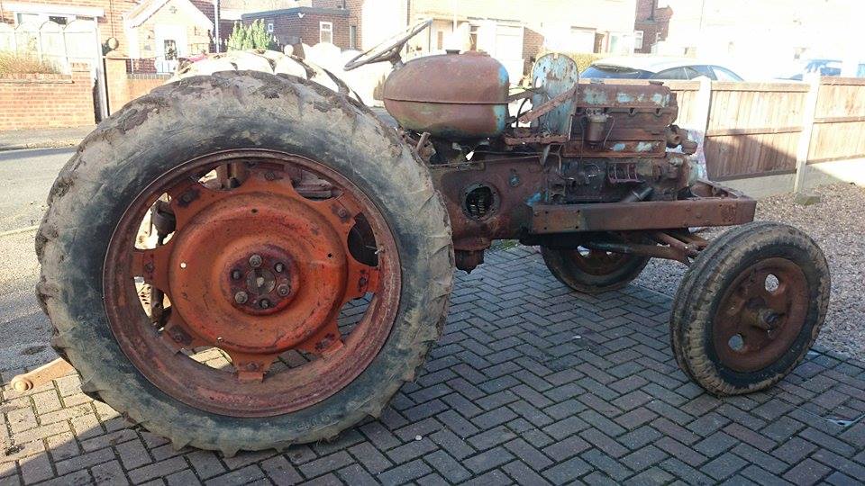

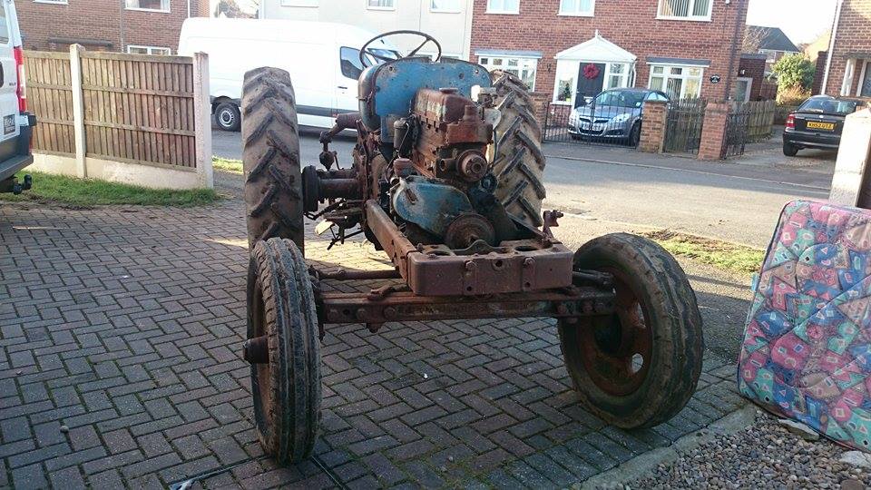

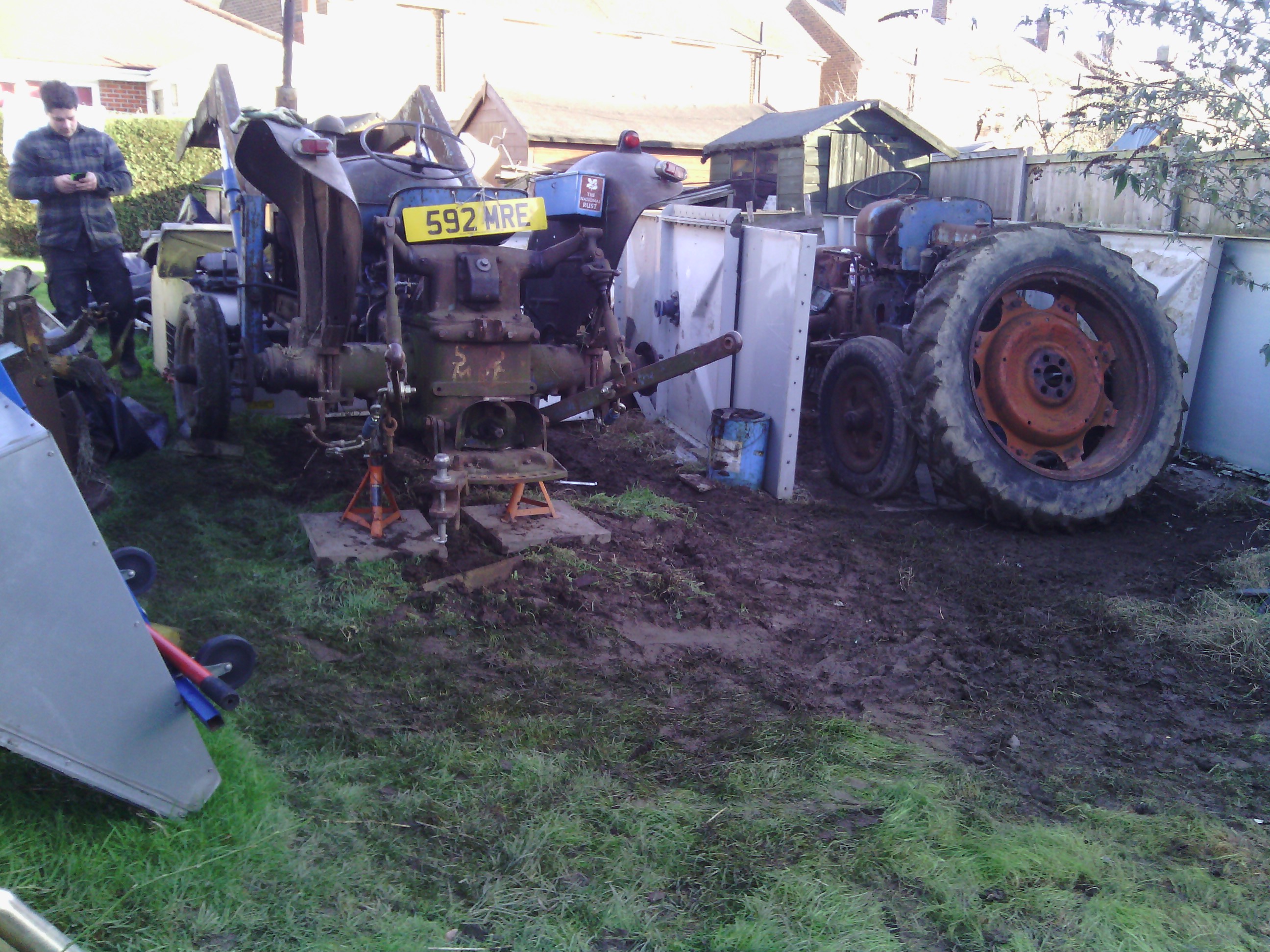

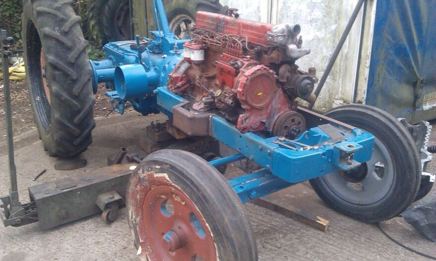

Today what is left of my tractor will be leaving. I have no time or money for it, so got everything new back off and anything worth saving. and ruined the garden in the process.
Also found a great fault on the landrover, the thing hardly ever starts and now randomly cuts out. so that was fun to winch and tow with. Total towstarts today, 3.
Wheels had to come off one tractor to get it onto the trailer, got to go and get them back on next week. so that'll be fun.

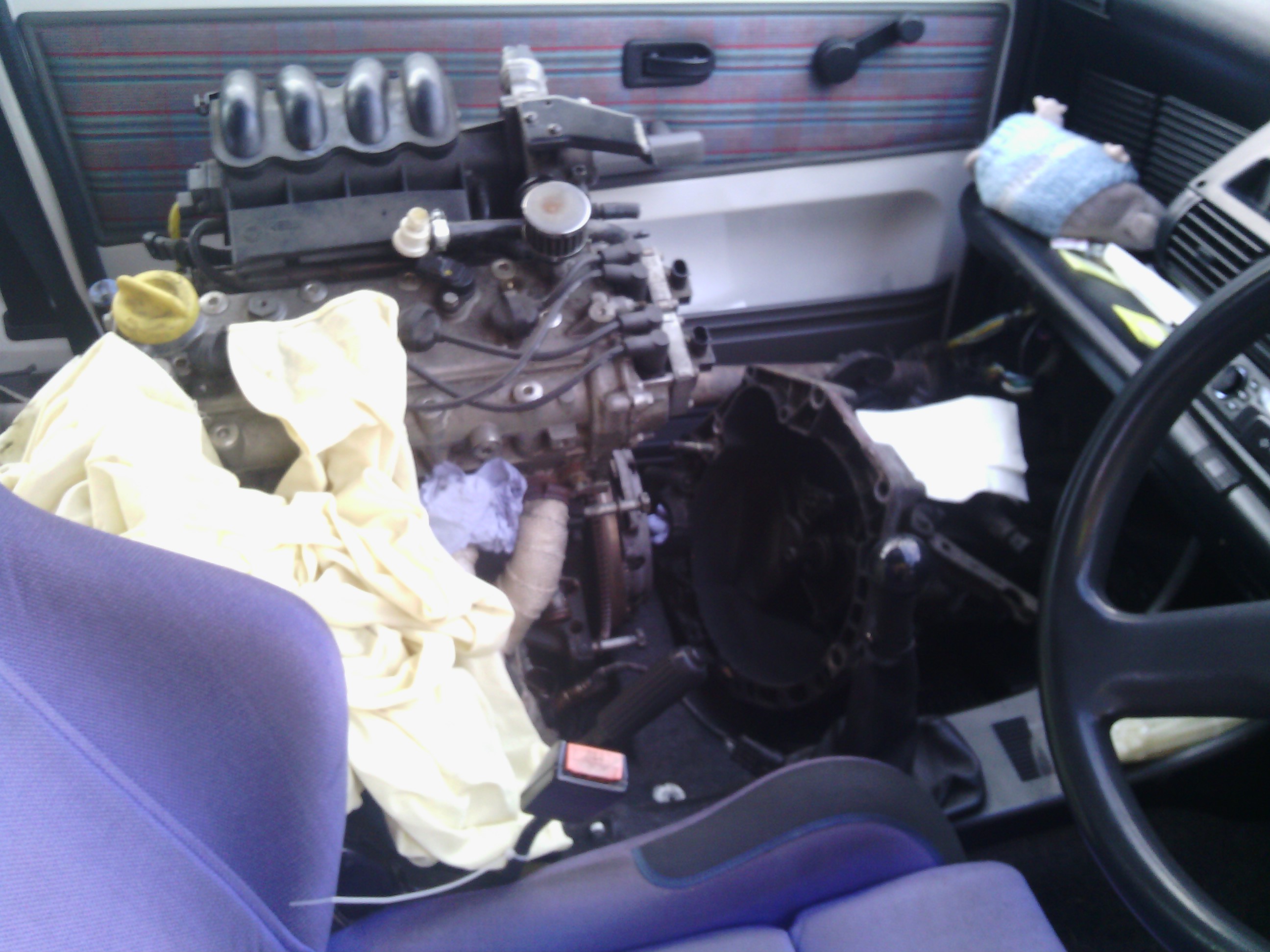

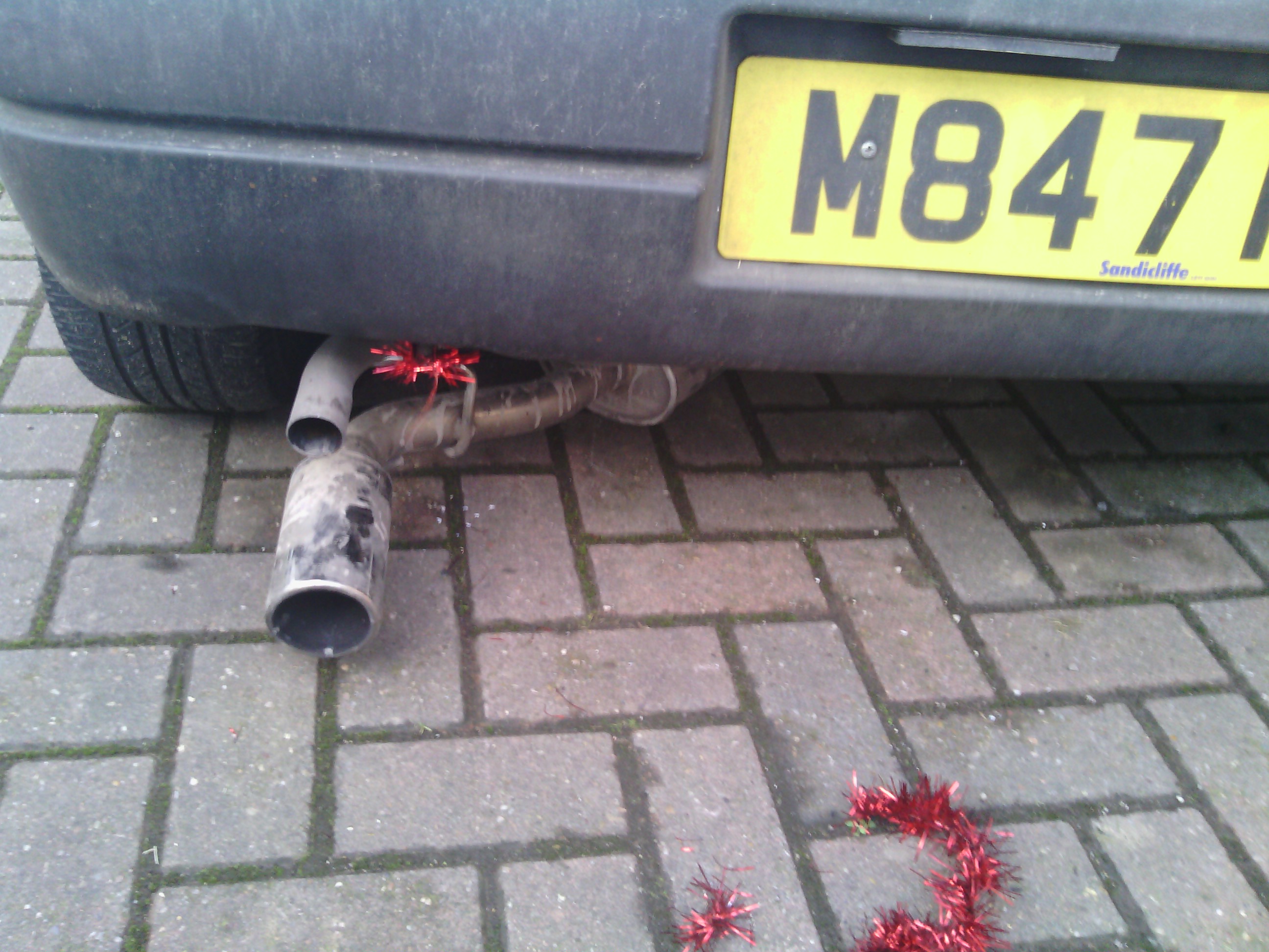

So today in my travels I landed at a garage, saw this hanging form a car, and decided it would be a good purchase. So it went in my car, and I have had a 2.3l 24v twin inline 4 engine configuration for the day. That's how it works right?

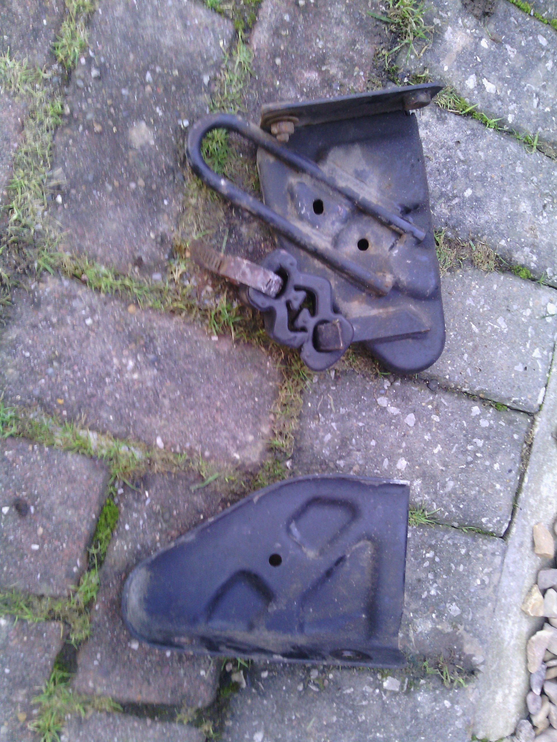

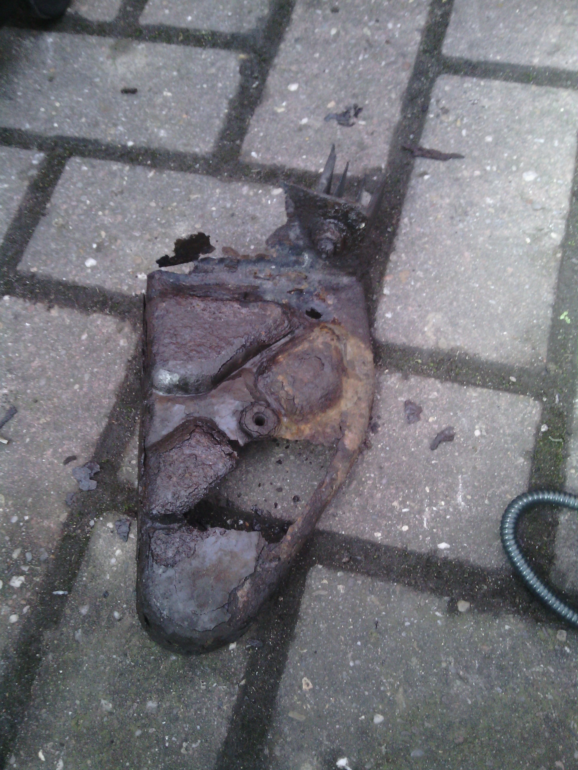

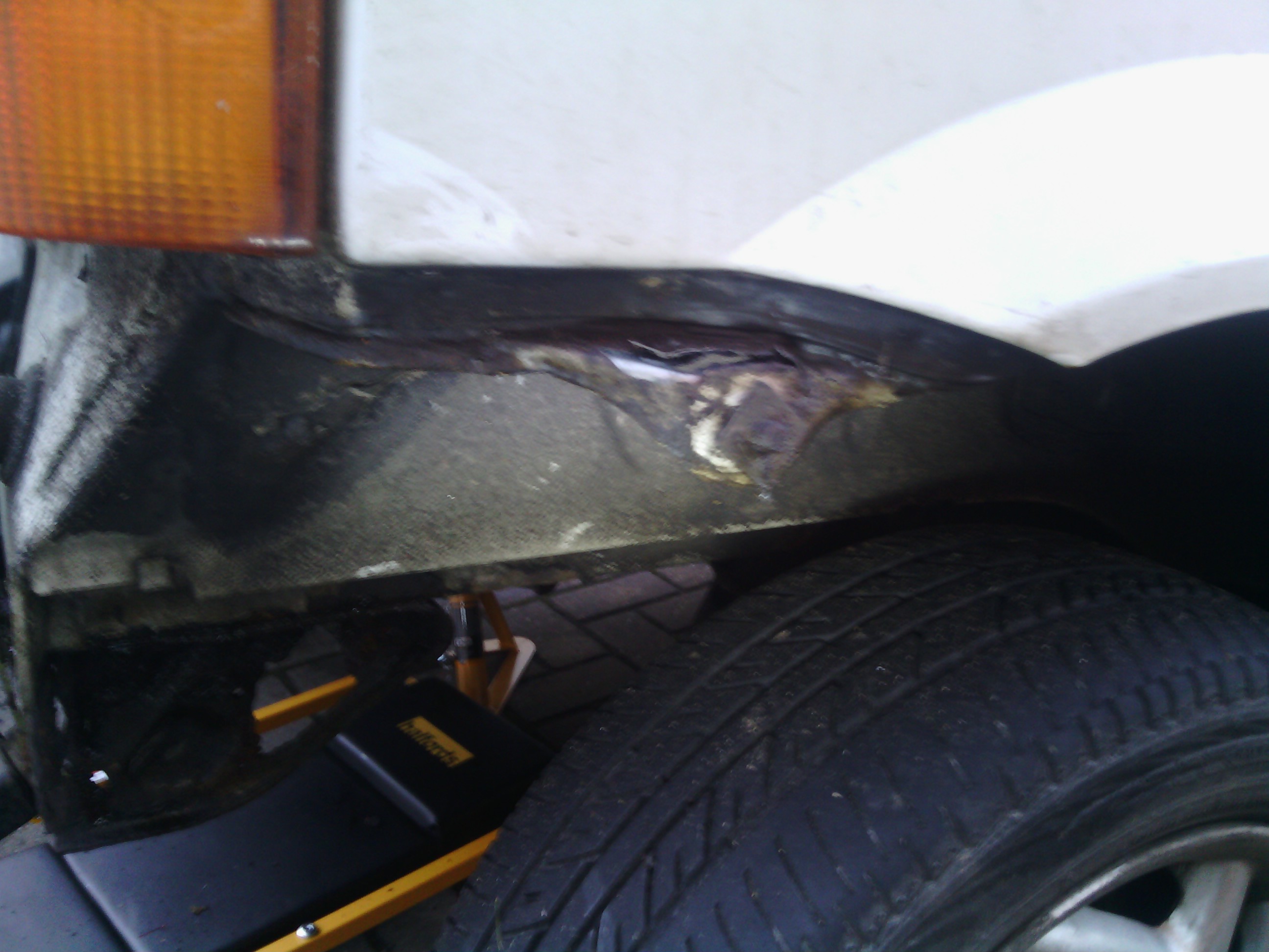

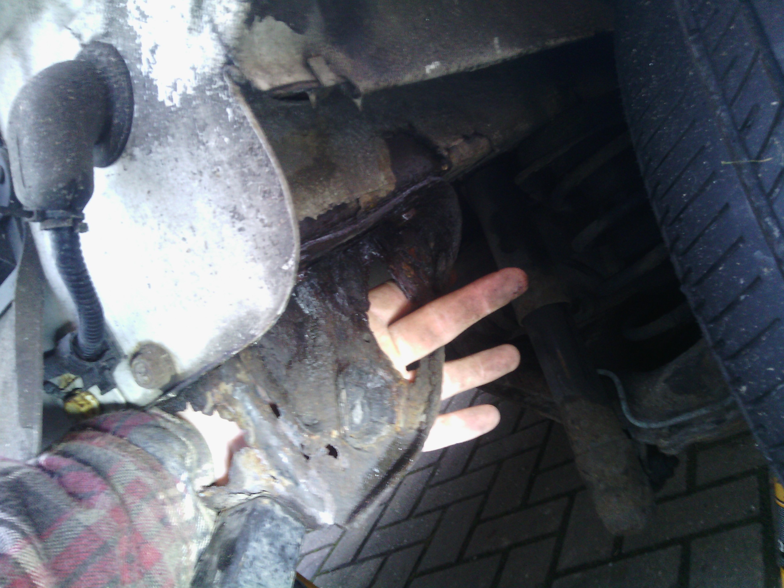

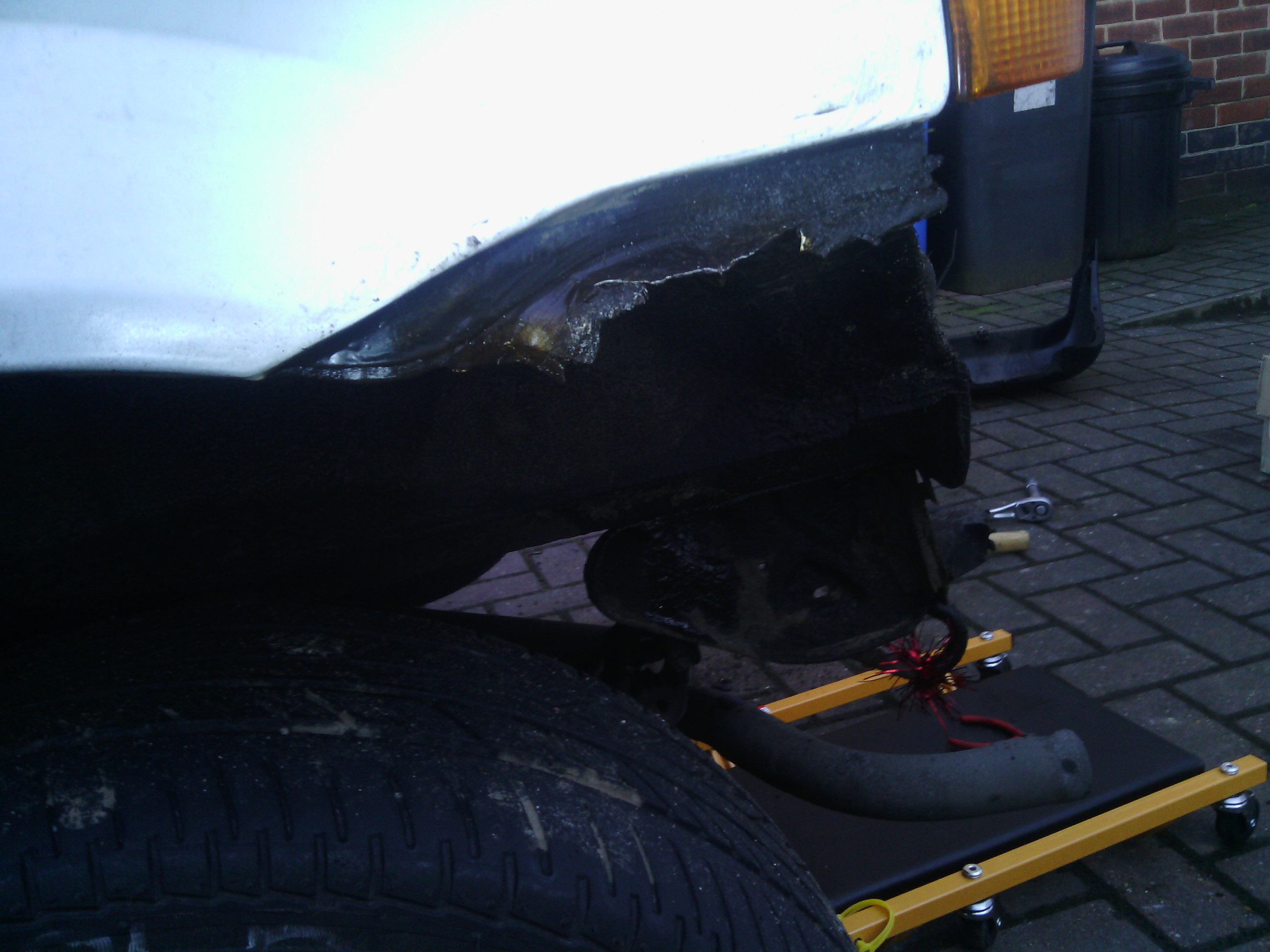

When I got home I thought I would just take the rear bumper off, as you do. New bumper brackets ready to go on.
and what was on.
The side bumper clips arn't much better.
Also picture of cars booty.

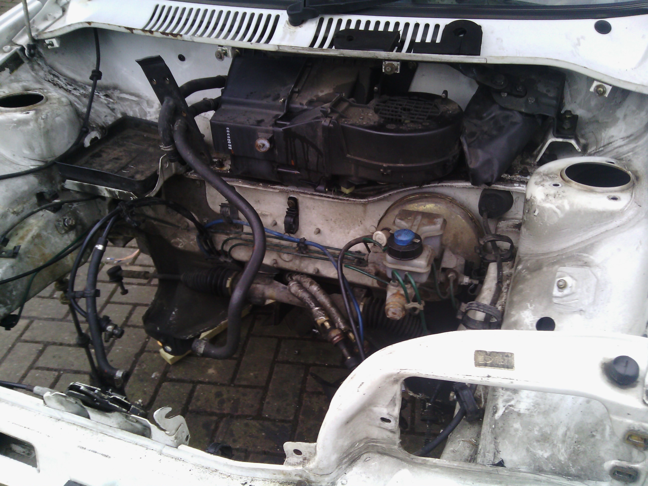

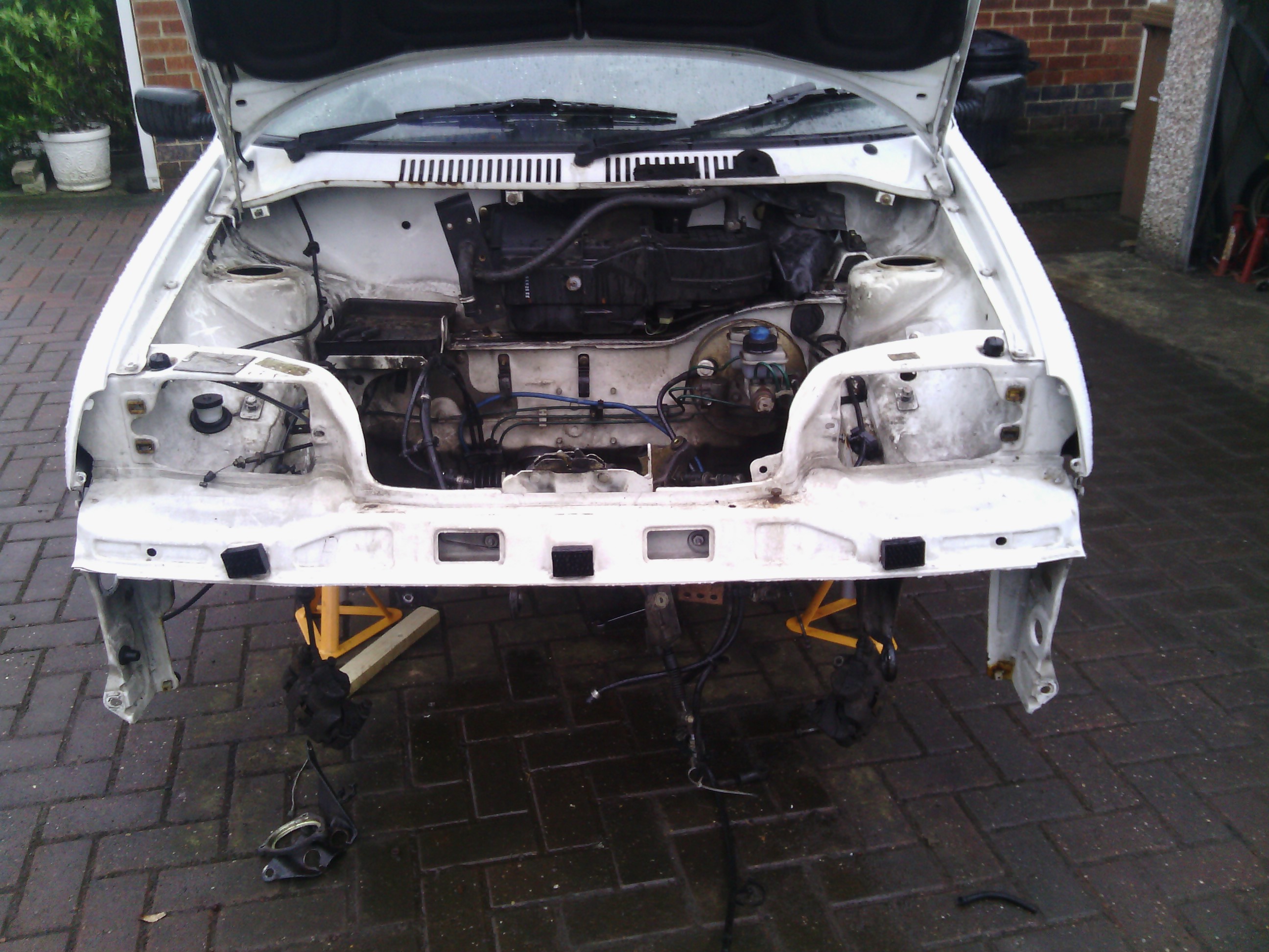

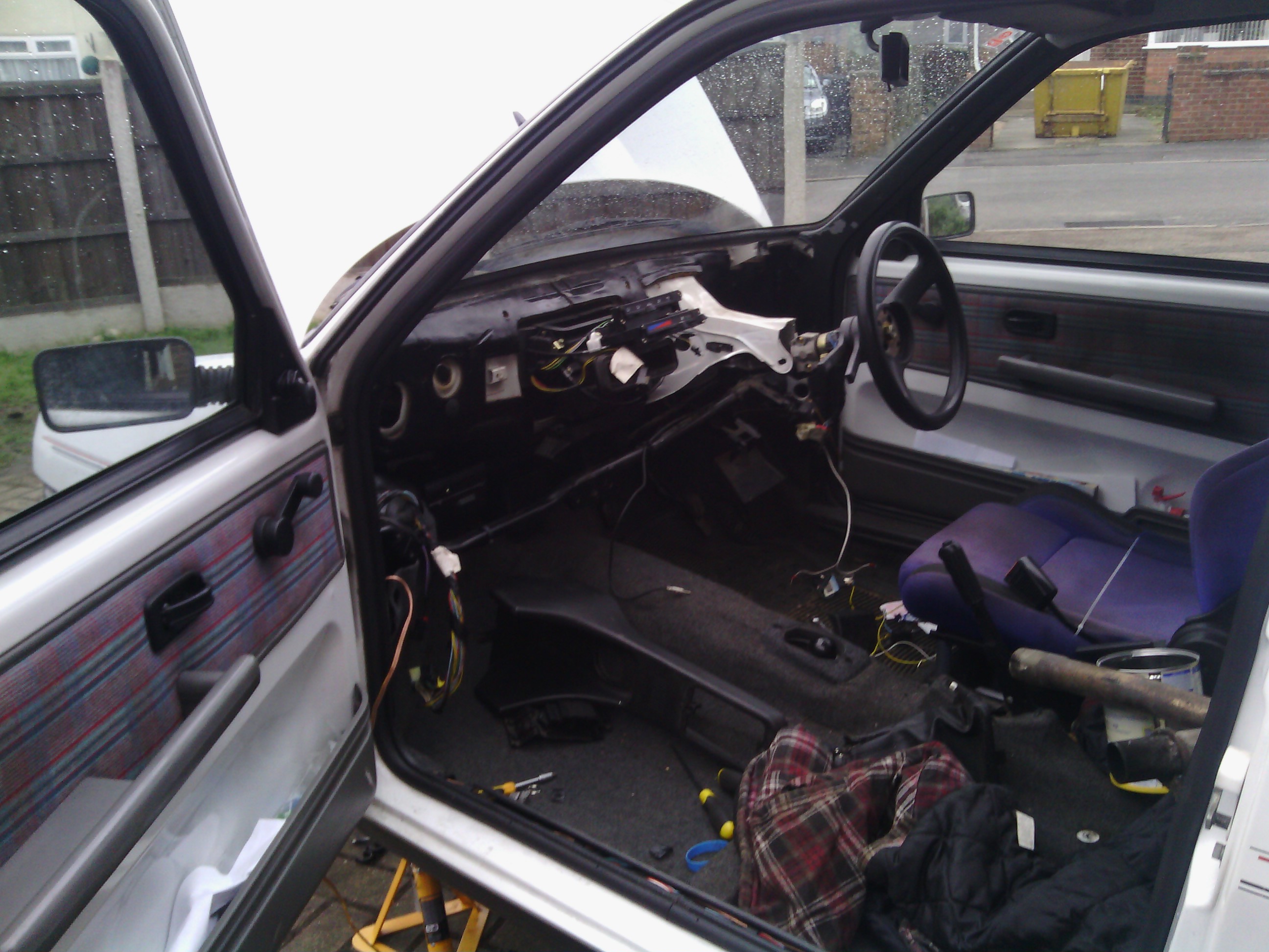

Yesterday rain stopped play, and not much got done apart from removing cooling system and horns, Today I removed the drift shafts, hubs, wishbones, shocks and exhaust. Also the engine loom is disconnected.
Unfortunately I had to take the hubs and shafts off together, anyone know the easiest way to now undo the hub nuts?
Didn't take many photos today, but there isn't much to look at.
Engine has got to come out tomorrow, so I can start rewiring. So I will be braking out all my lead lamps and other sources of illuminations.

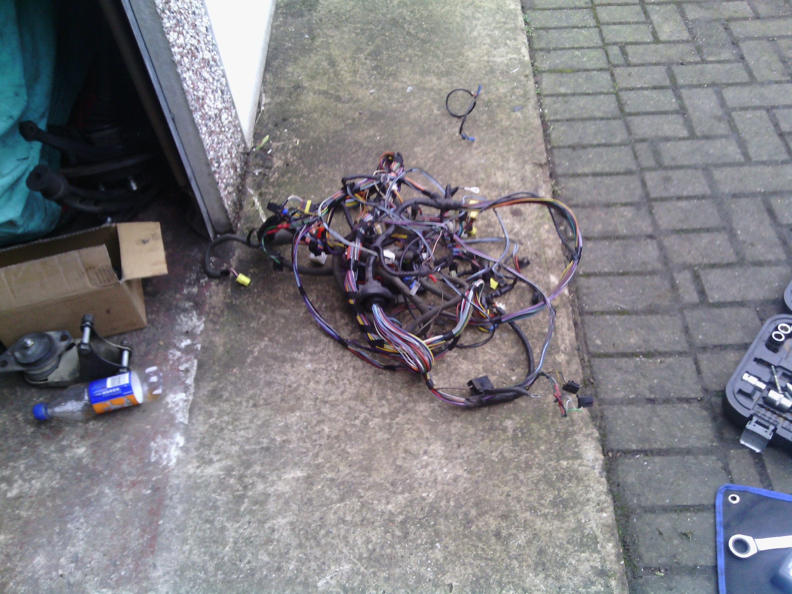

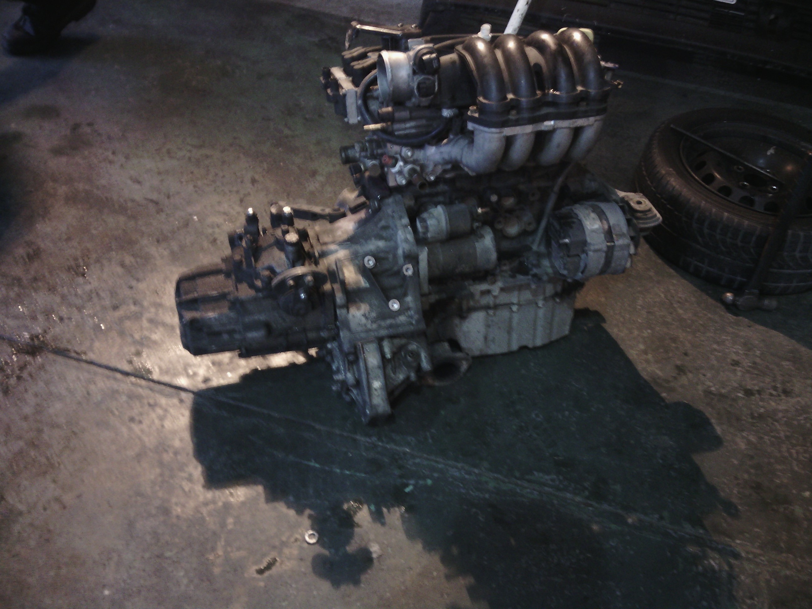

Got the engien and gearbox out, wiring loom dashboard intended to clean and wax the engine bay but have run out of time. need the car back for driving monday. New wiring loom is in the dinning room marked up for where the wires should go with the new dash. Gearlinkages went in while it was raining aswell and also sorted out the heater box lights not working.
Tomorrows jobs are to cut the screw on the light, mount the engine gearbox and put the loom back in. cut sound proofing around the brace. Also got the rear bumper to work on, put my inserts in. and fingers crossed sunday it will be running. Fingers crossed :(
Only had half a day today, got the dashboard in, Engine mounts changed over, clutch changed, and attatched to the gearbox. New wiring loom is in. Tomorrow is going to be a busy day.
Exhaust, drive shafts, rebuild suspeion, wire engine, coolant and hoses to go back in, cut my sound proofing for the upper brace, sort out fuel pump new brakes if I get chance and pick up some tyres
