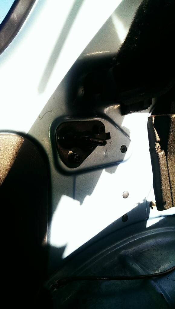

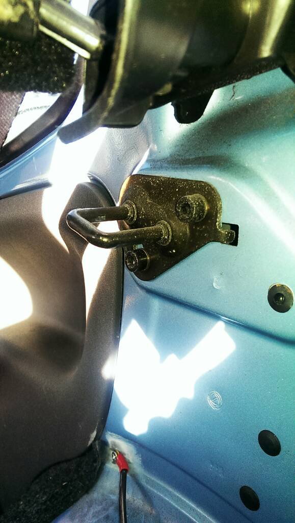

Anyone know which way up the sei seat latch goes? Should the slotted bolt be atop or bottom of the ubolt going through it, pictures prefered.
Making some for cinq mountings to fit my seats properly, been told they need to be shiny apparently.
Want me to take some pictures of mine if I get around to taking the seats out Sunday?
