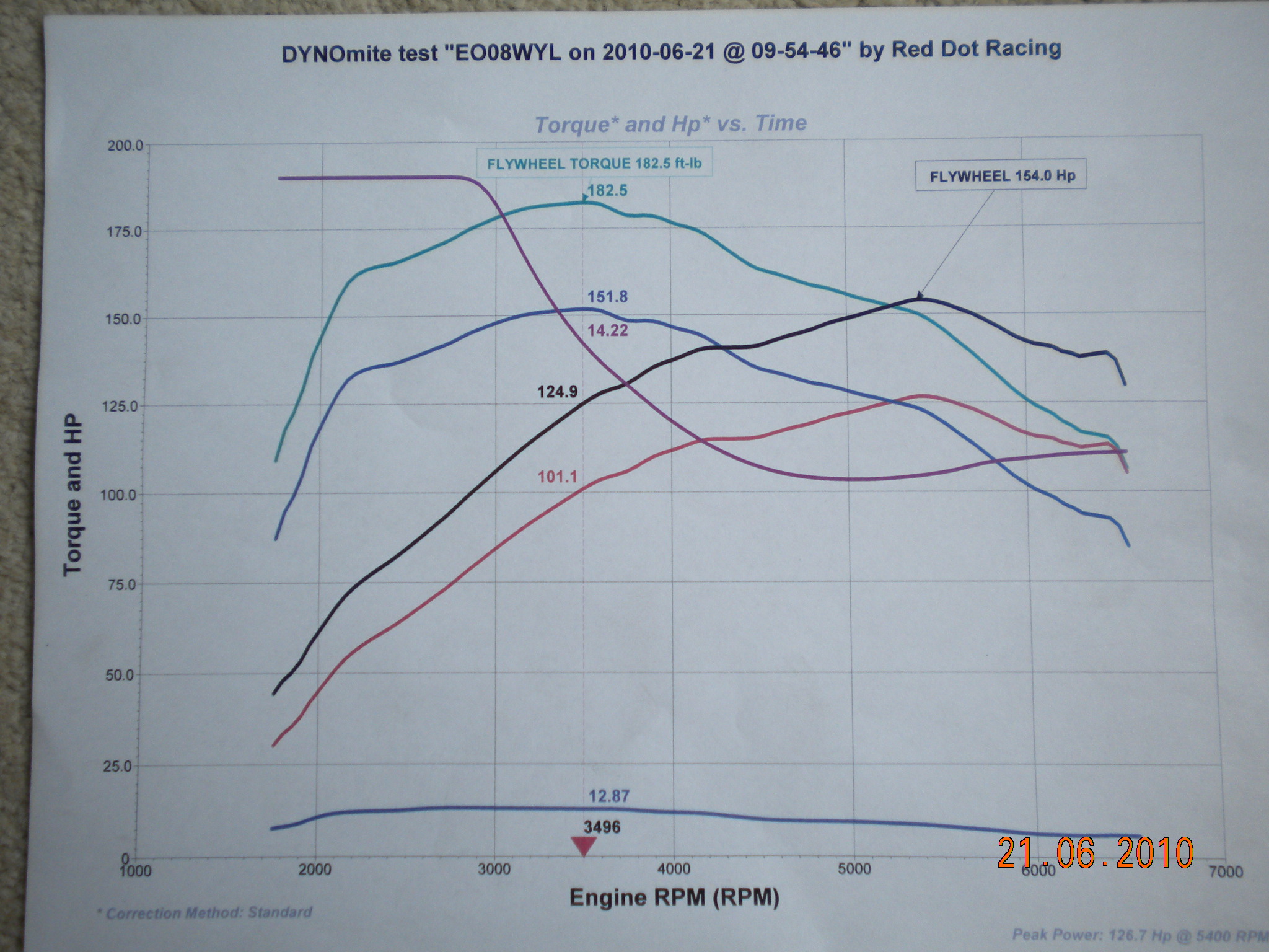

it was quite hot today but here goes..
Before:
12psi and 14psi overboost
154.0bhp 182.5lbs

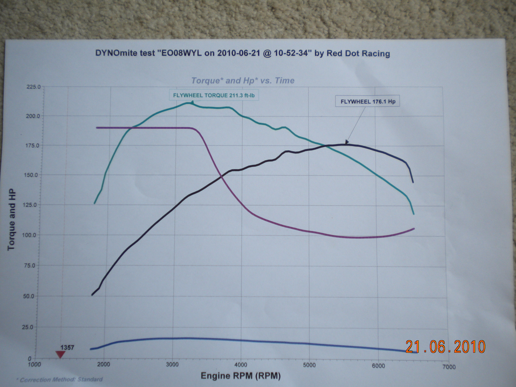

After:
16psi and 20psi overboost
176.1bhp 211.3lbs after
not as much as i was hoping for but it does feel quicker especially in the higher gears.
Those are flywheel figures, you have at the wheel figures mate? Does seem dissapointing with all the aftermarket parts you have on it. :( Maybe you should have gone in search of an SS turbo. :rolleyes:
the only problem with the at the wheel figure is its calculated losses on standard alloys and tyres which i dont have but its 165bhp at the wheels,
