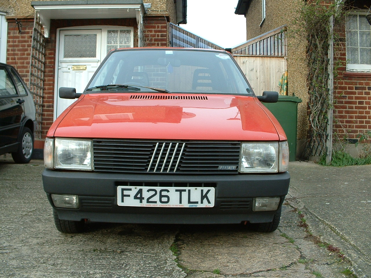

1989 Mk1 Uno 70SX front

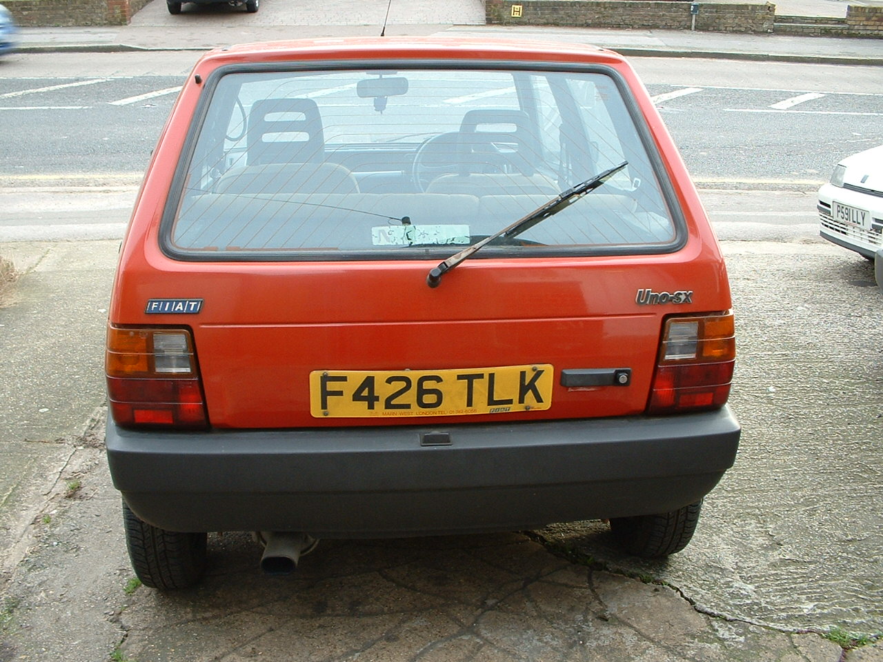

1989 Mk1 Uno 70SX rear

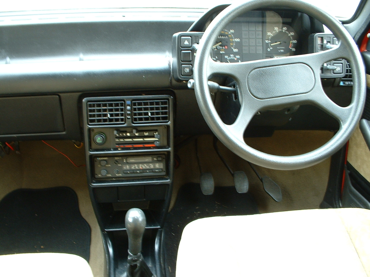

1989 Mk1 Uno 70SX dashboard and console

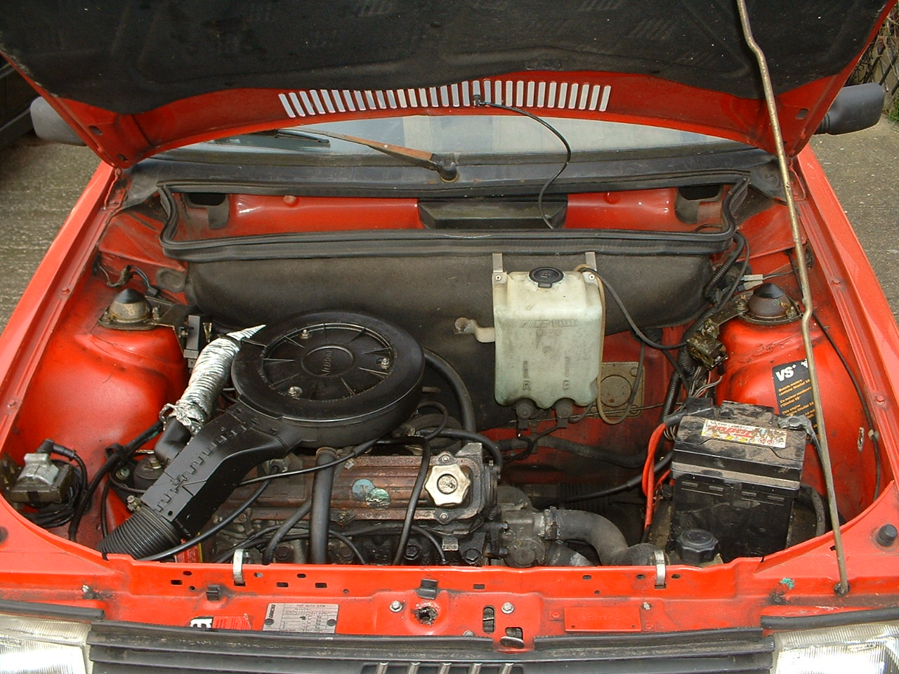

1989 Mk1 Uno 70SX engine bay - 1301cc ohc Lampredi engine with twin choke Weber carburettor. Plus check out the totally rust free suspension turrets/ inner wings :slayer:

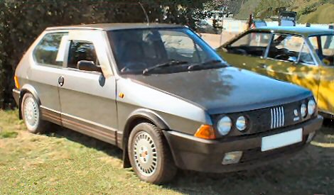

i would love to see it with a set of Strada 130TC alloys :D
Hmmm, there's a thought. But which 130TC alloys do you mean? The four spokes or the later multispokes (the 14" version of the mk1 Uno Turbo alloys)? I'll just have to see what turns up once I've raised a bit of extra cash after my post Xmas spending spree!

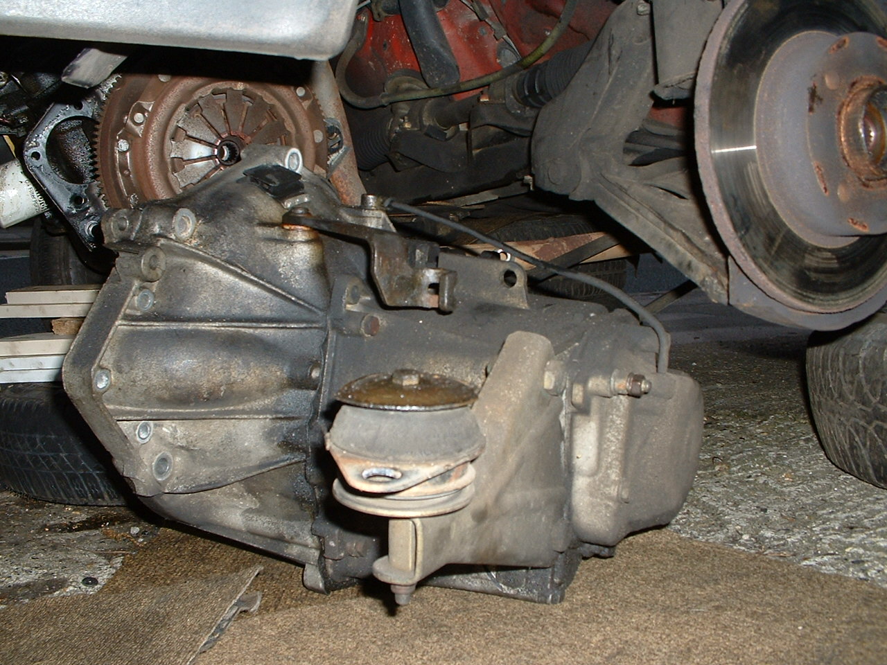

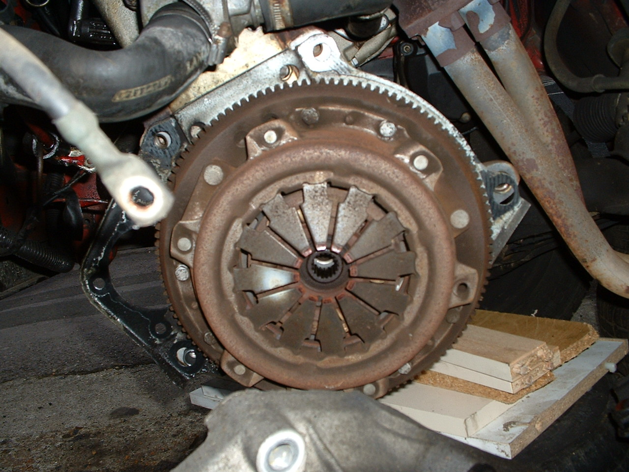

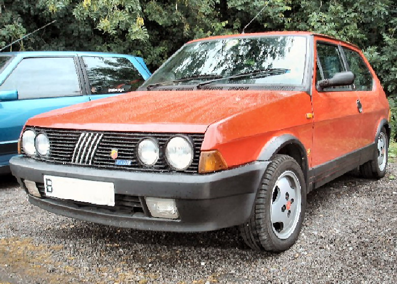

Been working on the Uno the past couple of days. It needs a new clutch so the gearbox has to come off so that's what I've been up to. I've already bought the clutch and also bought two new inner driveshaft gaitors as the two on it looked a bit suspect. Upon removing the driveshafts the gaitors still had "Fiat/ Lancia" stamped on them so I think considering the mileage they're probably original!
I also had a nightmare trying to order a gearbox input shaft oil seal from Fiat. The Muppet Dealer near me was little more than hopeless and unhelpful (parts department that is, the sales staff and reception clerk were very nice). I ended up having to drive all the way to Amersham Alfa/ Fiat and nearly got fobbed off there as well. Luckily they had a parts guy who made a few phone calls and managed to identify the parts I needed. I should be picking them up tomorrow (Wednesday) and can get on with refitting the the gearbox.
Anyway, here's the story today in pictures!
Car jacked up and gearbox/ driveshafts being removed:

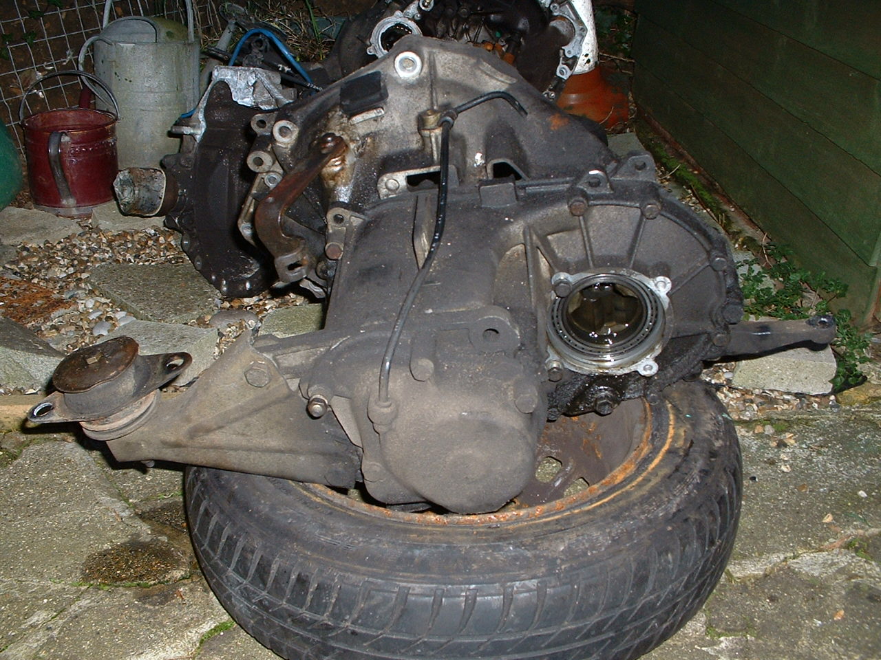

Gearbox off:
Clutch pressure plate. This looked rather rusty and had "Fiat/ Lancia" stampings on it. I'm guessing it's the original!:
Gearbox. A bit grubby but will be given a good clean up with parafin and a hosepipe tomorrow. No signs of leaks or cracks (unlike my original Cinq gearbox :rolleyes:):
So tomorrow I will fit the new clutch, the cleaned gearbox and also change the inner driveshaft gaitors. If I have time I will also fit the driveshafts and attempt to make it look like a car again. If all goes to plan it could be on the road for next week (y)
i was thinking of the multispoke ones, with the polished face :yum:
personal preference...
The red Strada 130 has the earlier 4 spoke wheels, they grey Strada has the multispoke wheels. I think both are in 14".
The Uno pictures show similar wheels to the grey Strada but in 13".
I shall see what is available when I get some spare cash ;)

The gearbox I'm guessing has a single gear linkage input with the 'concertina' type boot, and some rather odd (and rare) fittings to convert the two-rod Uno linkage to fit the one-rod gearbox. One of the pieces is a short link with a tiny balljoint that wears out.
To replace the gearbox input shaft seal, I have a feeling that you must take the gearbox apart. Some models you do, some you don't. I guess you know about being gentle with the removal of the seal from the tube-shaped carrier, something I've messed up before - preferable to cut the seal out with a dremel etc. rather than to accidentally bend or crush the 'tube' - the clutch release bearing slides on that and I've heard of a judder problem that results from damage when the seal gets replaced.
Yup, that's the one. Apparently it's based on the Strada gearbox. When I was putting it all back together I thought I'd lost the bellcrank asembly as I couldn't work out how both rods fitted back on. I soon worked it out after a bit of head scratching. Surprisingly the gearchange is really quite good, but then it only has 36K miles on it!
The outer input shaft oil seal is an interference fit in a metal tube housing that bolts onto the inside of the bellhousing. I had a nightmare trying to find one as Fiat dealers don't even recognise that my car exists thanks to Eper not going back far enough. "Chassis number not recognised" - argh! :bang: After a lot of wasted time and going from one dealer to the next I tried an Italian car specialists - Ricambio in Surrey. The chap I spoke to knew exactly what I was talking about AND had a seal in stock! The local Fiat dealer meanwhile had told me that I had to order a whole gasket kit for £18, which when it turned up had the wrong sized input shaft seal :bang:
The housing for the seal is held on with two bolts and the housing then slides off the input shaft. I thought it was made of aluminium so tried the heating it up over a gas stove trick. This didn't achieve anything other than burning my fingers, so I carefully used a small chisel and hammer to gently prise the old seal out. Well, the inner part came out fairly easily but the outer part was left behind. Judicious use of a hammer and chisel soon got that out.
The new seal was fitted using a hammer and large socket. I wasn't sure if I was supposed to use some sealant on the edges though there wasn't any signs of that when I removed the old one. It's done a few miles now and no signs of leaking oil (furious wood touching) so I assume all went together properly.
