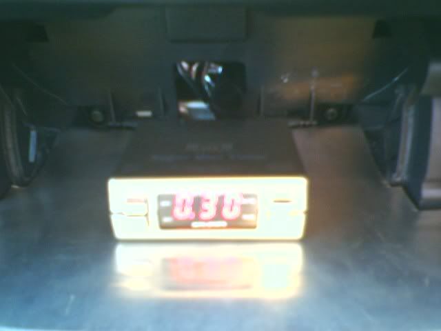

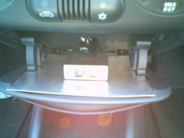

Well I thought it was about time to do summit to my sexy beast.. so here it is!
And b4 you say anything... I moved the fag lighter too :)
I'm rather proud of myself now!

I'm glad you asked that... I was hoping for some guesses.. but as ash had about 10 guesses and wasn't getting anywhere I will tell you.
It's
A
Turbo Timer...
In short.. wen i turn the car off and lock it up and walk away.. the car will run for the pre set time... 30secs is enough for short trips.
Gets some strange looks.. its like a very bad case of after run you can get on old coked up cars!! :) lol

Ok basically.. it keeps the car running after you've turned the key off and left the car.
This is so the turbo has time to wind down and keeps the oil being pumped to the turbo while it slows down b4 the engine stops.
it just saves me sitting in the car for 30 secs with the engine running while the turbo winds down.
All that time im saving :) :p

I would have prefered it if the ciggy lighter was there as standard. I don't smoke so I only use it for tyre pump etc. Would be more handy.
