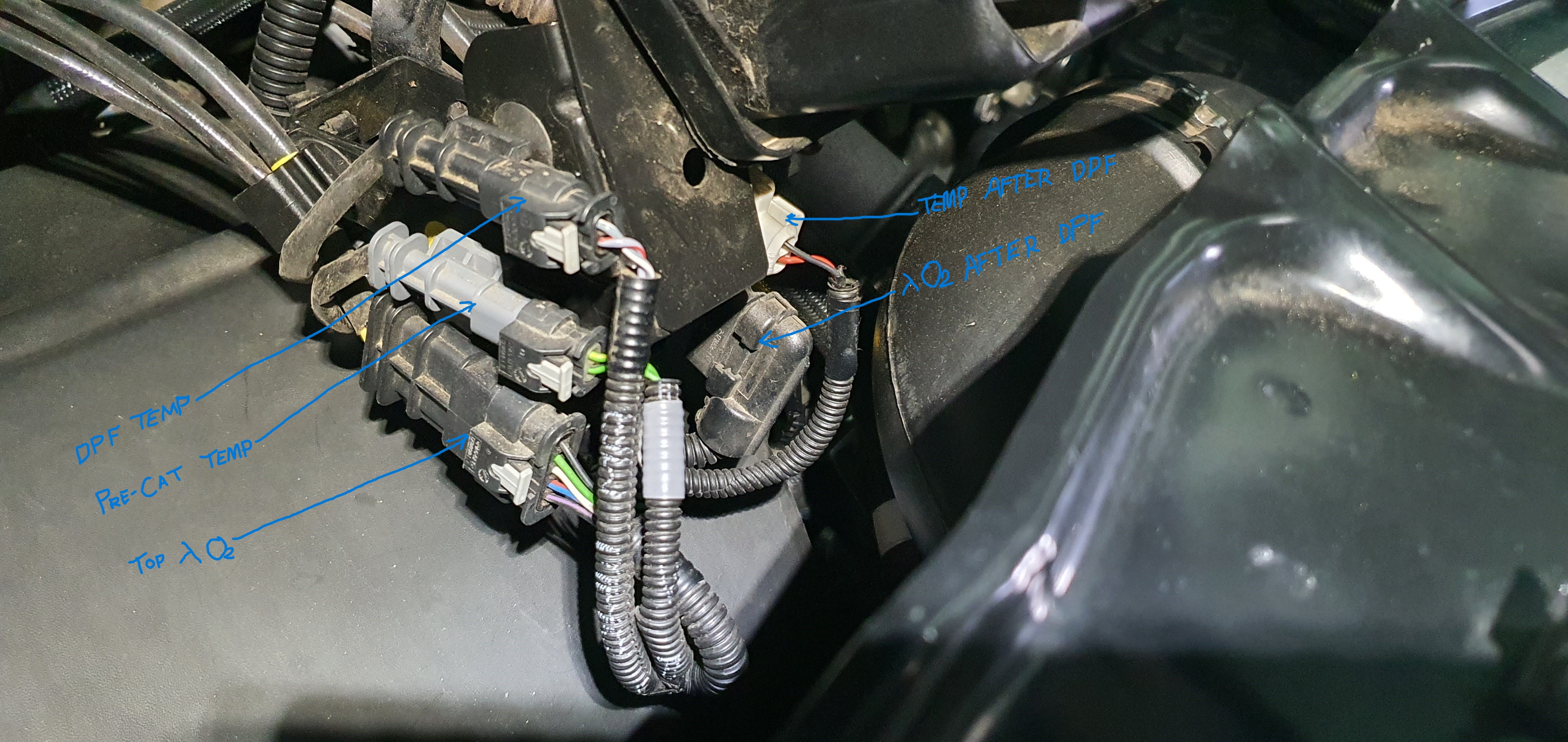

Is this some wiring open circuit maybe ? Again from brake light maybe faulty bulb
What’s also strange today I checked voltage on battery I was 14.2v
Also in Mes but engine parameters 14..2v
But in gearbox parameter was 13.2v which I’m thinking gearbox earth ?

Yea possibly matey but im starting to see a clear picture here I think
I HOPE NOT 😂 but I’m preparing Lambda sensor and the other easy fix if not a short circuit
My other issue P0856 - VDC messages (from CAN)
P2908 clutch sub system was a stored code from my last set of issues with the wiring harness
But put them both together I’m thinking selespeed clutch bearing (Slave cylinder) fail and selespeed actuator
I will keep starting and driving seeing what fault codes I can get on the gearbox
P0856 Traction Control Input Signal
a quick search say electronic brake system. I read that as ABS module in the Ducato. Have you got a scope? if so next step is to check iif there is canbus cominication on SBS and transmition modules ie check canhi and canlo for signals or even voltage if only multimeter.
