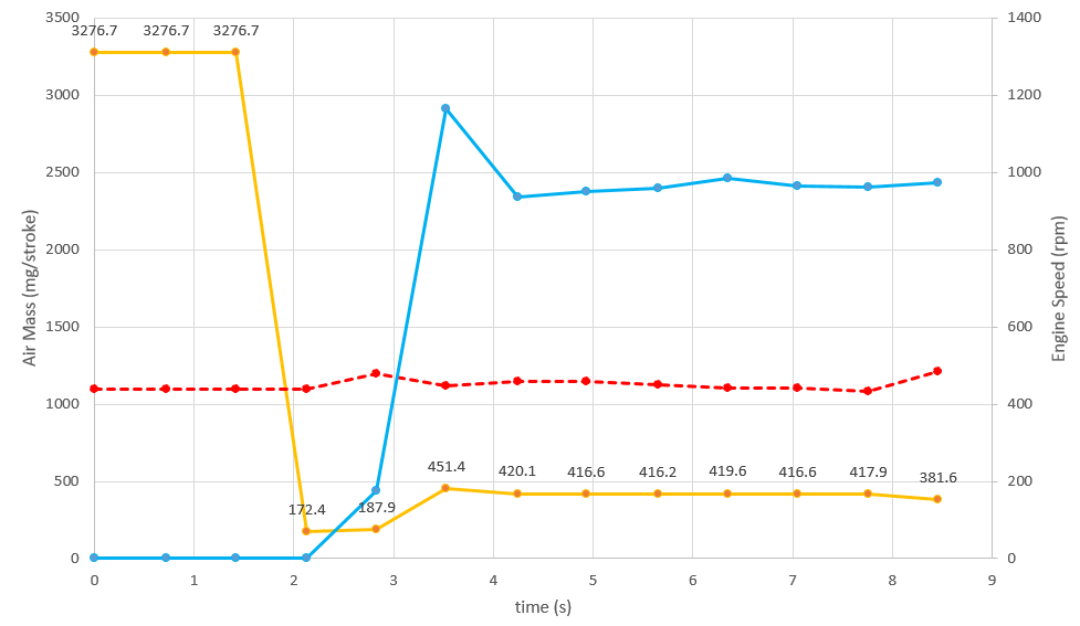

I found some data!:slayer:
I took this recording on my '03 115 jtd so quite possibly different to your 120 multijet. Nevertheless, the airmass at just under 500rpm is 188mg/stroke, then settles out at 420mg/stroke during the 900rpm idle. Your idle airmass might be lower as for some reason my car didn't run egr for some period after start(considered a defeat device now).
The value of 3276.7 before the start is a default value when the MAF isn't seeing a sensible reading.

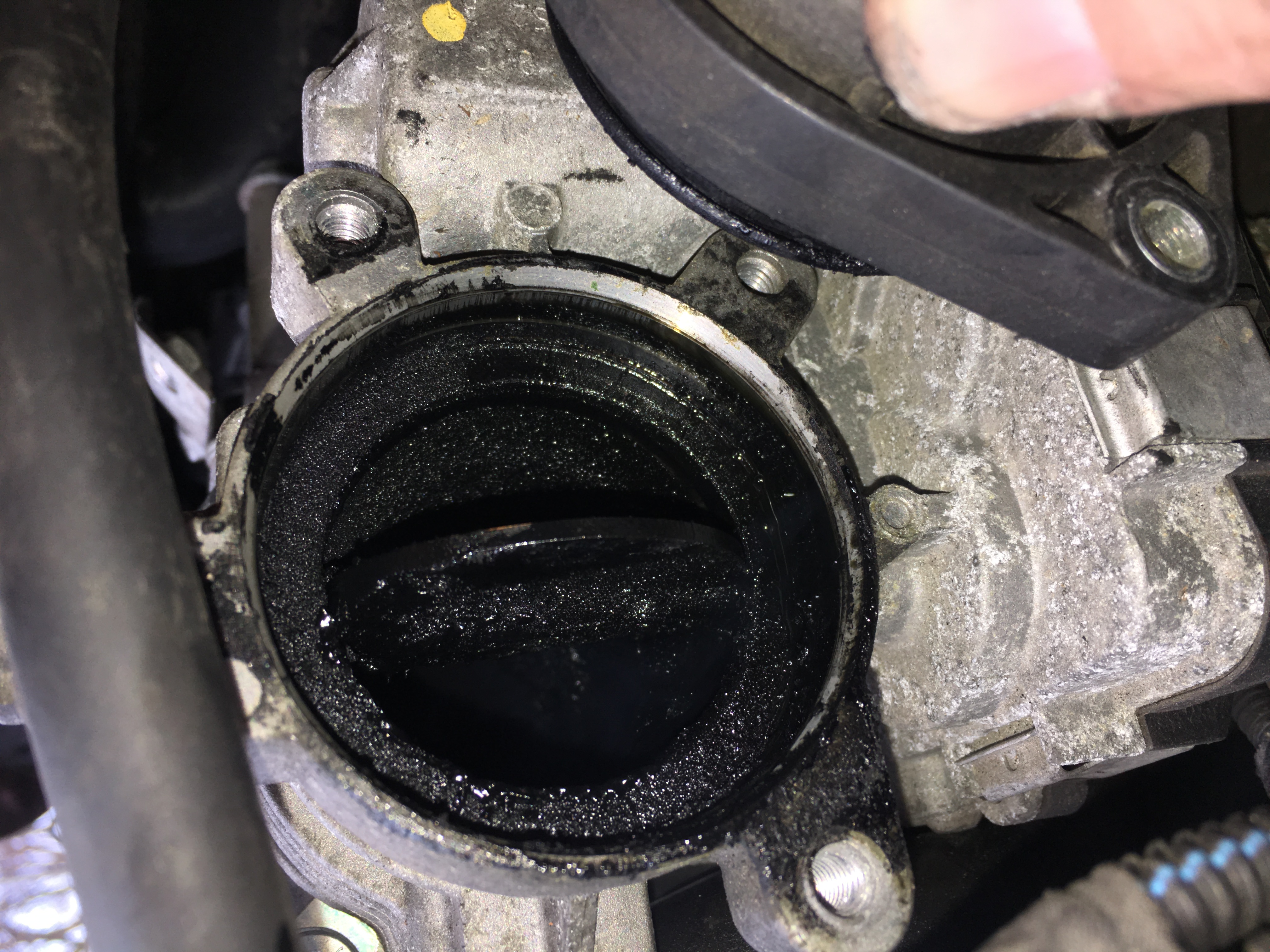

I did get to the throttle valve which is very mucky, more than I expected. I have attached a photo.
Although mucky it still operates (it electric and moves fully open/closed when the key is turned (not cranked).
Although I didn’t get to the turbo, I get a good flow of air from the air intake to the throttle valve pipe, so no apparent blockages in the turbo/intercooler.
Hopefully I will get some more time tomorrow and will get to the turbo and have a look past the throttle valve/erg for blockages.
