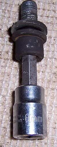

The two 13mm headed bolts secure the caliper to the carrier, the two 8mm headed Allen bolts secure the carrier to the swing-arm.
There's no need to remove the carrier to replace the pads.

I think the alley key fittings holding the carrier might be 10mm.

Definately 8mm, on mine anyway...

Sorry BikeDoc, 8mm it is!

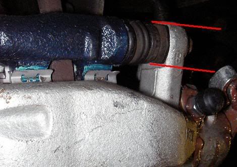

Another bad bit of design is the hose connection to the caliper.
It's just a straight section of rubber pipe, the union screws directly into the caliper body (you have to spin the caliper onto the pipe), and then when you attach the caliper to the carrier the pipe is twisted, it's only approx 4" long, so even an 8th of a turn or so causes it to twist quite badly :mad:.
I didn't have time to check if it's possible to untwist it by loosening the other end, where it joins the metal pipe section, they usually have a seperate union nut connector.
It was twisted when I removed it, so whoever fitted it should have sorted it really :rolleyes:

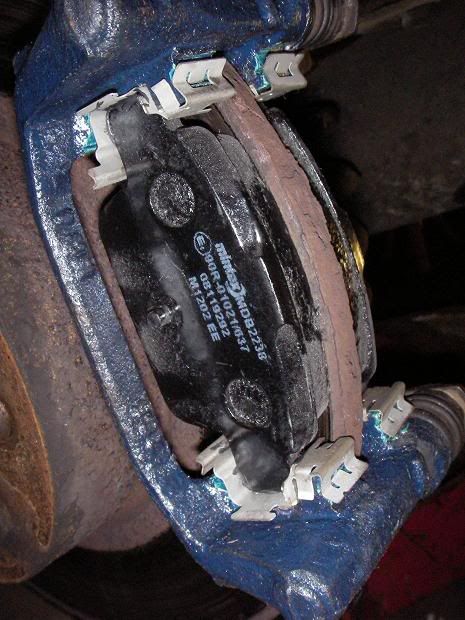

Caliper carrier fitted with freshly cleaned bearer plates, the tabs (arrowed) go to the outside, i.e. away from the disc. They're handed, four left~four right.
New pads in place. The bearer plates are sprung, so you need to slot one tab of the pad into one of the plates (I found doing the top one first easiest), push against the plate and slip the other tab into the other plate, the tab on the plate helps but you may need to push the plate by hand/screwdriver to get the pad in.

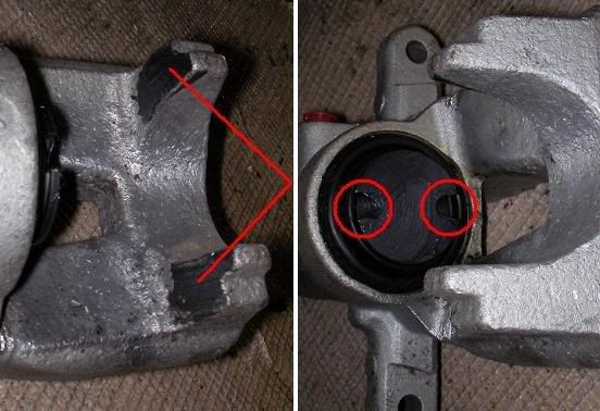

Put some brake grease (usually comes with new pads), or use CopaSlip/Neversieze/Whatever on the piston face and inside faces of the 'legs' of the caliper.
Note the two cutouts on the piston face, they need to be aligned as shown, as there's a 'pip' on the back of the pad (see second pic) that will foul on the piston face if the cutouts aren't aligned.
This shows how the flats on the end of the sliding pins (where the caliper bolts on) need to be aligned, so they don't foul on the edge of the reccess on the caliper mounts. The flats will hit the edge of the reccess to stop the pins revolving as you tighten the caliper mounting bolts.
