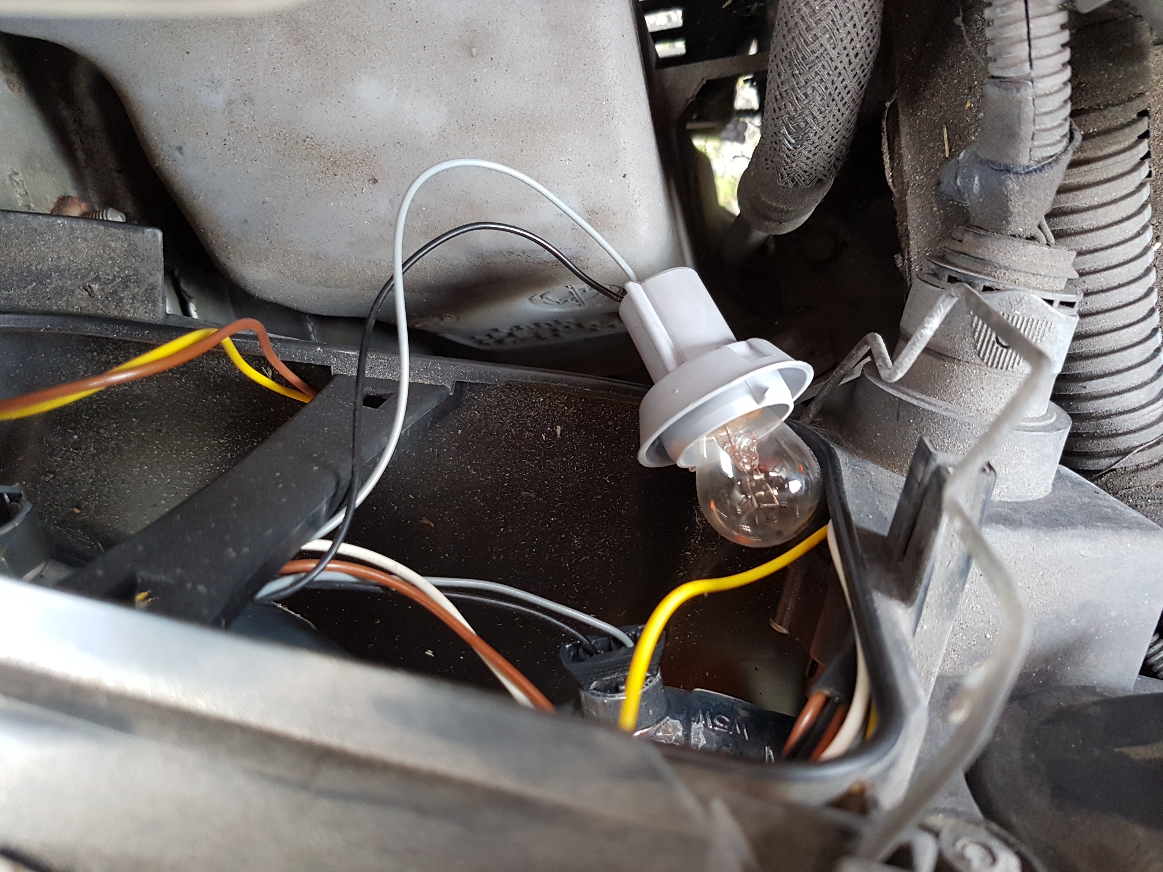

whilst looking at the headlights i noticed a random grey bulb holder just hanging down with a bulb inside the dust cover, looks like a stop and tail. no obvious place for it very odd. the folding mirrors are not working is t the fuse possibly?
Is the loose bulb holder in the headlight or the tail light? Your description is a bit ambiguous!

Random bulb was in drivers side headlight
Pic
