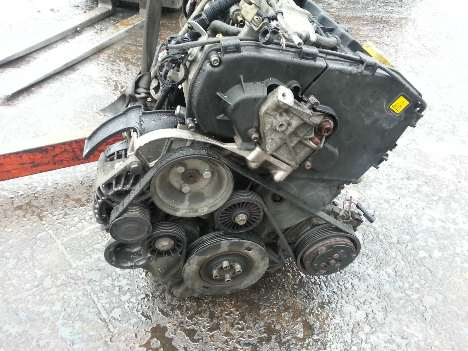

Hello widemouthfrog, yes sir I still have the Multipla. Has been running well till last night when the fanbelt/aux belt snapped a few miles from home.
Had fun trying to steer round corners and roundabouts w/o power steering!!! That's why I logged in. Off topic - but how difficult/easy is fanbelt to fit? Can you direct me to the right thread if there is one?
Good to hear it's still going strong, especially after all the trouble you had with the clutch.
Remove OSF wheel and the inner wheel arch liner, then this photo shows you all you need to know:
https://www.fiatforum.com/multipla/445862-cambelt-buggered.html?p=4227426
Before replacing just the belt, check that the tensioner pulley (the black plastic one in the photo, with the spanner on) hasn't had it. Give it a spin and a wiggle to check for free movement. Also, open the bonnet and carefully sight from the front of the car (shut one eye type of thing) to line up the top edge of the black pulley with either the other (larger) black plastic idler that's mounted on the block further forward of it, or the bottom of the larger metal pulley that's above it.
Very often the reason for aux belt failure is a knackered tensioner or the plate/bracket that holds on to it bending over time, allowing the pulley to twist so that it points down/to the left when viewed from the front of the engine. This makes the aux. belt slide away from the engine, eventually jumping ribs and ripping itself to pieces.
If the idler pulley is also knackered and bent out of line, that's easy to replace too.
