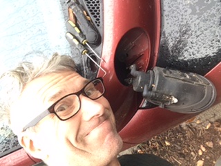

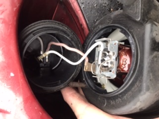

Thanks again, Widemouthfrog for your reply, link and suggestions. If anyone else wants to change the beam bulb for a first generation 2001 Multipla (ok not the very first!) then it IS an H3. My baby is more of an axolotyl btw...l
