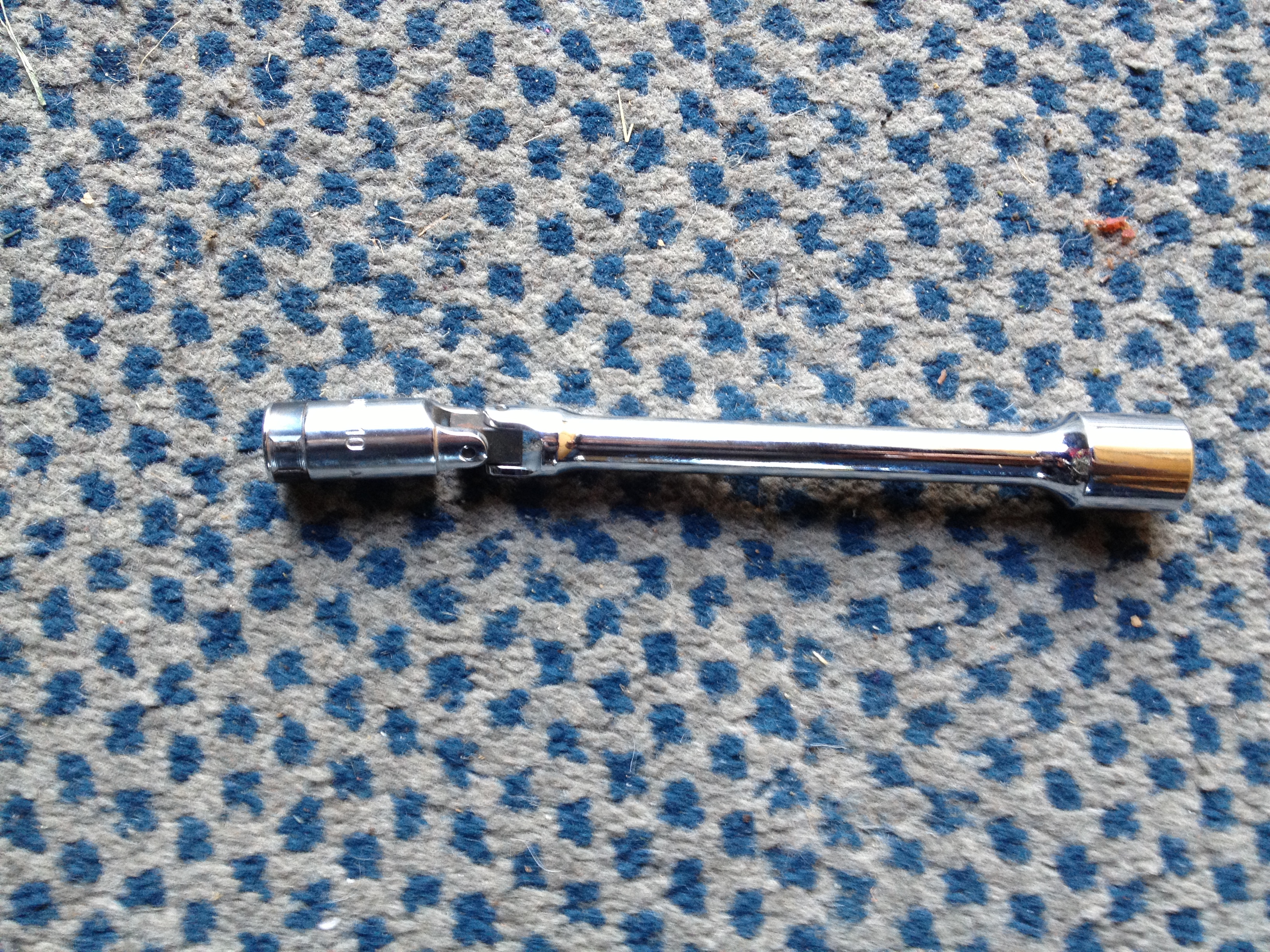

Here is a pic of the tool . It is a 3/8" drive and I had to use another short extension to get the right amount of travel into the plug socket.

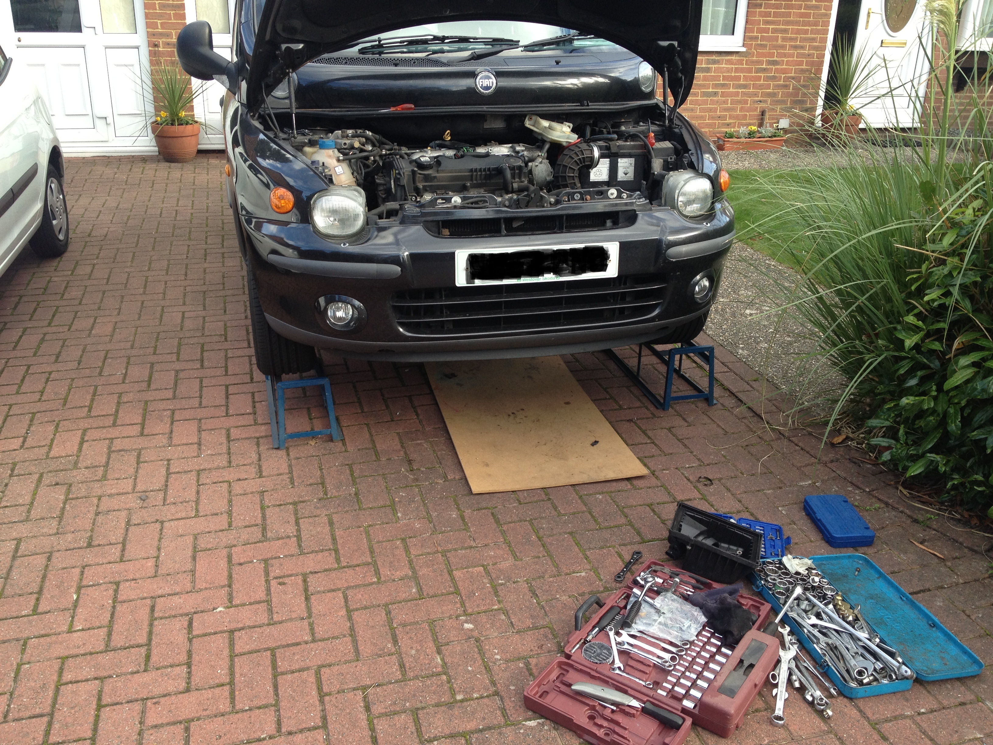

I also recommend you put the car on ramps, certainly saves on the old back and easier to find things you drop on the floor

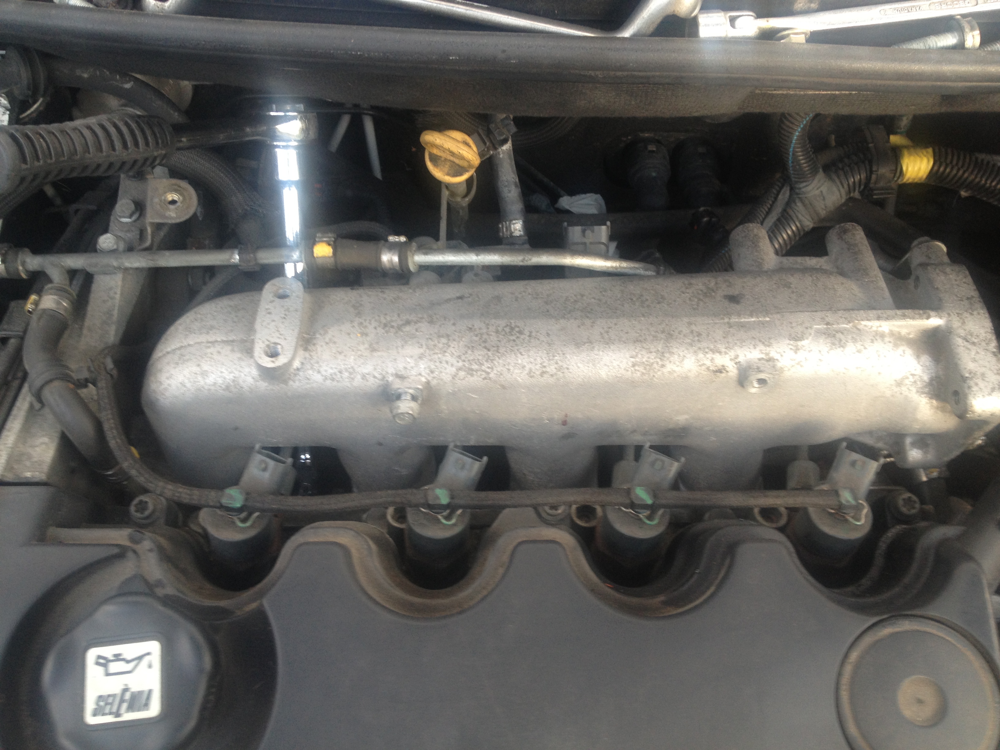

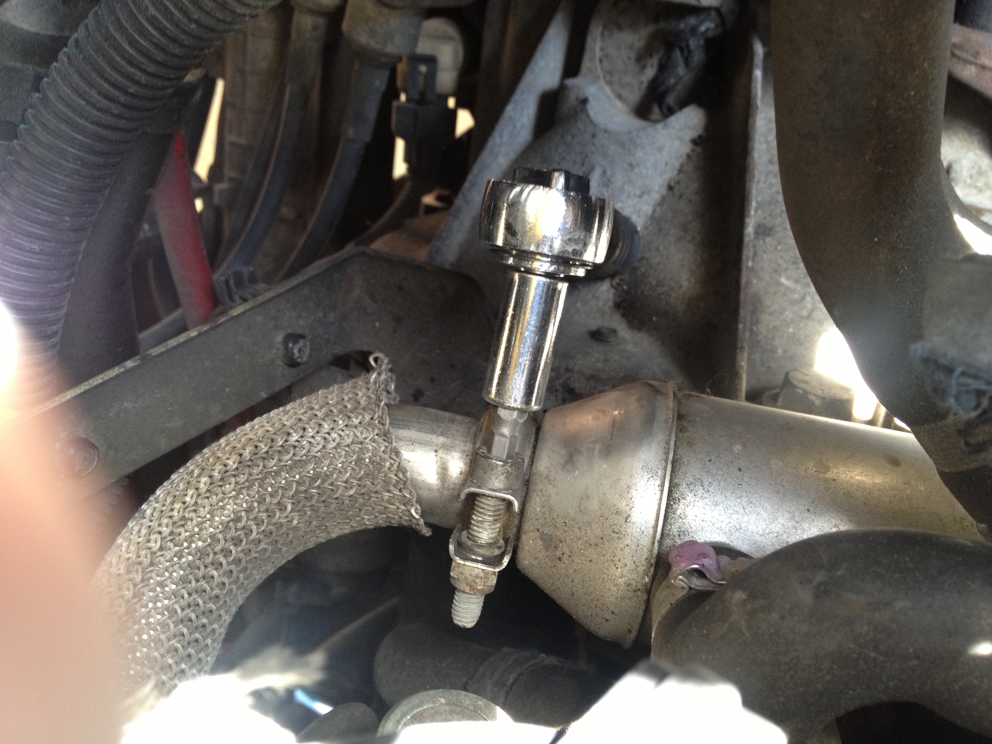

Here is the tool with extension working on plug #1

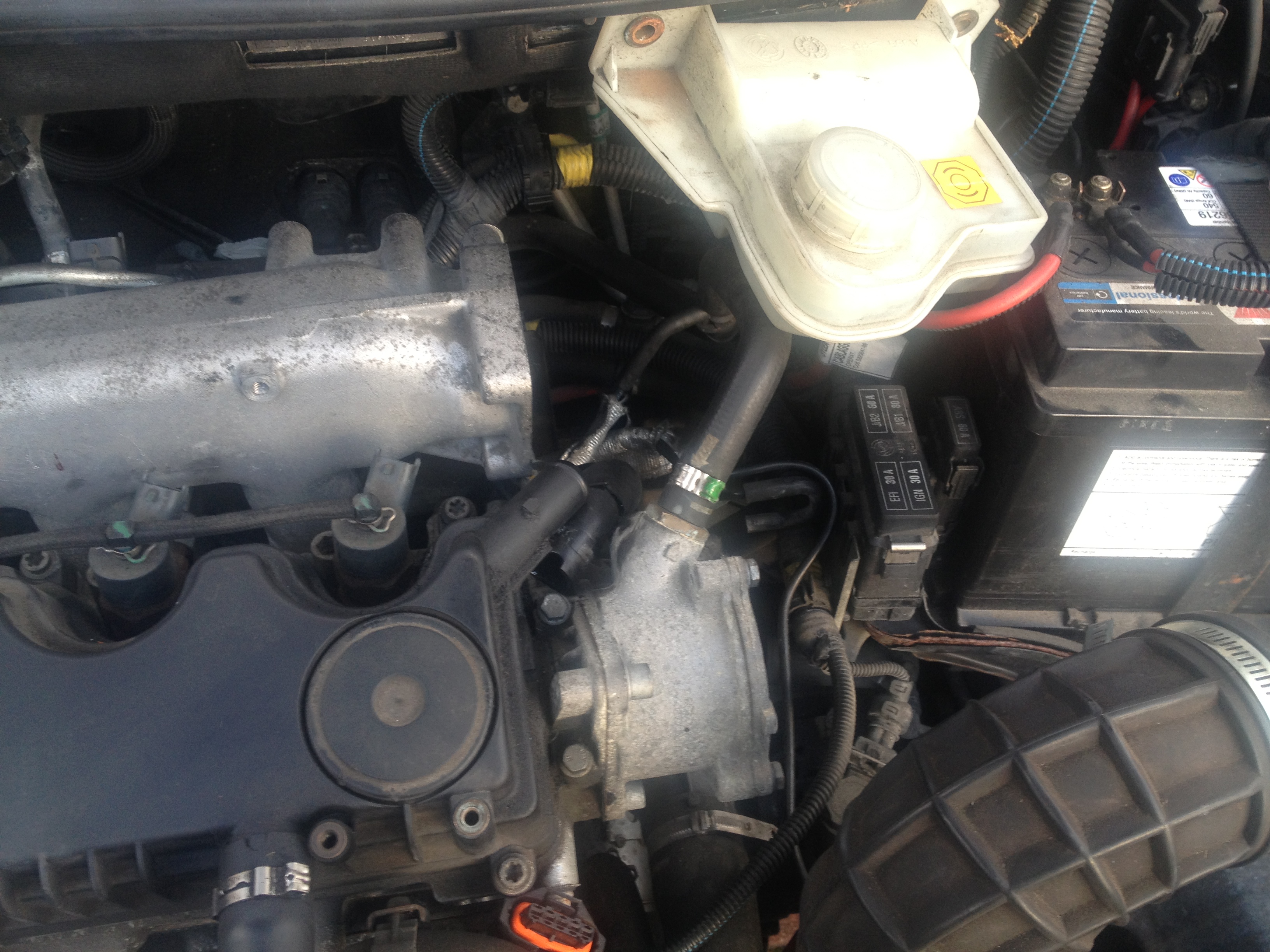

There are two pipes coming out the EGR valve, don't even bother trying to get the bottom off from the EGR but rather take it off by removing this flange

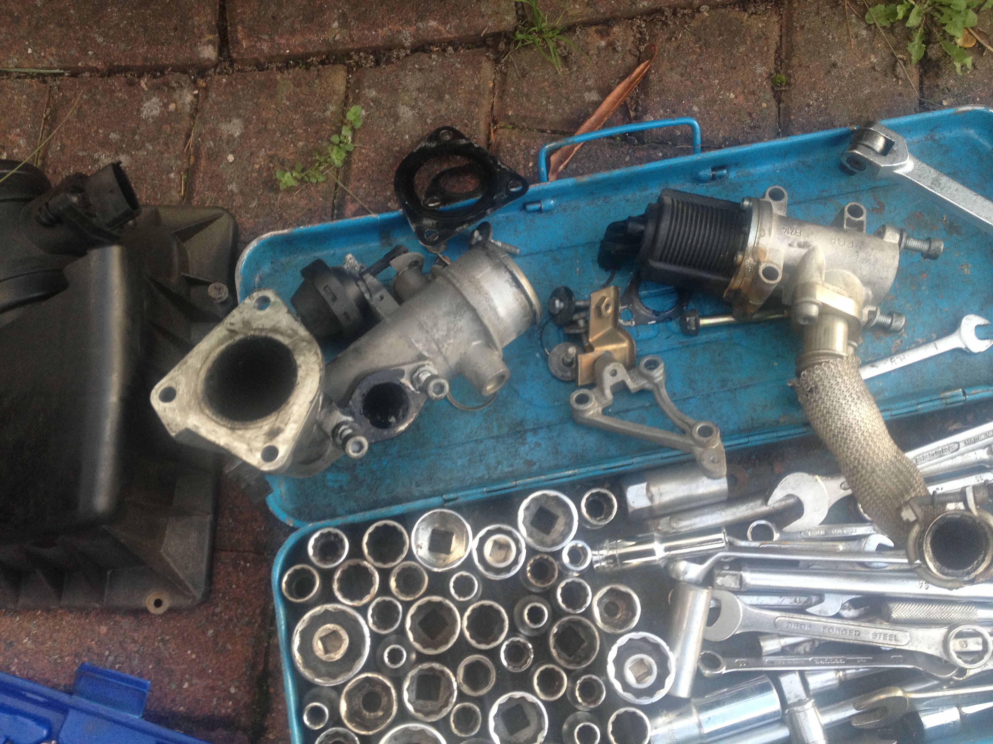

All the stuff removed
Good luck and make sure you have some fire hose clamps available for the oil breather pipe and the air intake pipe that connects to the bottom of the plenum housing. Fiat have used one time use clamps which you obviously need to break to get off.
