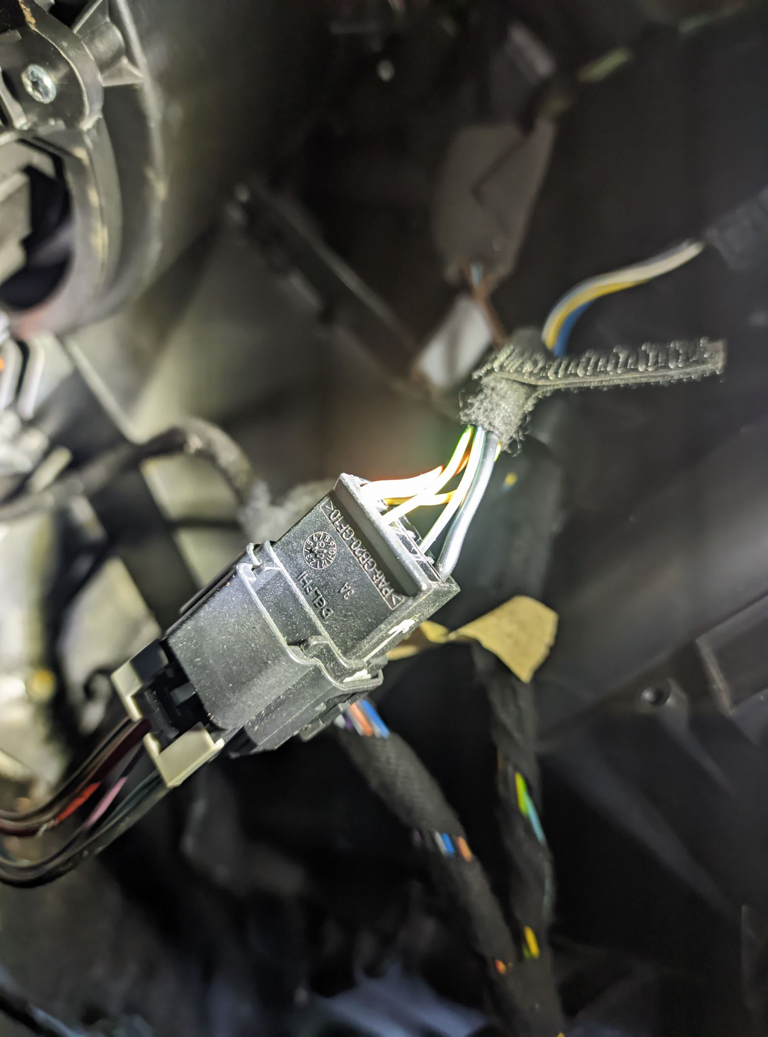

Just registered to say that in 2025 this is still working. Our connector only had 5 wires in, and 5 wires out, and was accessible without removing the central footrest. I rewired the two larger wires, I assume carrying the power. This was sufficient to get the blower fans working and the external temperature to reappear. I have attached a picture of what the connector looks like, in case it helps anyone who still has a multipla :)
Thanks
