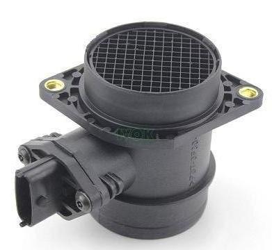

3 years later and I think I've found the problem...
Engine has been racing again at idle - surging up to 3000/4000 rpm - and worryingly when I'm driving along.
Today I disconnected the MAF sensor - result: engine racing gone, idle normal about 1000 rpm, and if there's a drop in performance it's barely noticeable.
Local parts place quoted £71 + Vat for Bosch replacement, Ebay £25 delivered. Wondering if it's even worth replacing as I can't tell any difference with MAF disconnected. Might even be worth attempting to clean? Must be one of the most accessible parts on the car to remove/replace - at the front (and top) of the engine bay and just 2 x 10mm bolts and a hose clamp to undo...
This might also explain the engine warning light coming on intermittently.

Well you get the award for coming back and up dating us as to what happening, thank you
