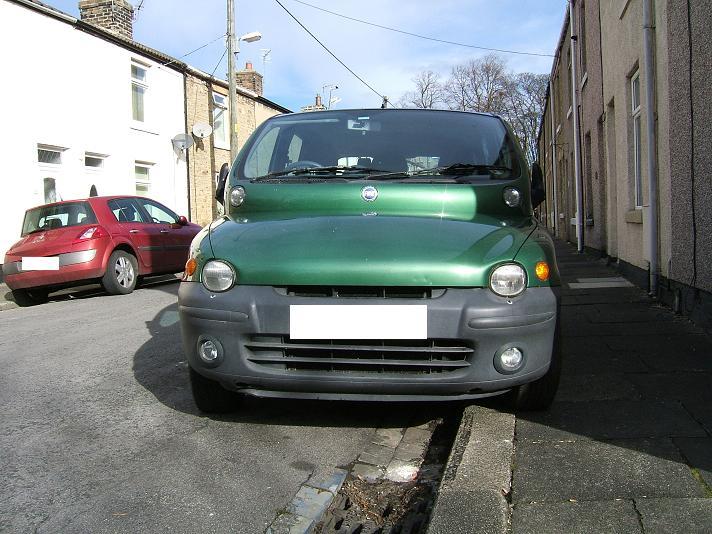

Update: Another one bites the dust!
My dearly beloved Multipla has gone to the knackers yard. RIP 2001-2019.
Too much to repair.
I got 70 quid and a lift home in exchange. Feel like I've lost a leg/old friend. I am quite sad. :cry:
Found a £400 quid Citroen MPV today online, arranged to view, decided to have a wash and shave first - got gazumped.
On my way in the taxi the owner texted me the car had gone. Just to rub salt in the wound I kept seeing
identical cars driving around as I now *walked* about town on my two legs. I wondered what they were for.
So for the time being - unless and until I get another Fiat - I would like to thank all the Fiat forumers
for the brilliant help I have received over the last 5 years, particularly on my epic clutch renewal project.
I will keep an eye on the postings from time to time to see what is going on.
So for now, arrivederci (goodbye until we meet again).
Mark
Former Fiat Multipla 1.9 JTD owner
