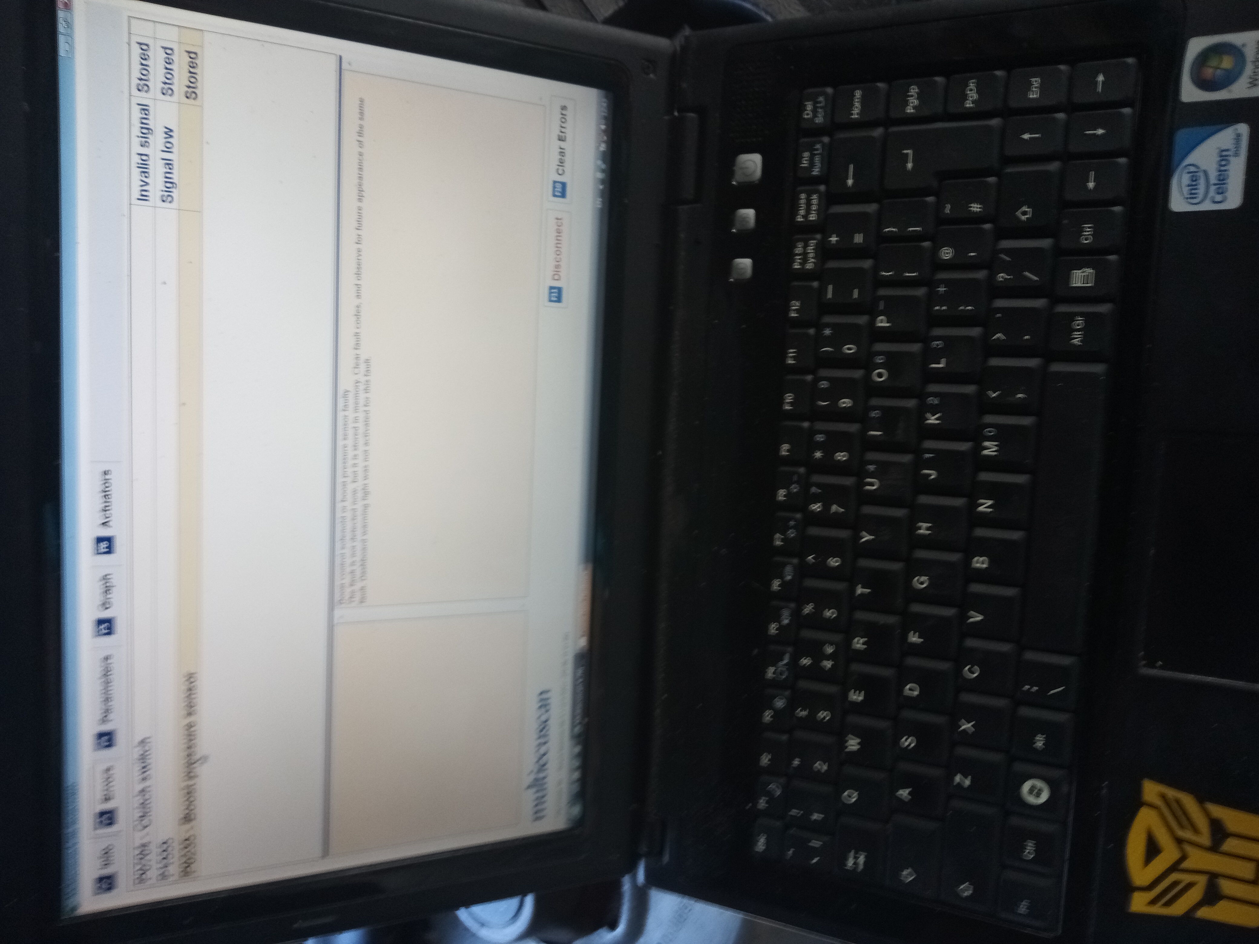

Just purchased a licence for Multiecuscan and ran it on my coupe 20v VIS . firstly it said com1 would not connect. I fiddled around an eventually it started to scan. When completed I tried to generate the report but that failed. I dont know what I did but it brought up 3 codes. P0704 clutch switch. P1555, P0235 Boost pressure sensor. Can anyone confirm these codes in 'layman's terms. I cleared the codes but injector light is still on. Maybe I'm not using it properly !!!

Sadly you have not actually connected to the Coupe's engine ECU
The image/errors you see are for the SIMULATION results when simulating connecting to the Fiat Coupe 98 and Coupe 01 engine ECUs
In simulation mode there is a little flashing red message on the bottom line of the MES screen saying "SIMULATION MODE!!! THE DATA IS NOT REAL!!!".
Your screen shot is not clear but the shot was when the message was not present.
