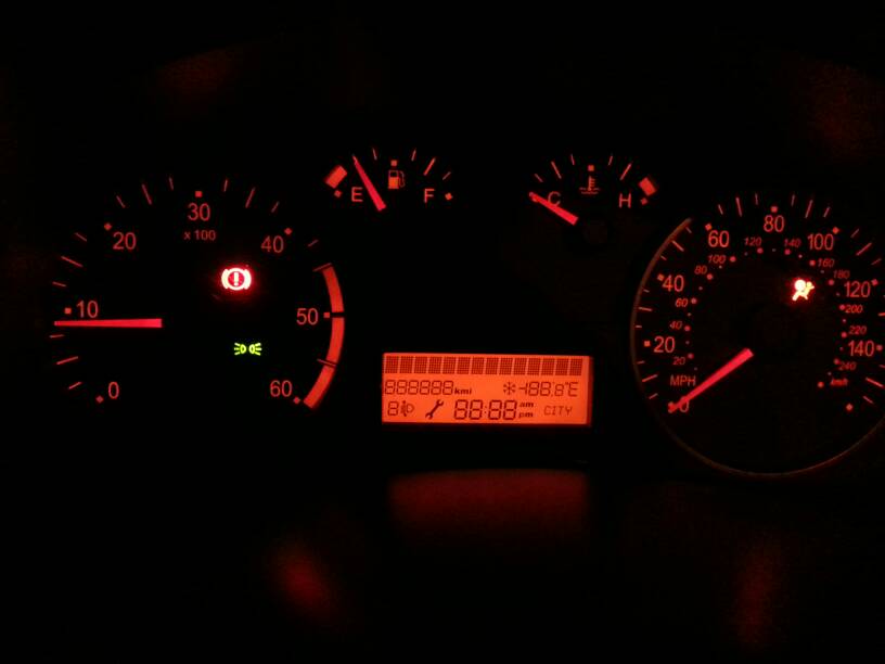

Bought myself a fiat stilo yesterday 2002 1.9tdi.
I noticed on the way home that the multi function display in the centre of the dash is stuck on. its showing black squares where didgits should be and 00:00 's etc. but no actual information. could anyone shed any light on this for me as im new to fiats and dont have any manuals etc to explain any fix or anything.

Bump with picture of the problem I tried to describe guys... 1364337206408.jpg
Looks like it's in "Test the display mode" but that can usually only be done with diagnostic equipment (Examiner, FES, MES etc.)

No... it would only go to display test mode for a few seconds while the diagnostic equipment activated the test. As soon as the test has finished, it would revert to normal mode.

my guess is a fault inside the cluster - as Davren said it looks like it's stuck in the display test mode (which normally is performed together with a gauge sweep and led lamp test ) - they tend to get faulty after XX years and the fault symptoms can vary depending on the location of the fault cause.
I think i will be able to repair your cluster but you would have to send it to NL .....
I also can reprogram another cluster with a lower mileage if needed , with the right equipment that's possible - with Examiner, FES/MES you can only adjust it upward.
Any guesses at how much it would be to get sorted officially?
About £150 from what I've seen. Could pic up a used replacement for about £30 though and dealer could match the mileage for £40-70 or if you want to invest in MultiECUscan.net software you could do it yourself, or even possibly find a local member with the software who could sort the mileage out for you for the cost of a beer possibly.
