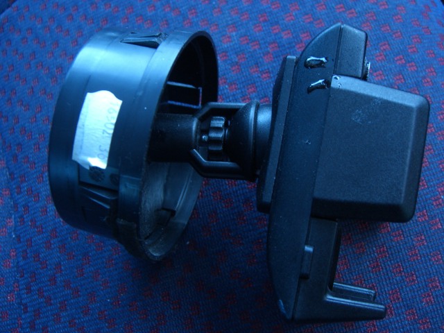

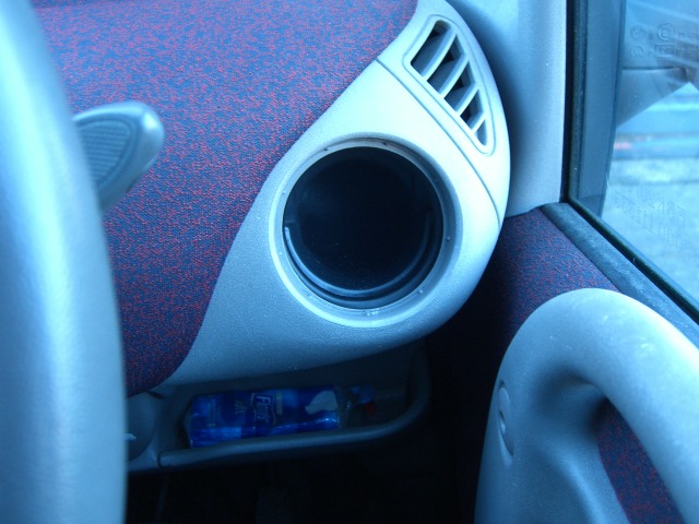

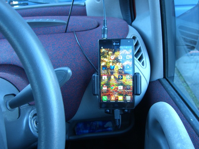

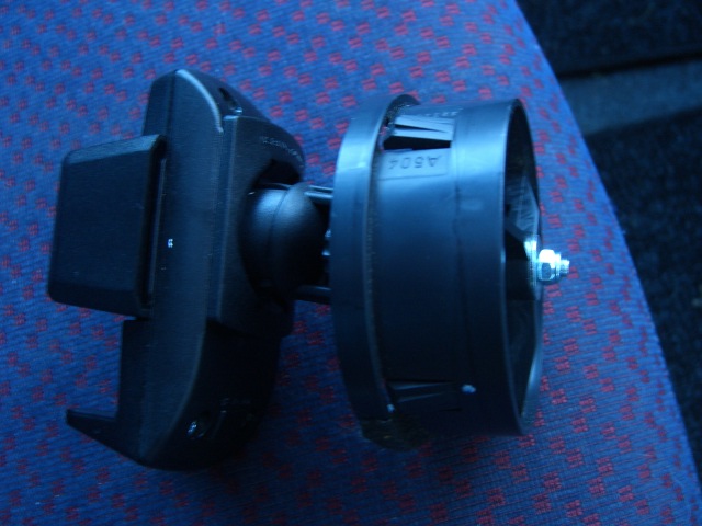

Bodge something! :slayer: I made a mount using the standard air vent. The vent unit pops out easily and the grille unclips leaving a hole through the middle. I cut down a generic phone holder and used araldite to fix a bolt on the end. This bolt goes though a bit of wood (painted black) I shaped to fit and through the hole in the vent unit and the whole thing clips back in to place. No damage to the vent parts and can be returned to standard any time.
Power and audio leads are routed to come out from the glove box and so can be stowed away when not in use.
