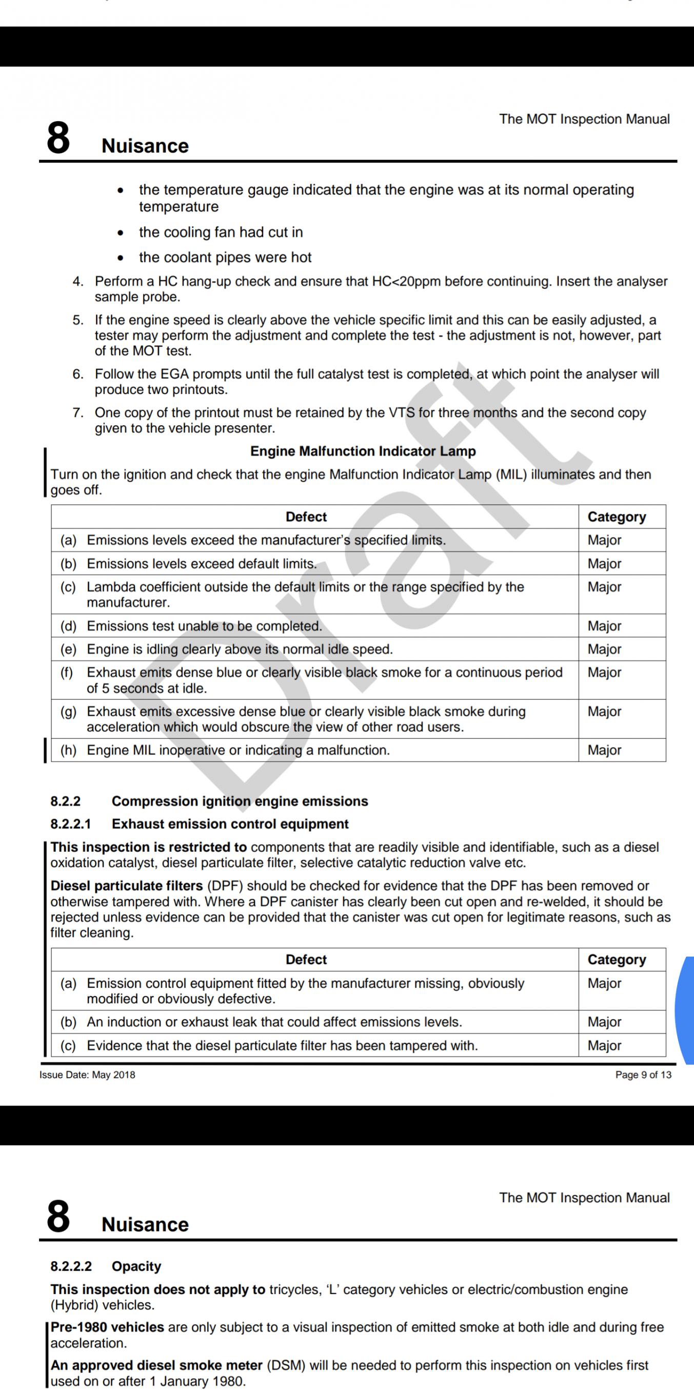

Having read them I fail to see the shake up..minor items = advisory notice major = fail, and they still aren't actually testing for the presence of a DPF on a diesel and will be checking by revving the car in neutral when it will be running lean.
Quite a few will fail on fitting afterternarket hid kits to lamps that can't take them
Or people who have had the dpf cut open to remove the internal filter element will also fail
Not currently a fail as it can be proven it was removed and there's nothing specific about dpf filter in the guidelines
Will be a fail if the dpf has clear sign's of being cut and rewelded unless owner can prove it was done for valid means
That's an interesting draft..
I still see no difference, owner says Yes it was blocked, it was opened to clean it then reinstated..garage says I don't beleive you can we take an angle grinder to the underside of your car please sir to prove you are a liar?
Major defect if your car exceeds the manufacturers figures. Can't see that staying in..pretty much every car for the last 15 years rendered untestable.
Unless of course they are going off unpublished figures.. which would be interesting in itself.
Also the references to on road acceleration are intriguing, does this mean a road test will be carried out or are they still pretending that revving the car stationary is the same as travelling under load?
Maybe they'll all invest in expensive rolling road technology...
Or just give it a rev for a bit, then tick the box?
That's my thoughts..which is about as effective as taking the petrol emissions probe test with the engine off..
Can't escape the feeling that for all the apparent change..it'll be business as usual unless there's a change in the equipment used for testing.

The new test will fail a DPF equipped car that "emits visible smoke smoke of any colour" from the exhaust. This is in addition to meeting the opacity limit for the car. The car limit is on the VIN plate. For a 2008 Croma 1,9 16V the limit chances from 3 ti 0.24 with the new test. A car with the DPF removed is unlikey to pass this test. Time will tell.
