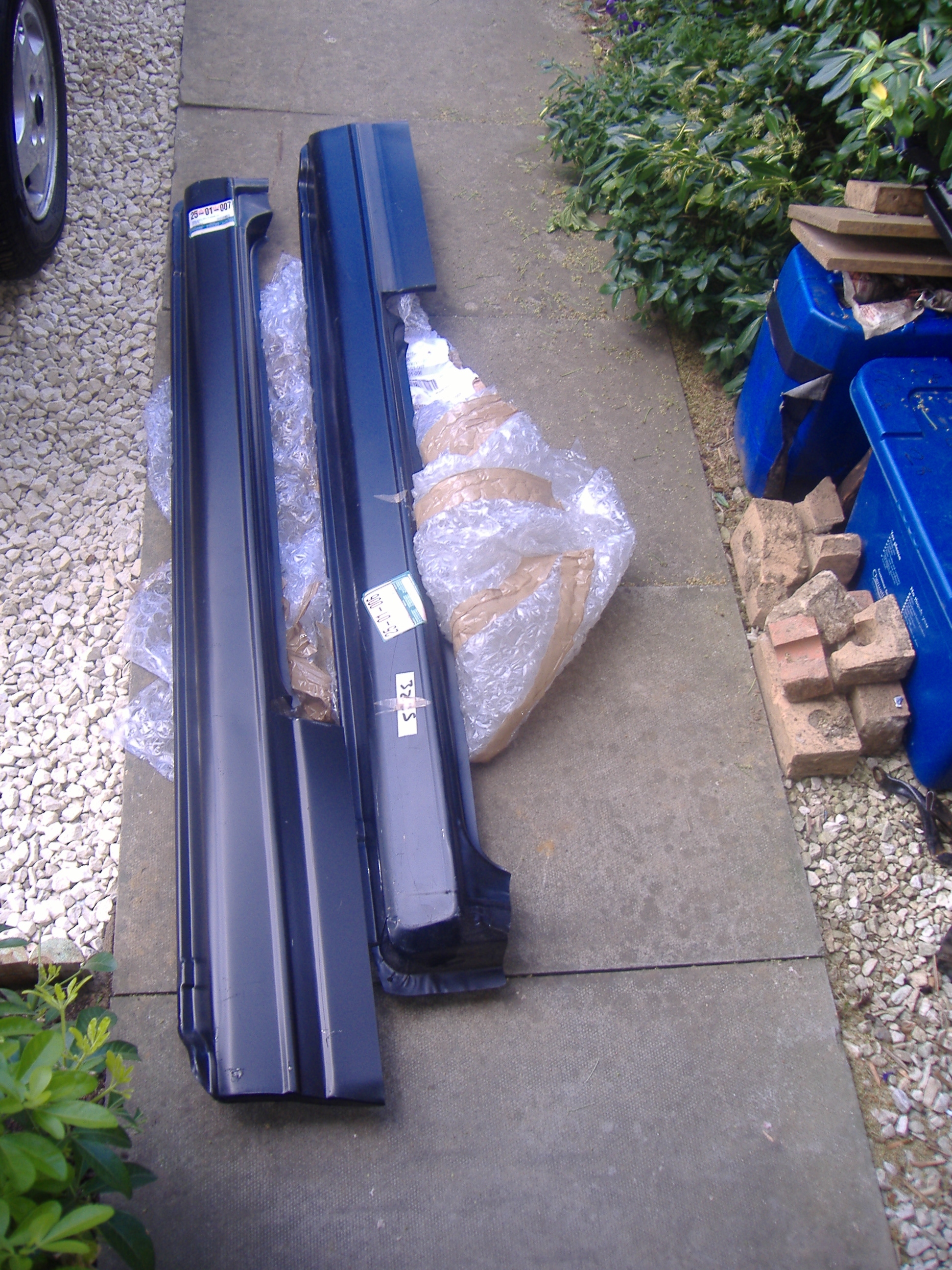

Well the sills arrived this morning (pretty rapid seeing as i ordered them Tuesday afternoon!)
Think about £40 all in, from all-car-parts.
'tis a shame in a way i spent quite a while fixing up the drivers side doorstep bit, and that comes on the new sill anyway :cool: (live and learn hey)
