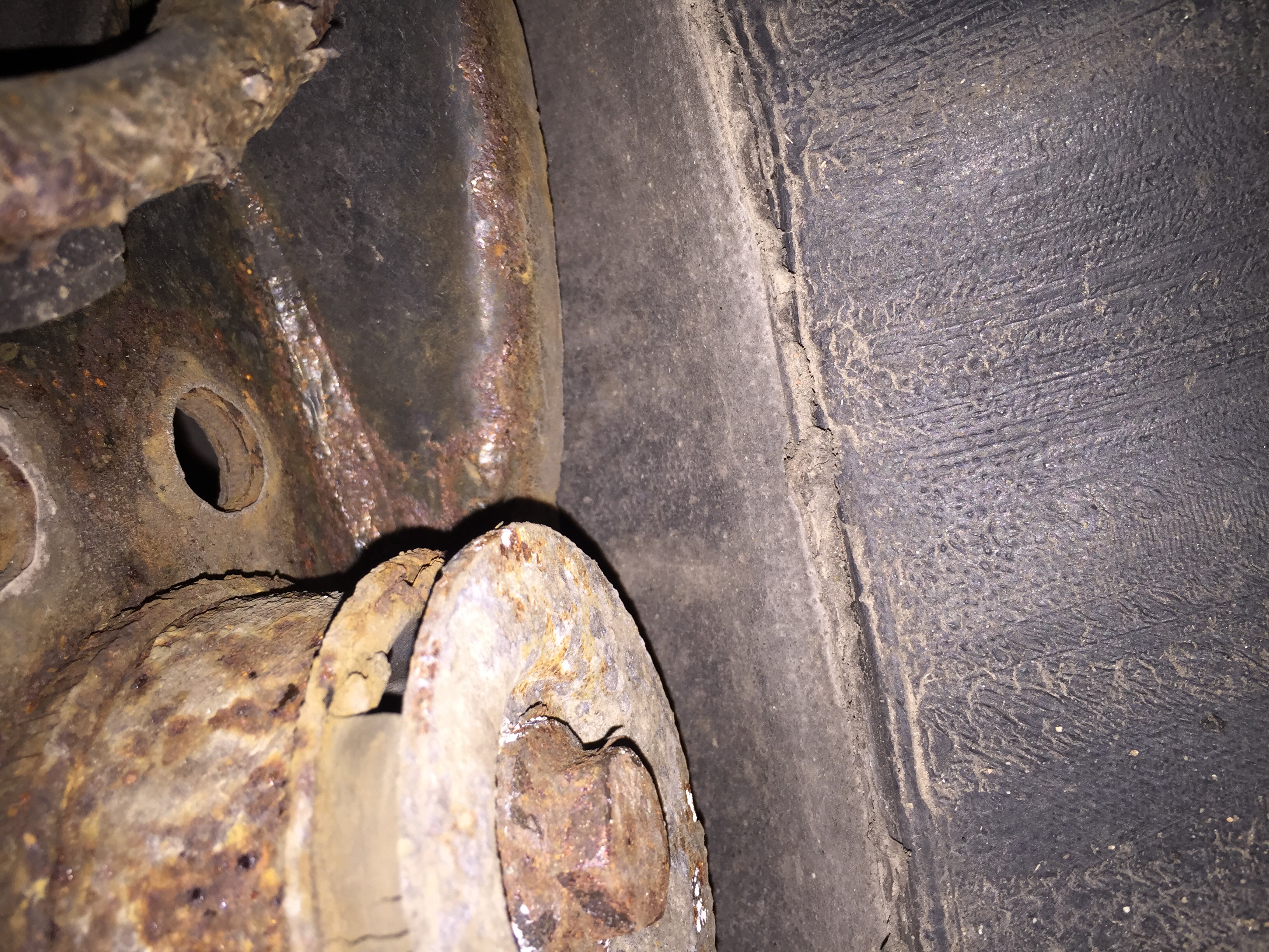

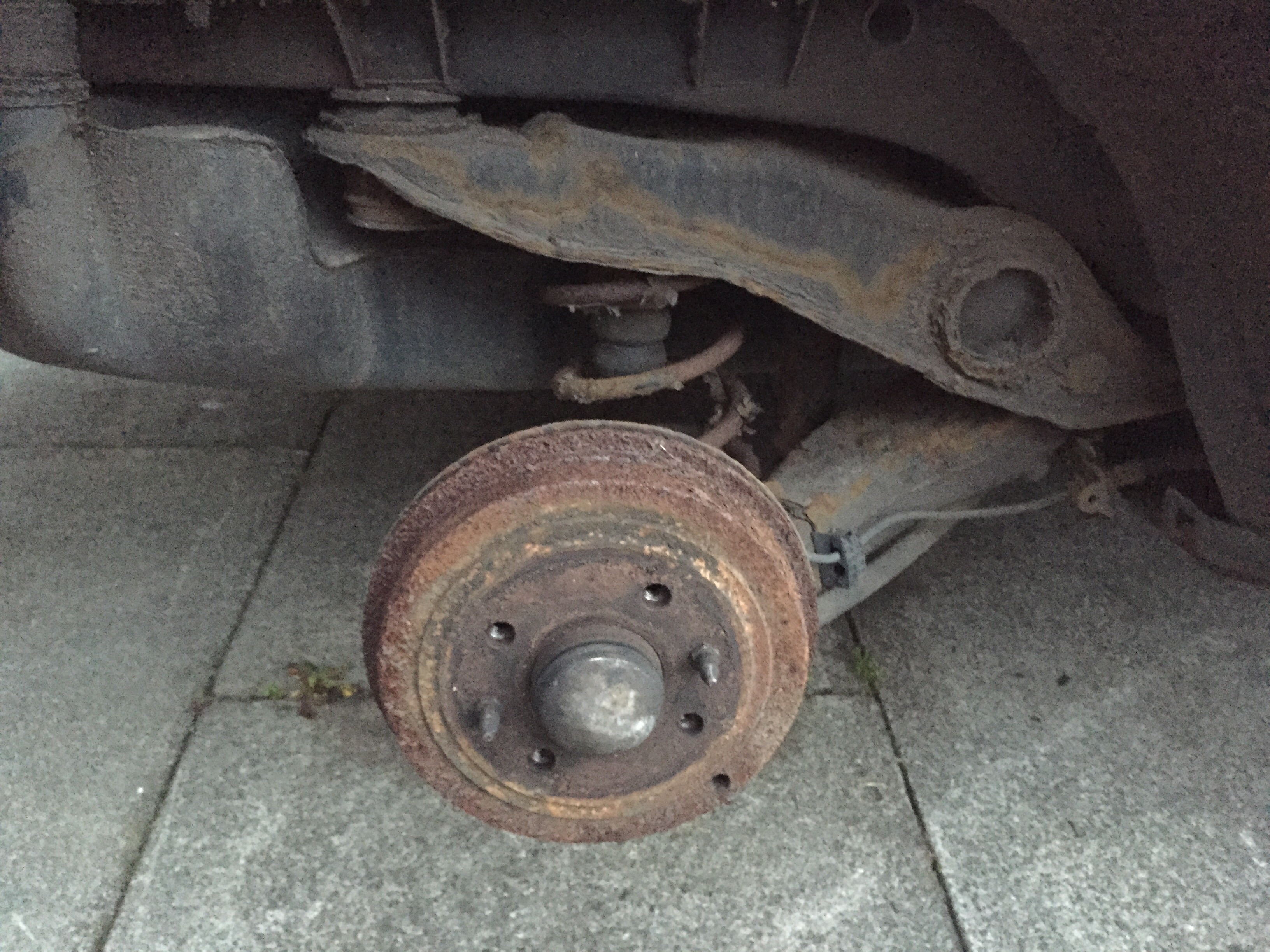

My question, the first of many as I need to get through the mot over next few months is, there is a rubber bush or spacer in the pic on the rear of the car that is perished on both sides, what does it do? What is it called? And is it an mot failure? If so what do I need to replace to get it through? If it's not to expensive I will replace it anyway, silly question maybe but I have to ask as I know you glorious fiat forum members will help me :)

This is the part.

You are talking about the rear subframe bushes... these are a problem area on the Tipo-derived cars (Coupe, Marea, Brava/Bravo, Multipla...) and used to cause a lot of cars to be scrapped because they were not available as spares.
It MAY be a fail depending on the tester, in any case they will get worse not better with time.. Also if they've gone you will get banging and crashing from the rear end.
The good news is they are now available aftermarket, either from Borg&Beck or Firstline but I think they may actually be the same... (?)

I think you'll have to drop the exhaust and whole subframe, swap out the bushes (with a press??) and clean up the subframe. I suspect the rears decay the worst but if you're doing the job it's probably worth changing all four.
