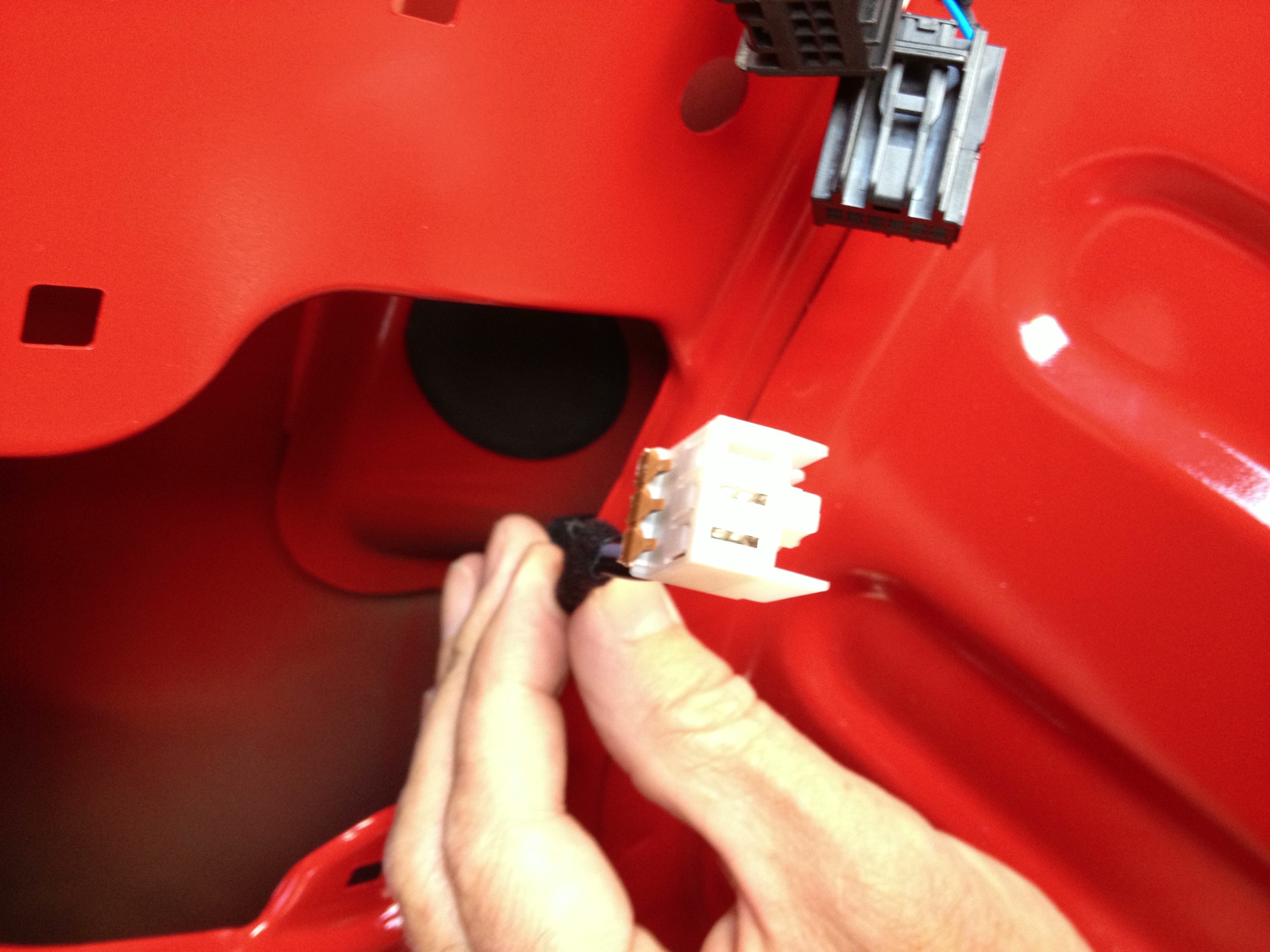

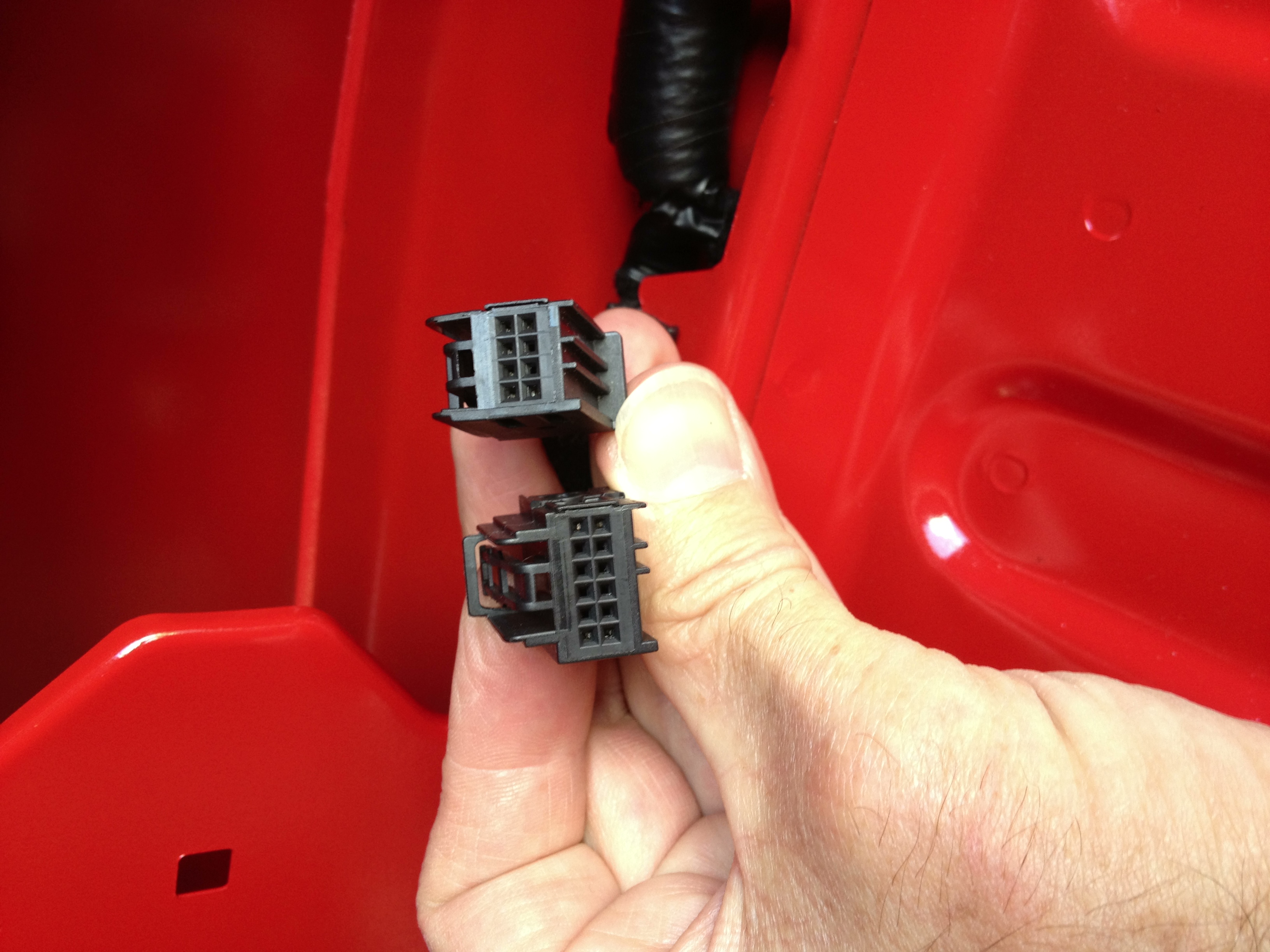

So I had a bit of time and pulled off a blanking plate on the driver's side rear behind where a door would go and found 3 connectors. A 12-way, an 8-way and a 3-way with much heavier gauge cable.
The 12 way, looking at it from the socket side (as per pic) with the clip at the top had 4 wires in it
Top outsides both blue, bottom outer left is white, bottom outer right is black.
The 8-way, looking at it from the socket side (as per pic) with the clip at the top had 6 wires in it;
Top L to R - Orange, Brown, Brown, Green/Brown
Bottom Outer left is Purple/Black - Bottom Outer right is White/Brown
The 3 way had just two wires, same view, Middle is Red/Grey, Right is Black and I think this will be the rear power socket (nothing in the left hole).
I have a bits tray (2 pockets) on the nearside and a blanking plate on the offside - is there a bits tray available for the offside too and would it have a place for the rear socket? Any ideas what the 12 and 8-way connectors are for?
If this was a Qubo, are the holes in the rear quarter posts up near the roof for small speakers? That may explain one of the connectors if so, perhaps the 12-way but why would they fit a 12-way connector for only 4 wires?

The connector blocks.........one is used [the black one] for the towbar black box control unit,i've not long carried out this so have seen the connectors you've posted.
The other one does not seem man enough for a aux socket, ihad a meter on it that read nothing [black is live in the fiat world]
Could be for reversing sensors?
I'm sure there more connectors behind the other panel on the o/s

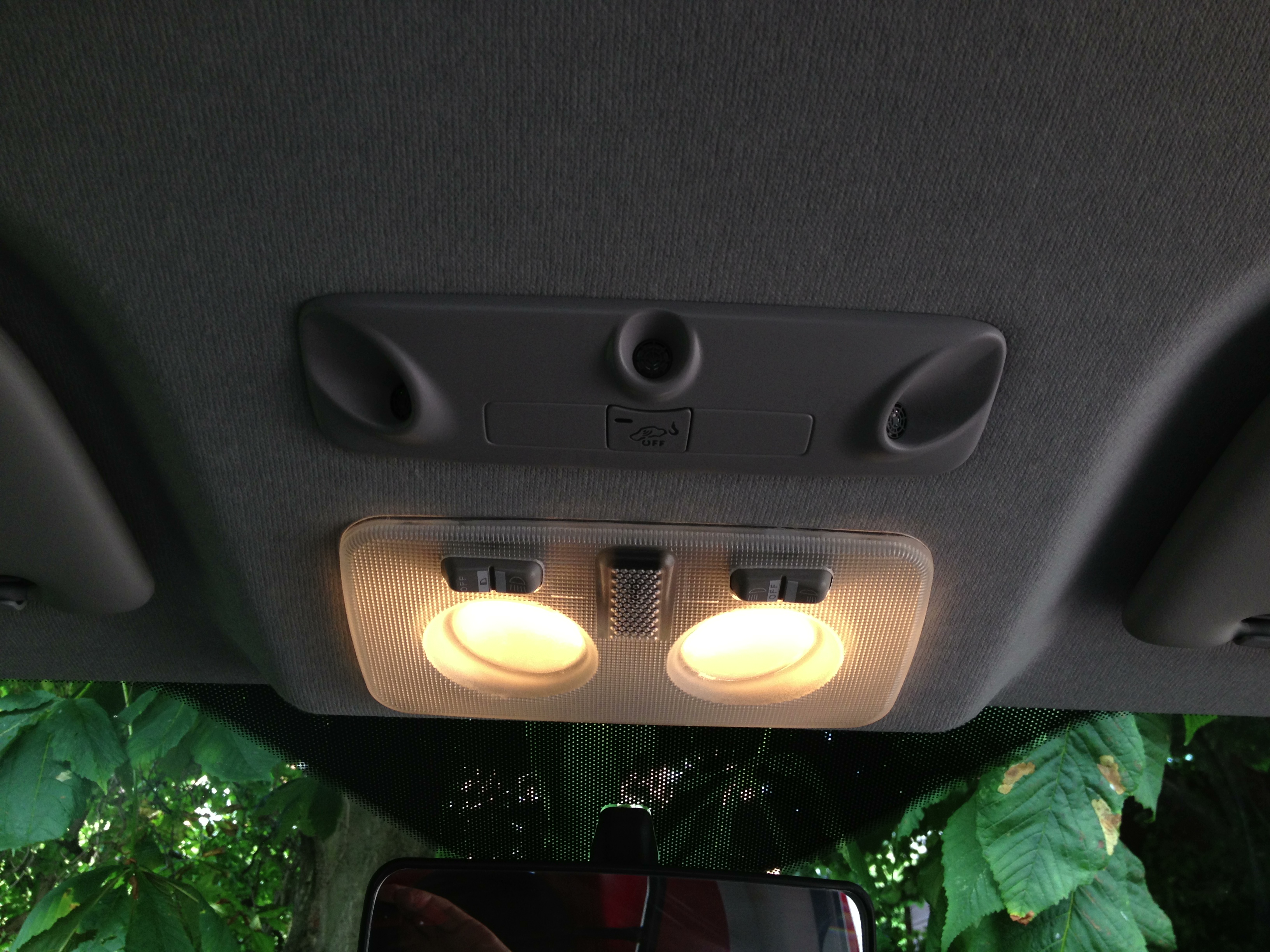

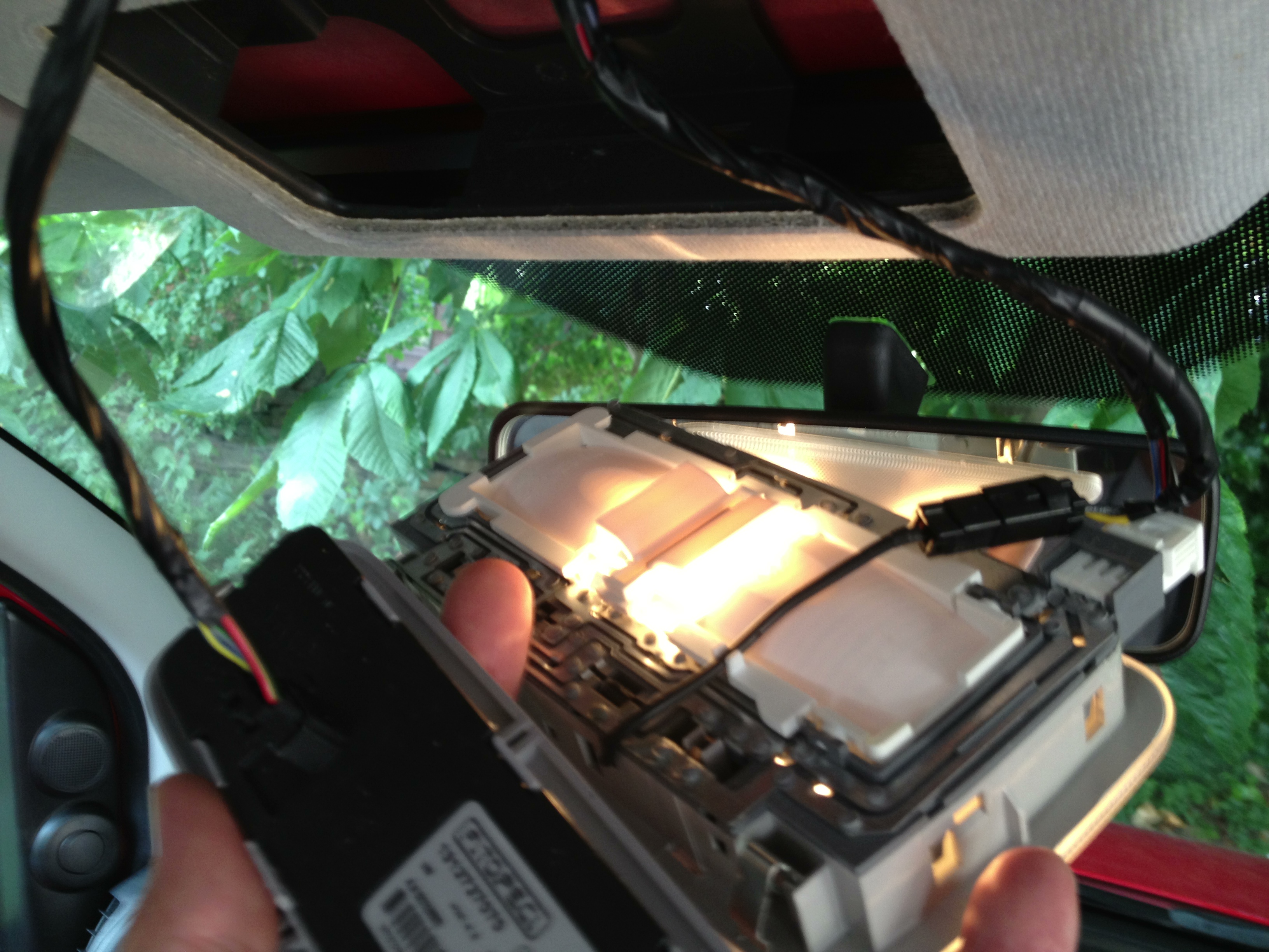

To confirm what the 'extras' on the loom are for in the roof lining behind the interior light, here are two pics of the light cluster and the motion sensors panel as fitted and also popped out. The light block looks to me like there are other things it could/should do but which are disabled for some reason. Perhaps a Qubist could elucidate on the functions in theirs if someone has a top of the range interior spec that looks different from the picture.?
Mine has two 3-positions switches for driver/pax but one side only seems to alter the brightness by the tiniest amount, the other I think is On/Off/Door as a normal choice but the fitting has double lenses, one for each front cab user yet there's only a single lamp installed. (These thumbnails blow up to a good sixe so you can clearly see the switch markings. The middle bar looks like it's a blank for another switch or function that not there. Info would be nice please!

My Qubo Dynamic light unit looks identical to yours R-V-M but no motion sensor panel as I don't have an alarm (don't tell anyone though!). I bought a genuine Fiat one but have never fitted it.
My light unit has two 5W festoon bulbs, one for each lens - are you sure you haven't got two? Left 3 way switch does off-door-on (both lamps on and dim after door close/ignition on). Right switch is cab map/reading light - left pax lamp only, centre off, right driver lamp only. This only works with the doors closed after courtesy 2-lamp function has dimmed out.
I notice a slight change in brightness too when flicking switches but I don't think this is a design feature, it's just due to contact resistance of the el-cheapo switches!
The only other thing in that area could be a sliding sun-roof but I've never seen one as an option on any variant.

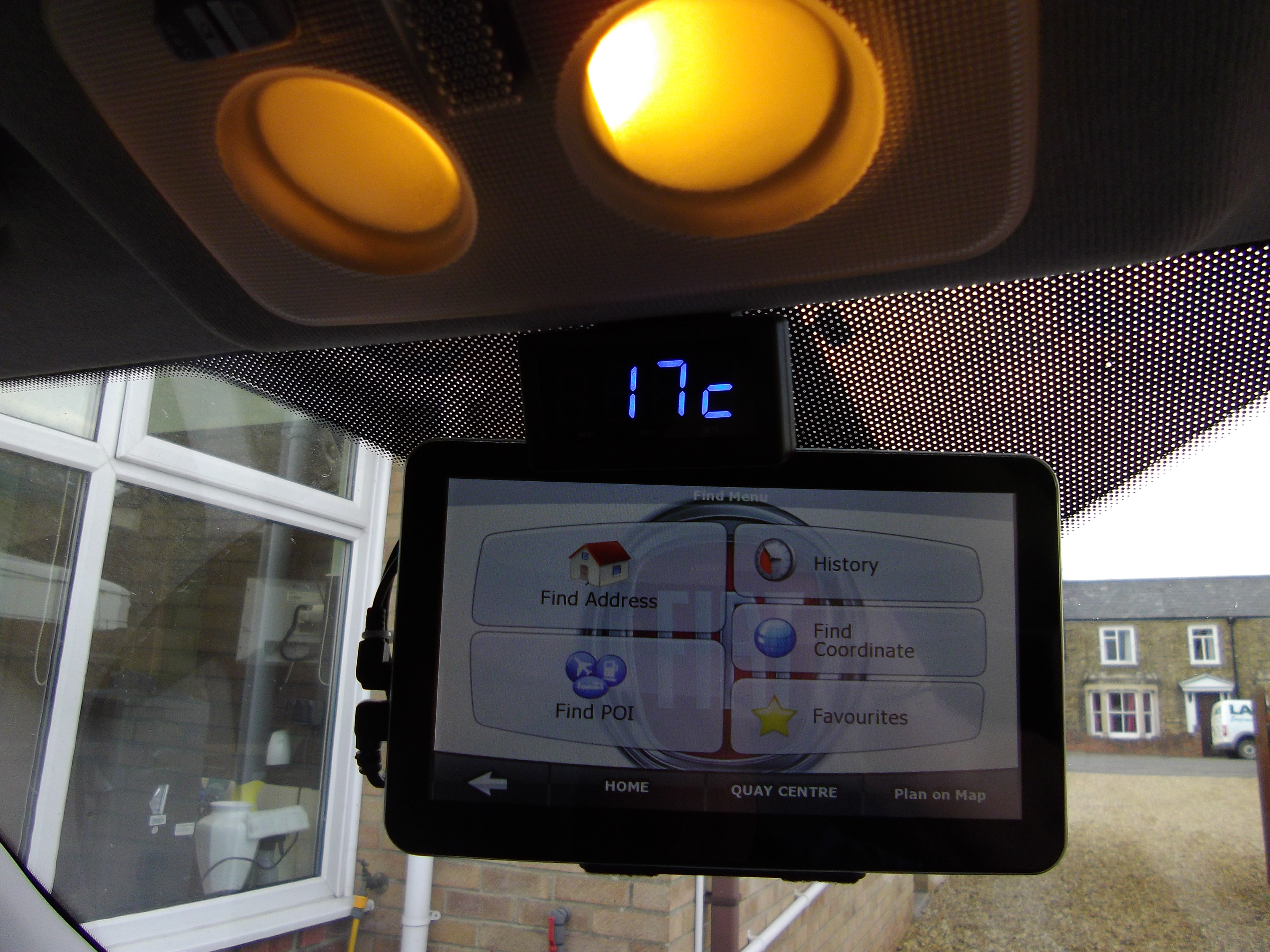

This is the pda/satnav on a modded mirror mount
Above is the clock,outside temp and voltmeter, they alternate every 5 seconds

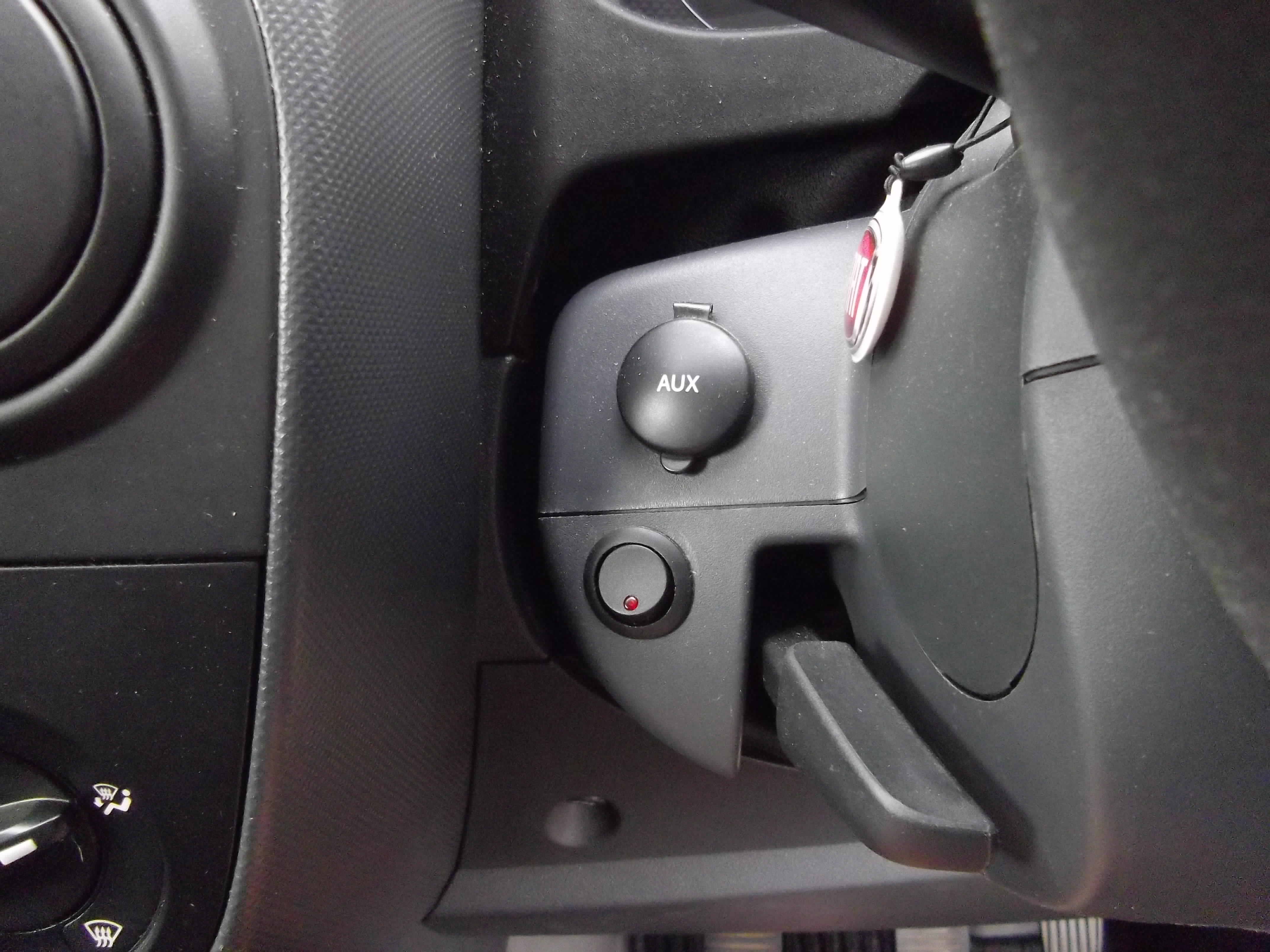

This is the aux in socket for mp3 ect and that is wired to the hu
The switch is for reversing camera override,so i can have the camera on all the time

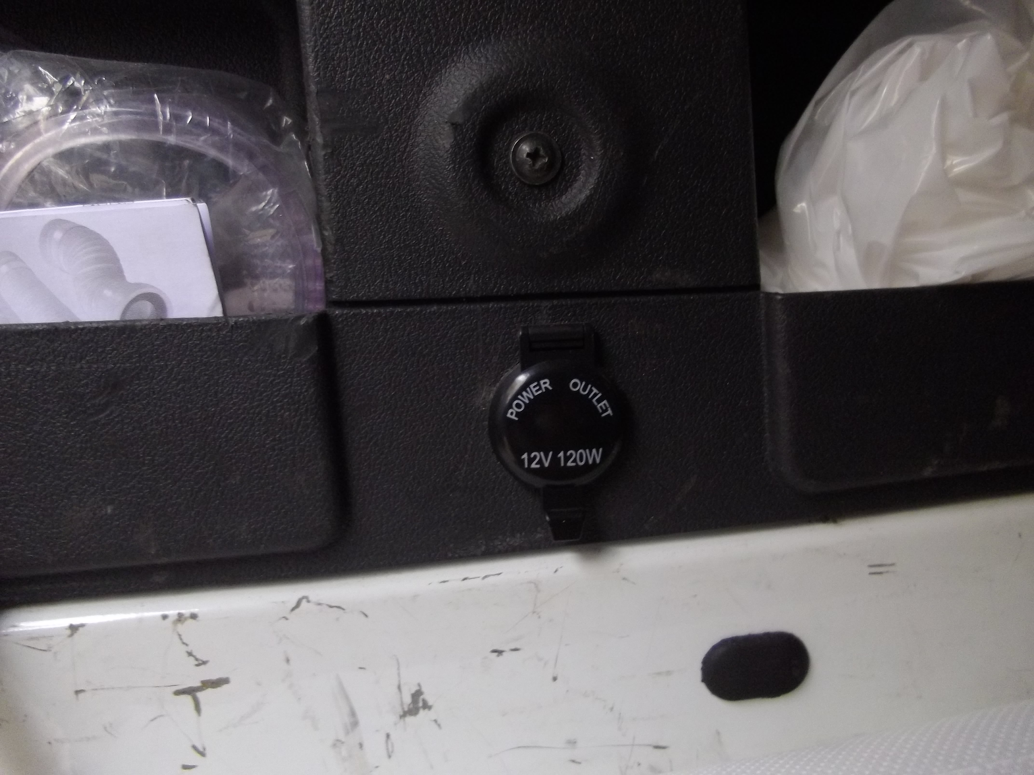

This is the 12volt socket in cargo area,this is live all the time wired with fuse to the battery.
