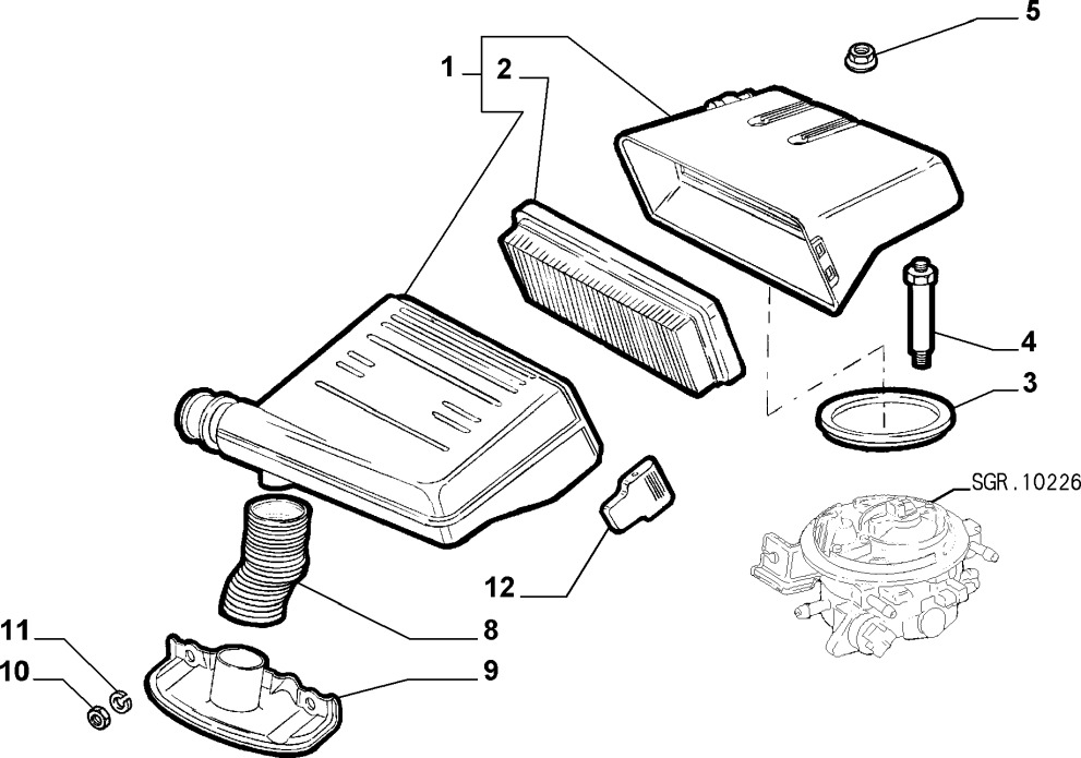

I have noticed that the soft gasket (big round one!) on the F I body is pretty tatty & probably leaking air/fumes Local fiat can't help (!) anyone haven explodes diagram with part numbers? It must be common to other cars

you mean no.3 on this??
its no longer available new but part number is 7759322 if thats what your looking for...
