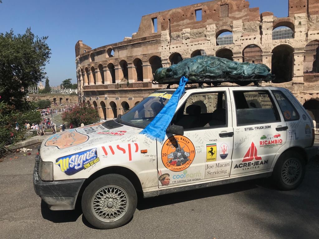

Just read this, I realize I'm quite late in answering but I'm happy to share my experience by writing a quick summary of our adventure; I’ll also start a thread on here as a sort of guide for anyone that wants or dreams about venturing on this trip.
I have taken part in the latest edition of the Mongol Rally (2019), and incredibly managed to complete the event and also drive the car all the way back home.

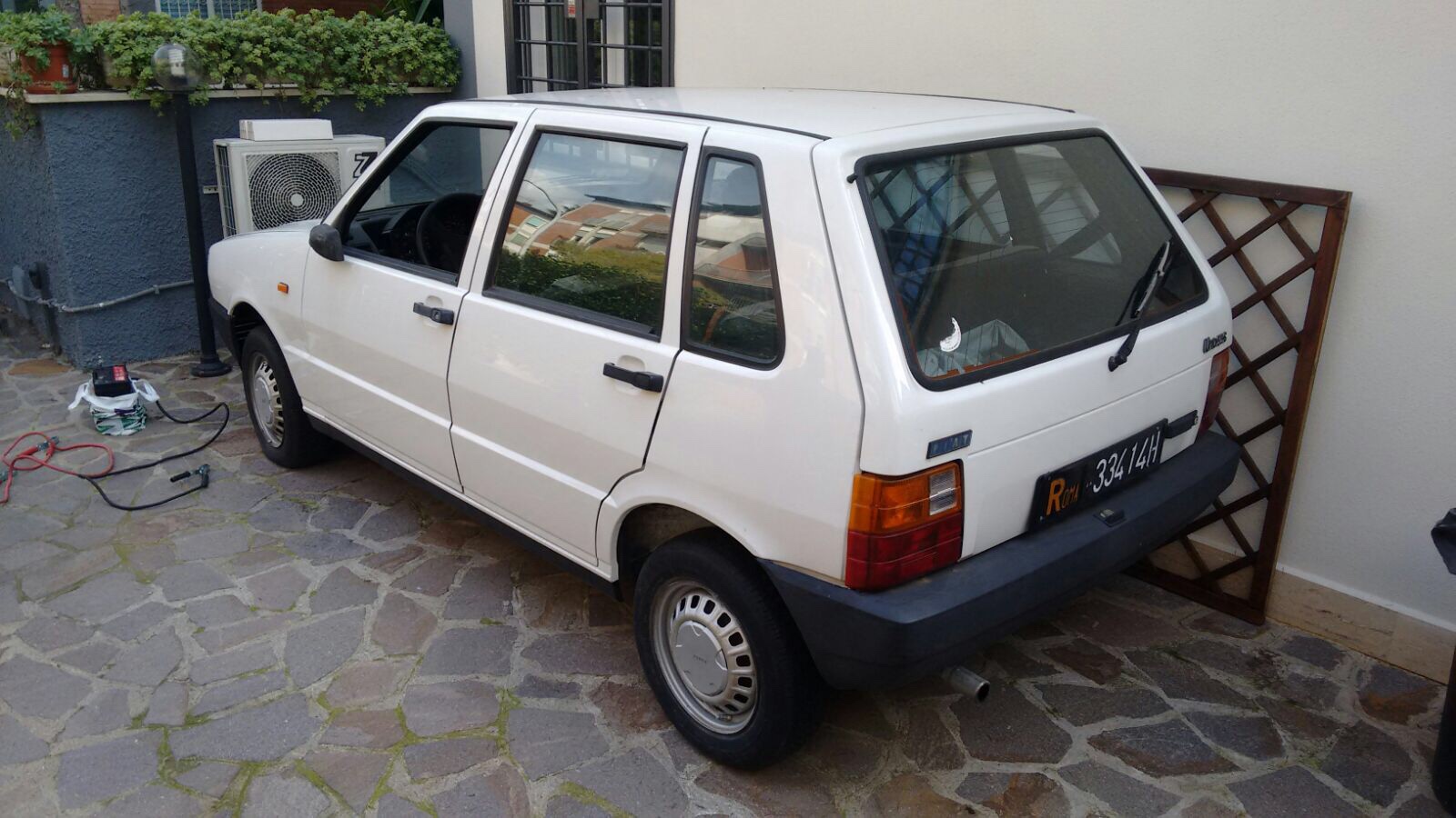

Our weapon of choice was a MK1 Uno from 1985; points ignition, carburettor, no ecu and manual fuel pump.. but at least it was a comfy 5 door ! picked it up for €700 from the original owners granddaughter after it had been sitting for the best part of 10 years;

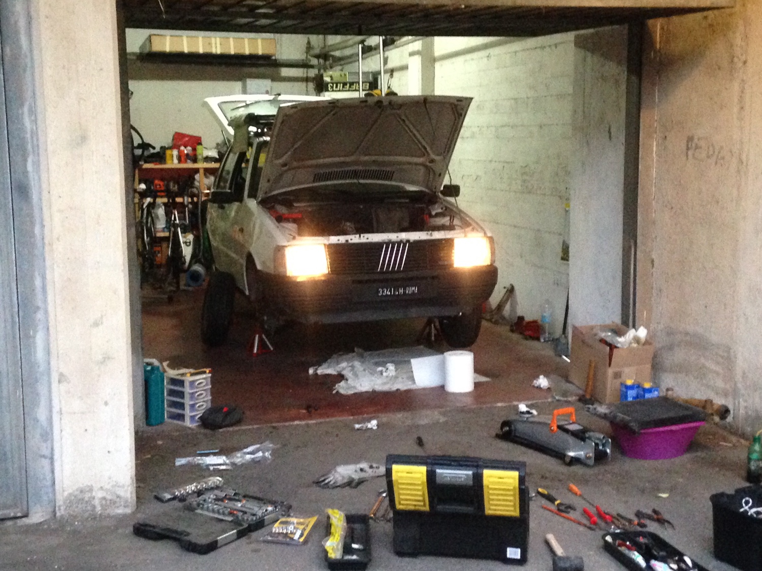

I did all the basic maintenance jobs that any car enthusiast would do to an unknown vehicle (timing belt, w/pump, gaskets and filters..) and made it roadworthy for not much money.
After two years of tinkering with the car and some summertime “test runs”, a team was formed in Sep. 2018, and by April 2019 the car was ready to travel up north towards the UK for the final bit or rally prep until the start of the event in July down in Czech.
We had planned to drive the famous but tortuous “southern route” via Iran and the “Stans”, and were hoping to have enough time (and enough car!) to drive all the way back after completing the event.
We incredibly managed to stick to these plans, driving for 44 days and covering 11k miles, reaching the finish line in Siberia in the last day of August.
The event was finished, but not our adventure, so after a day of patching holes and throwing spanners at the car, we packed up and headed back west towards Italy.
A total of 54 days, almost exactly 20k miles, countless breakdowns and a variety of little faults that were thankfully never terminal, all stuff that can be fixed with a bit of patience and some basic knowledge of old cars.
Most of my problems derived from bad quality fuels: depending on what route you'll chose expect to encounter the crappy stuff from Iran, Turkmenistan or Kazakhstan, where the average selling petrol is 92 octane, but most times the best you can find is 80. Also these are not RON ratings, so fuel can be even crappier than what the label suggests.
For normal cars this isn't much of an issue since they all have electronic fuel injection and variable ignition timing; in my carbureted old bucket of bolts I had none of that, and so had to get the tool kit out where most modern cars would just self adjust.

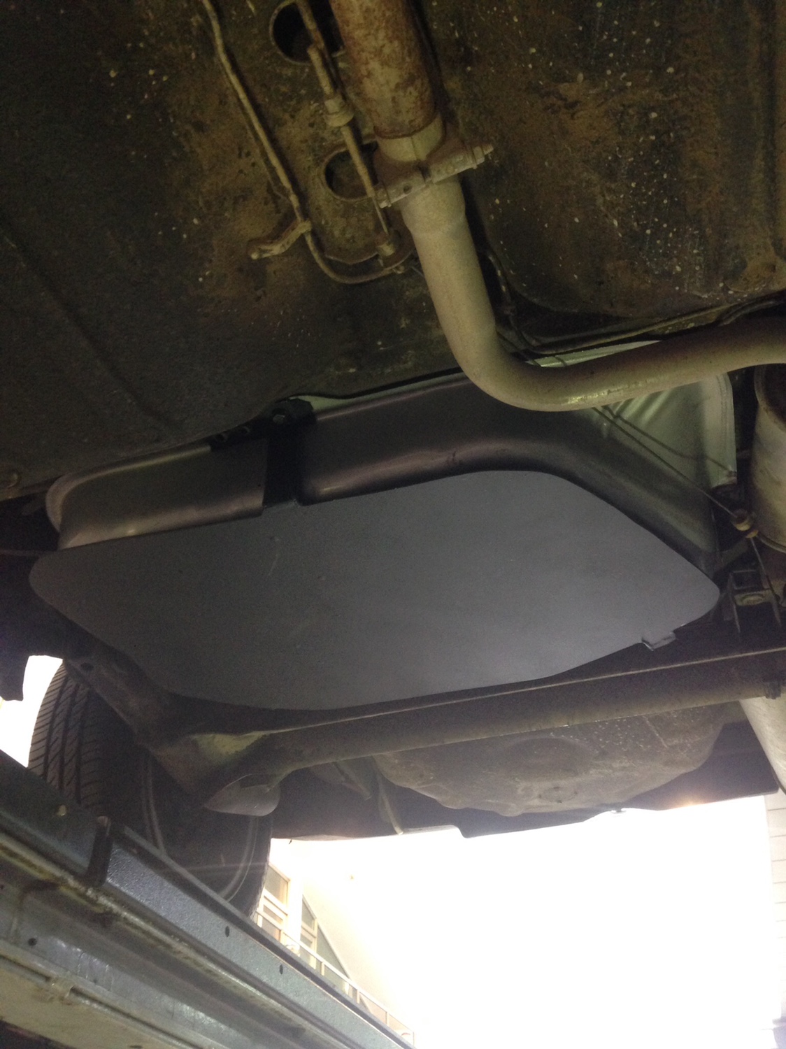

make up a sump guard. make it as strong as you can and don't forget to put some holes in it for ventilation so the hot air from the engine can find its way out. I made mine out of 4mm thick steel. It weighted almost 25kg but was well worth it, I had to bash it back into shape at least twice during the trip, absolute life saver.
being the 169 panda quite a popular car It would not surprise me if you could find an off-the-shelf part for this purpose. I'd also suggest some sort of protection for the fuel tank, I also made this one myself.

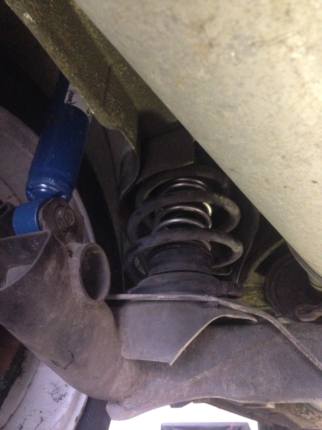

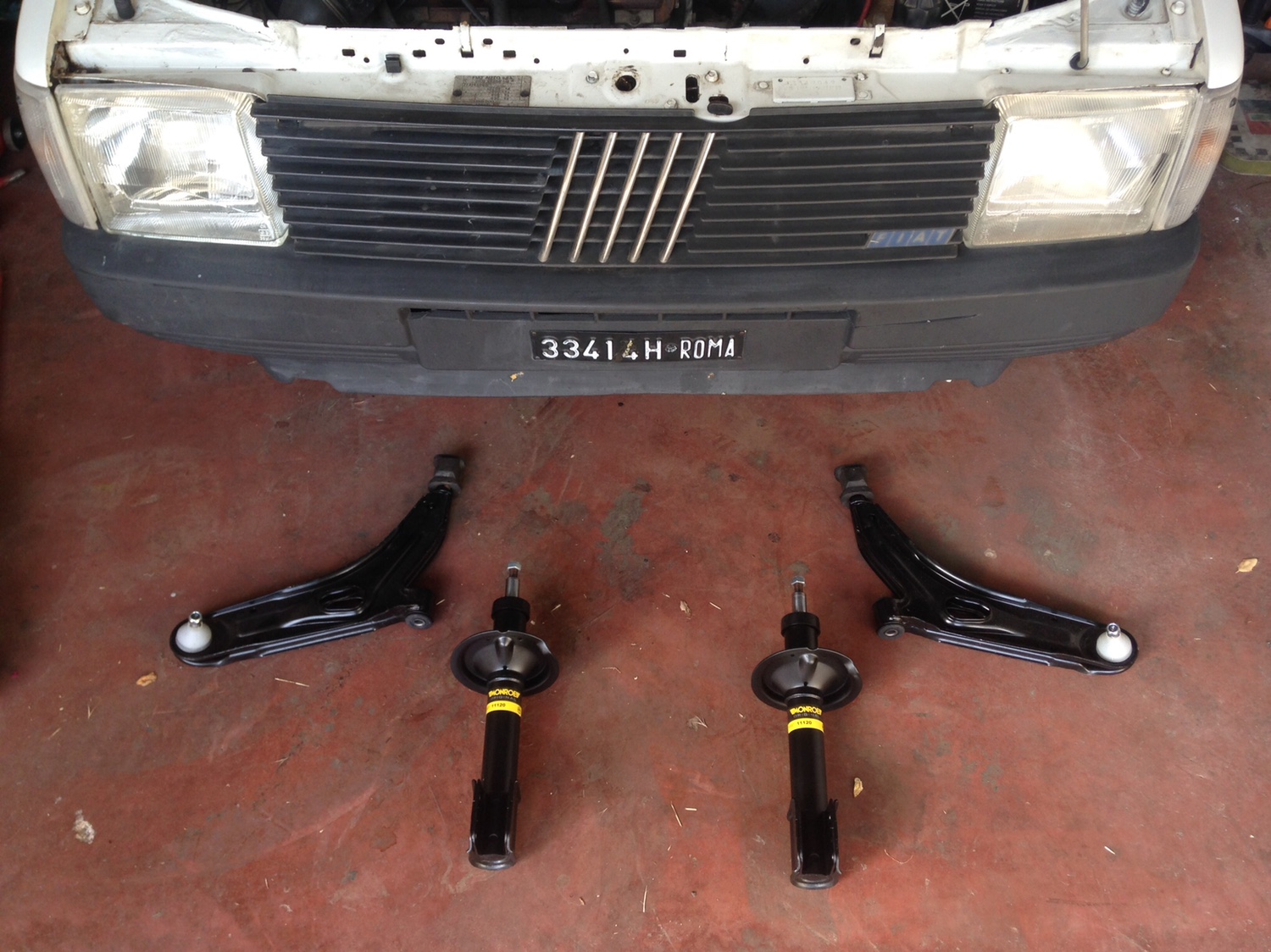

suspension: as you mentioned this department takes a lot of abuse on this event, and I can sure confirm that. Again, the 169 panda, specially the 4x4, has a good aftermarket support so I'm sure you'll find something.
This wasn't the case for my Uno, and so the best solution for me was to fit new good shocks all round, I’d suggest a well known brand here (mines were Monroe), and the coil springs from the Turbo Diesel version that had a 1.4 liter all iron engine with turbo and intercooler to support. If yours is a 4x4 I think aftermarket is your best bet. For a 2wd car try to find the springs for the Natural Power version. Do not fit spring spacers.
Regardless on whether you'll be 1, 2 or even 4 people like us, the rear of the car will have an awful lot more weight to deal with, this is quite common for Mongol rally cars, broken rear springs even after only 5k miles are the norm.
to avoid this I went for helper springs, or towing springs whatever you want to call them. Much better than the old tennis ball trick, they are small springs that fit inside the rear coils and effectively help them support the weight, they are designed for cars that tow caravans. I was able to find a set on Italian Ebay for my Uno, and they were one of the best improvements in my opinion, the rear squat was minimum, leaving loads os suspension travel left, and we never suffered from broken coils or shocks for the whole length of the rally, and boy were we loaded !!
Have a good look at your steering components and bring 1 inner and 1 outer tie rod. I rebuilt my steering rack right after buying the car and my aftermarket inner tie rods started failing in Uzbekistan. This was a big worry as the roads only get worse from there. Luckily we managed to do enough bodging to make it last the whole trip, but I regret skimping on spares on this one.
I’d do new wheel bearings too for what they cost, the roads are crap and the car will be massively overloaded.

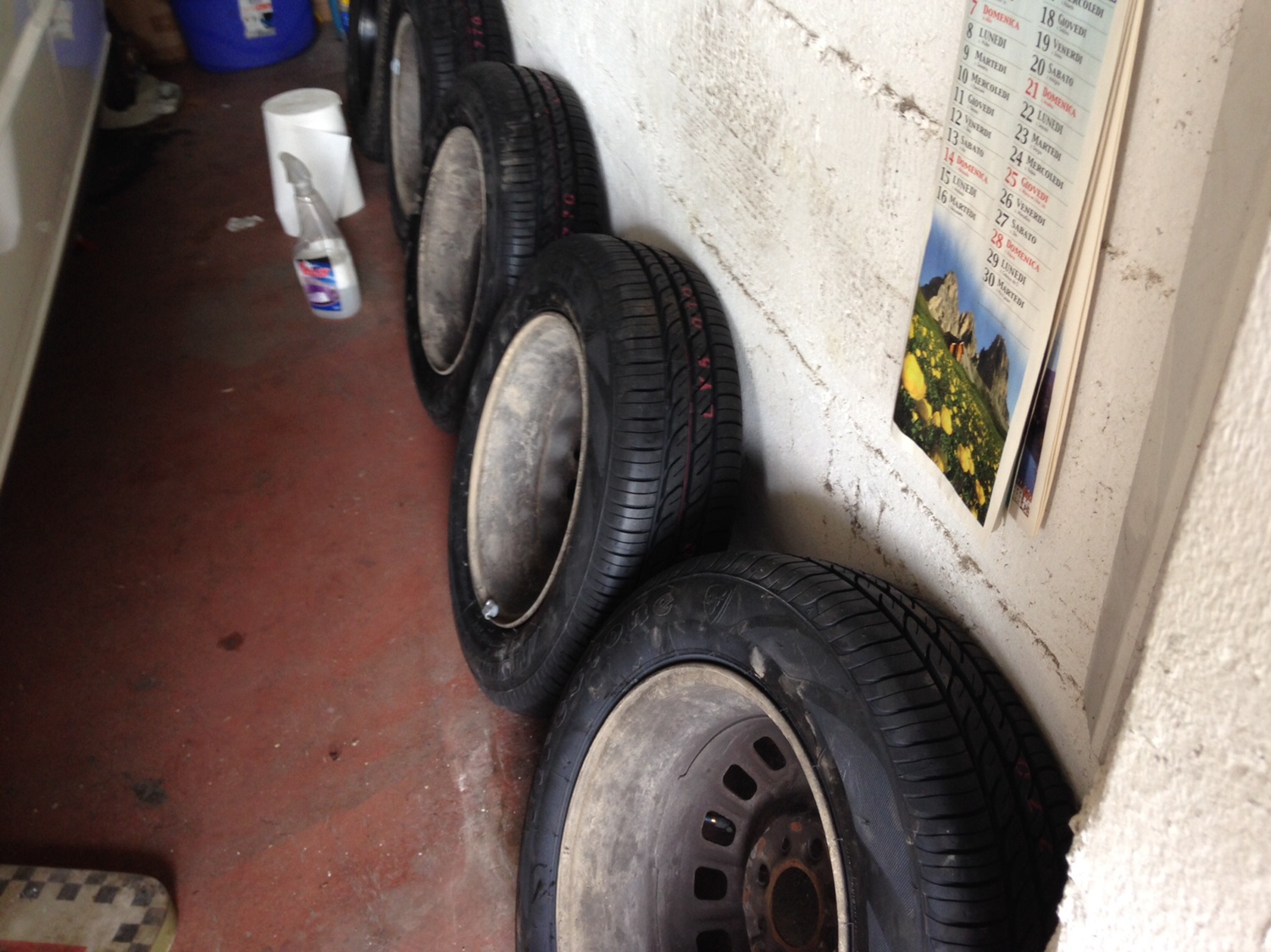

I’d fit new tyres, of as good of a brand as you can find, and bring 1 max 2 spares, no more. I went with some Firestone Multihawk 2 which were the poshest option in my weird size (155/70R13) and it’s just a normal cheap shopping trolley tyre, made in the same factory as Bridgestones just a couple of miles out of Rome. I had 2 punctures, 1 on which my fault (handbrake turn on a gravel road in KZ), and so was able to repair both and drive the whole of the rally (plus 5k miles of testing before that) without any major issues.
No point in fitting off road tyres in my opinion, your choice if you want to go that way; the only thing they do really good is protect you from punctures, but they are otherwise very heavy, noisy and almost scary on the wet or when you have to stop in a hurry.
You are more at risk of getting a puncture if you’re running low on tread, hence the reason to go with a new set. Also get the car aligned ideally once is loaded and ready to go, crucial bit this. Pointless fitting new tyres with the car out of alignment, they’ll be gone in Turkey.
Another important thing is to remember to rotate tyres around, that will help them last longer. Mines are still good for at least another 10k miles after driving halfway across the world.

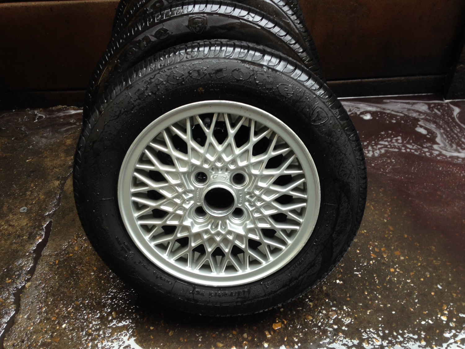

Rims: I went against everything people say and consciously fitted alloy wheels on the car, and those also made it all the way. I had 2 steel wheels as spares, but my strategy was just to look out for big potholes and I was lucky enough to be able to avoid the worst ones.
Those little MSWs are strong !

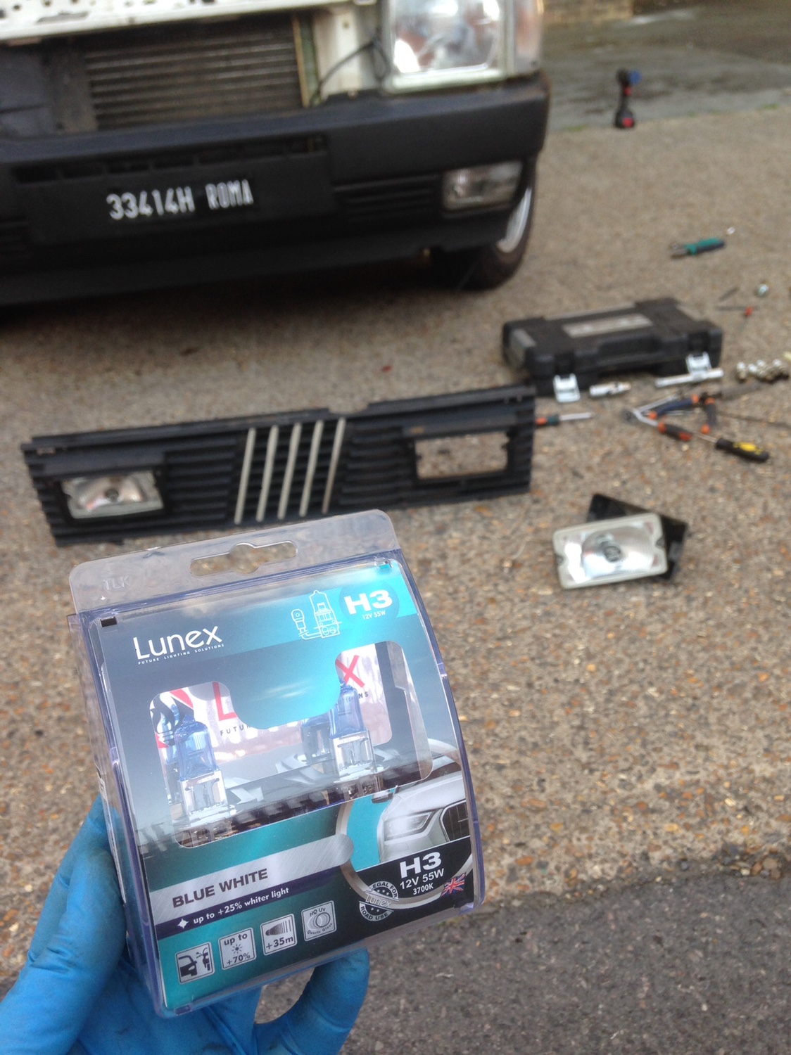

With that we come to lighting: most people fit spotlights purely for looks, but if you’ll be on a tight schedule like me you’ll be very likely driving at night for many hours, and so a good set of spotties are a good idea. Don’t fit them on the roof, that will just light up the whole bonnet right in your face when you’re trying to achieve miles in the nighttime, not a good idea. Instead, go for the front bumper. I was able to find a genuine accessory front grille from back in the day, with integrated spot lights. To that I added an SX front bumper with fog lights and upgraded the standard lights to H4 and fitted relays and fancy bulbs to all 3 circuits for more reliability. Bear in mind that in places like Mongolia cattle and camels love to cross the road at night, and if you’re trying to make up some time by speeding up a bit without some sort of high power lights, it will be too late to brake.
I had two close calls, pretty scary experience.
I had friends with only their standard lights, but their top speed was 50, when I could to 70 most times, quite a difference in stopping distance.

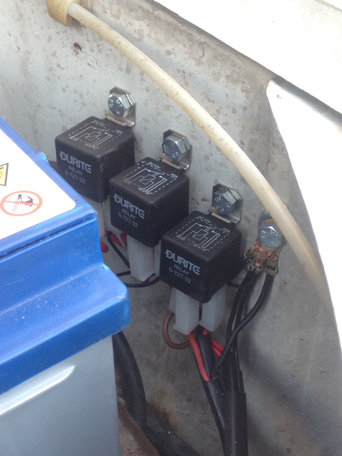

As we’re talking about the electrical system I think a new battery is a no brainer. Try to source a replacement voltage regulator for your alternator, those can fail with all the dust, and they’re much lighter and smaller to carry than a complete spare unit. Leave alone the starter motor if it’s working, and if it fails get out and push, not the end of the world (I had to do it for 4 countries !).

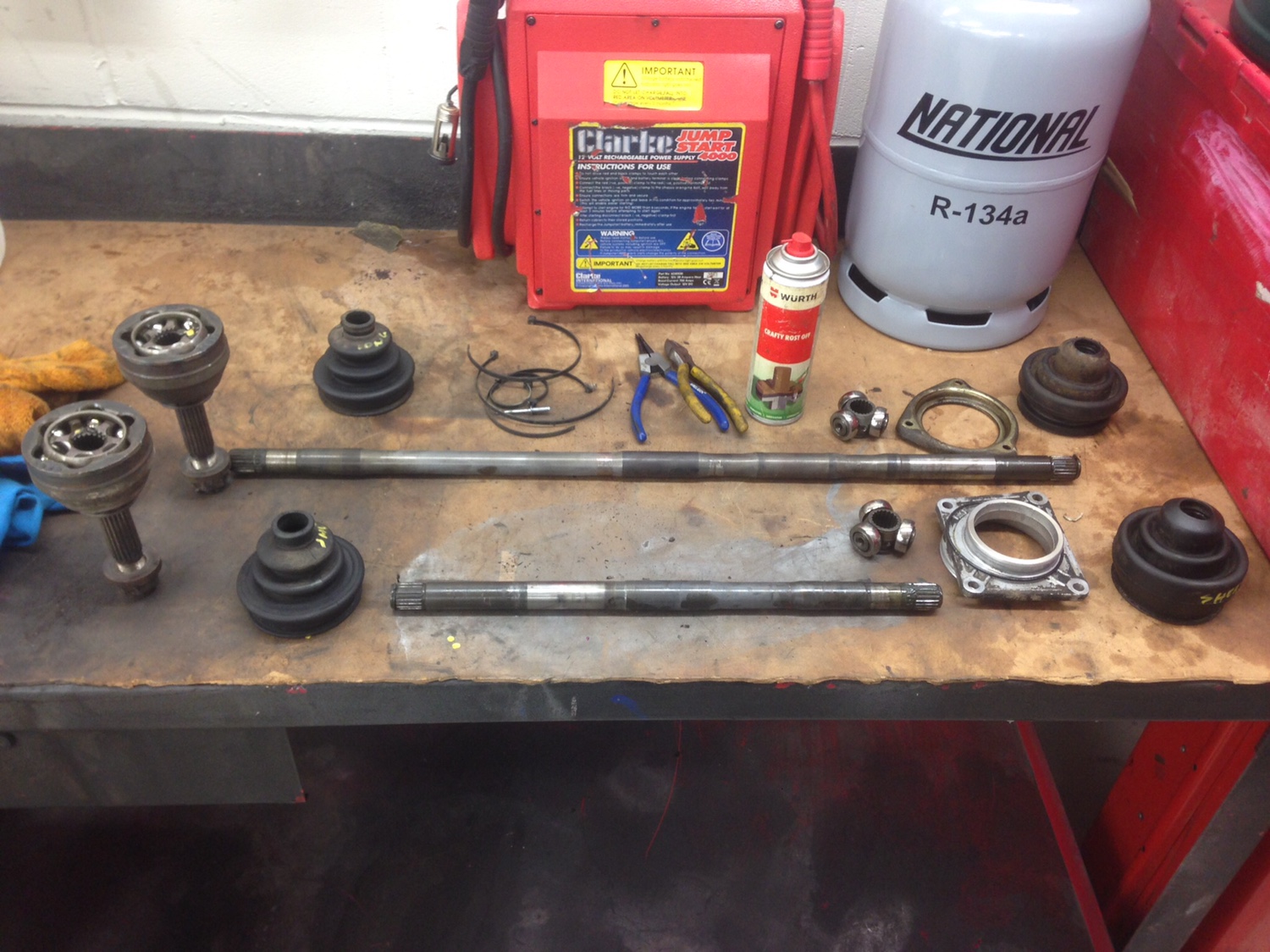

Driveshafts: another component that will suffer badly, and also one for which parts will be mostly unavailable; so pop both shafts out, new grease, new boots and clamps and live happy.

It’s a fine line really, I decided to give priority to suspension stuff, since I knew from the start that we’d be very heavy, and so took front and rear springs plus 2 shocks. 2 top mounts and one front and rear wheel bearing. I’d suggest to bring an extra air and oil filter (clean the air filter daily as you check oil and water) and a fuel filter if you have it. Spark plugs also a good idea, and don’t forget at least 1 fire extinguisher. Top and bottom rad hose, maybe a thermostat.
