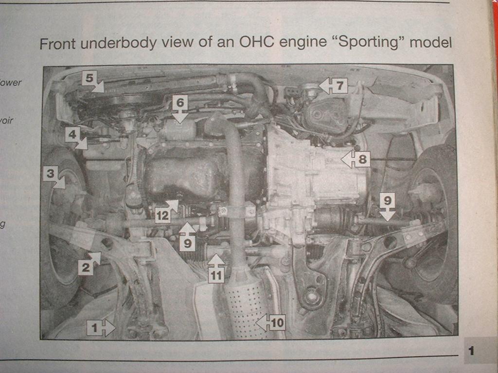

Anyone got a pic of the underneath front end/engine of sei, so i can explain where i have an oil leak about, not got a clue what the area/part is called.:mad:

so, the diff on the back of the gearbox. where the driveshafts go into?
what is the oil like. does it stink, and is it like oil, or a thicker grease?

this help?

when browsing i see u have got the idea!
its like fresh oil if u know what i mean, its not bad but its pissing me aff, just got rid of an old pug 106 d, it made a mess of new mono driveway and now the sei is dropping ****, arc u got any pics or links to give u exact bit.

ok, its unlikely that it'll be dripping engine oil out there, more likely running down the sides of the engine/bell housing and then dripping.
on the end of the right hand side of the engine, theres the coil packs. behind them is a rubber O-ring. that is the camshaft oil seal. piece of **** to replace, and cheap. but probably not the problem.
the problem is more than likely the cam cover gasket. to sort, remove it, thourghly clean the gasket surfaces and fit a new gasket, and torque the bolts down.
if you have a look around the top end of the engine, you should be able to see it leaking below the cam cover.
i've a pic, kinda shows the cam shaft oil seal (where it should be!)
btw, mine atm leaks oil from there - its a cam cover oil leak that i'm too bone idle to fix!
