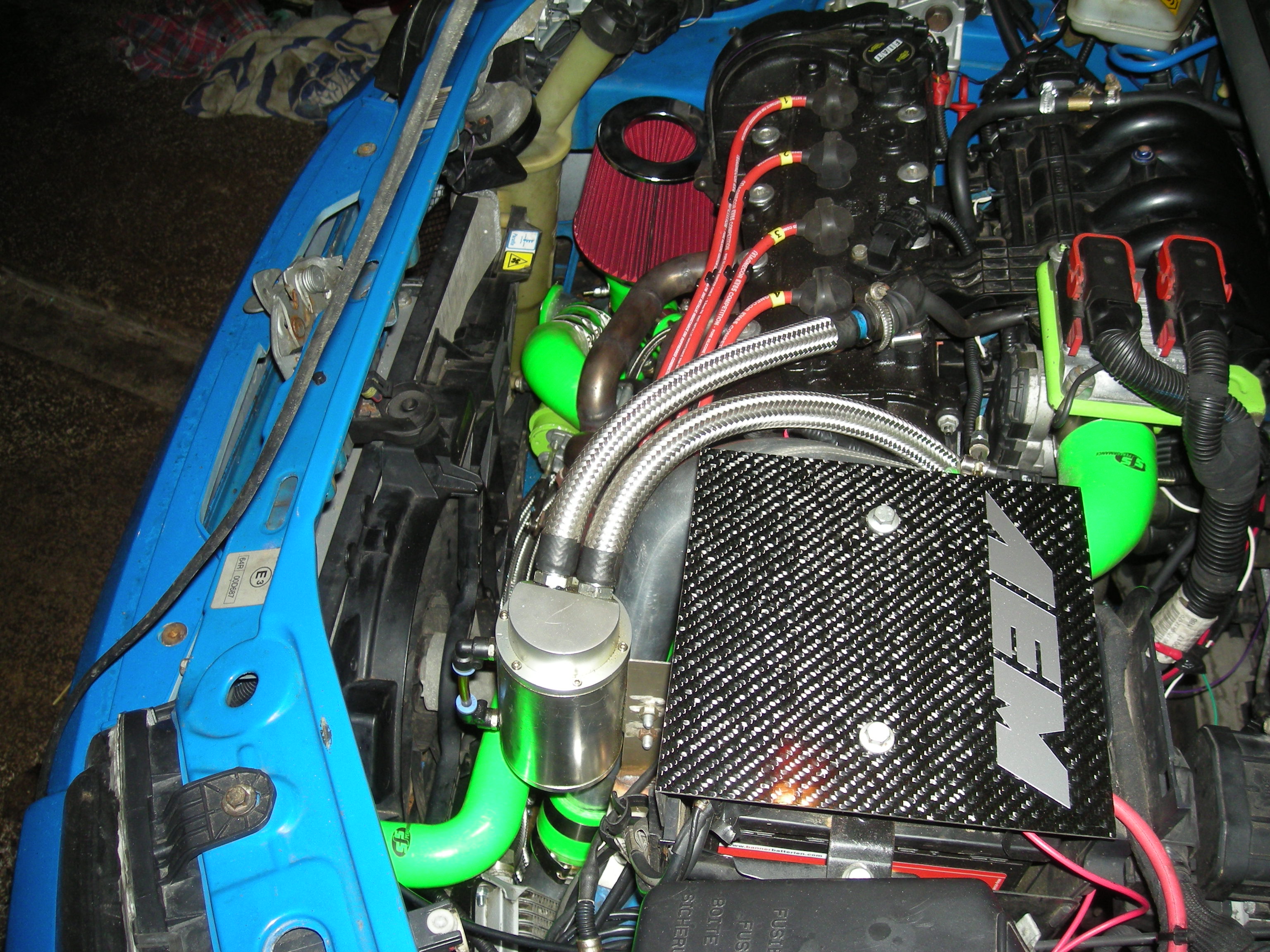

New pics

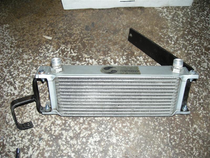

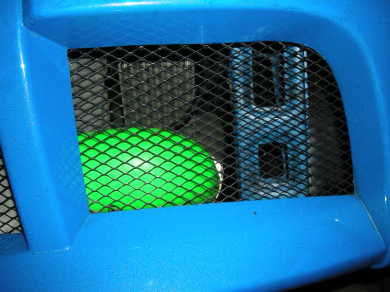

First i made brackets for my Mocal oil cooler
This is the best position i could find - avoids the intercooler pipework yet still has fresh air direct from the bumper vent

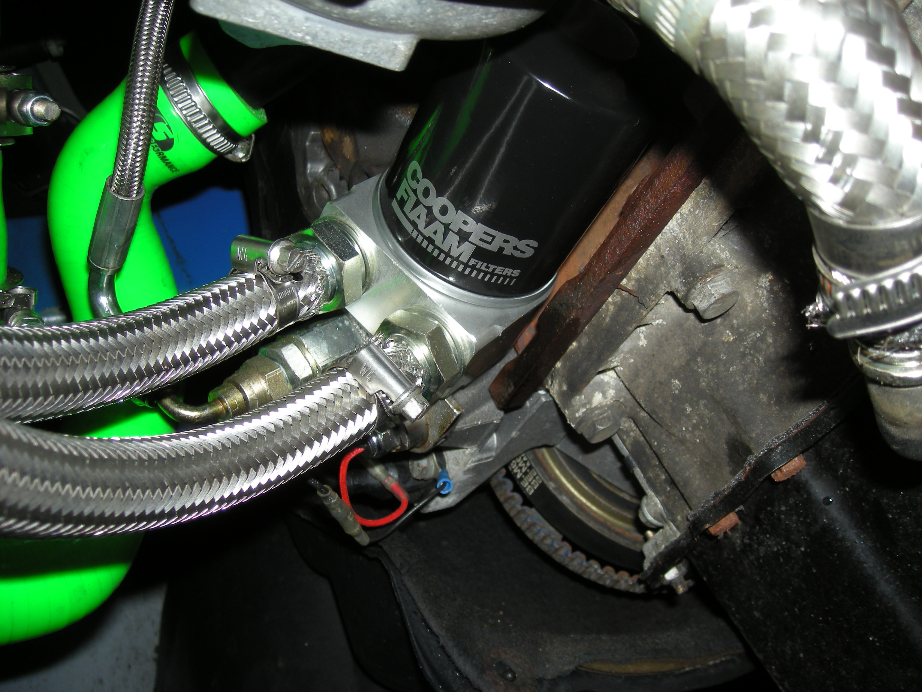

This is the rest of the setup, with all Mocal stainless braided hose and fittings
Inline thermostat because no space for a built-in one on the sandwich plate

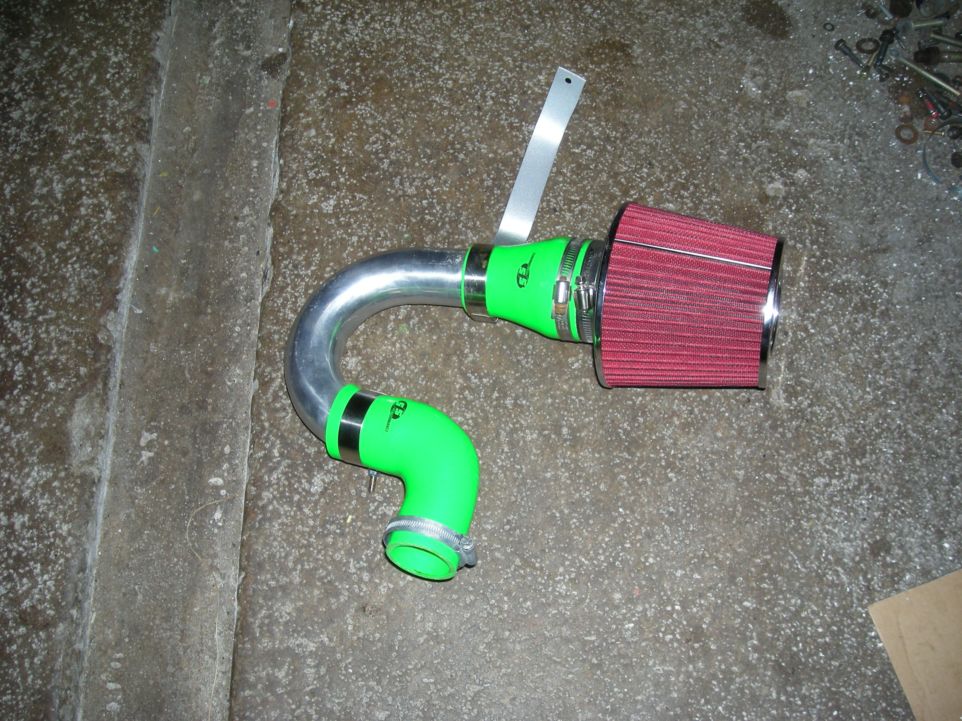

This is my "induction kit" lol

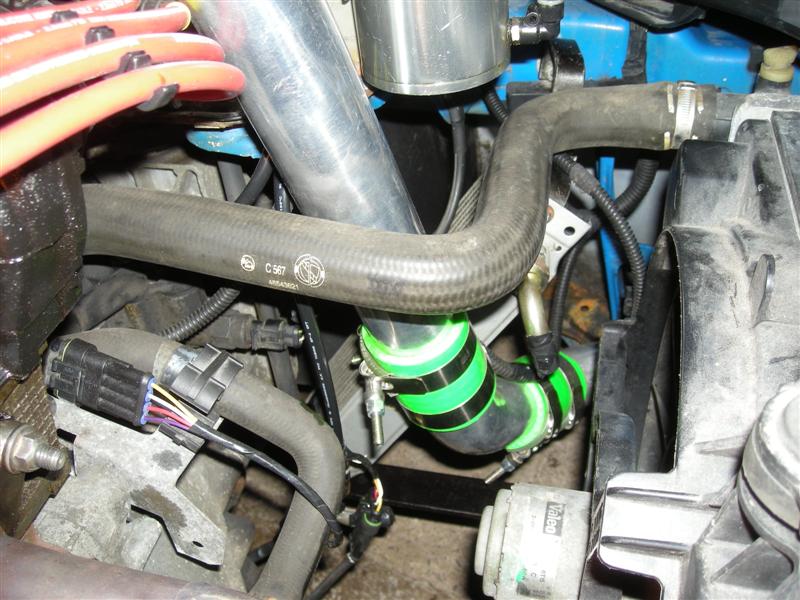

I also bought some silicone radiator hoses from a group buy on puntomk2 - from SFS as well so i was able to get an exact colour match to the rest of the silicone!

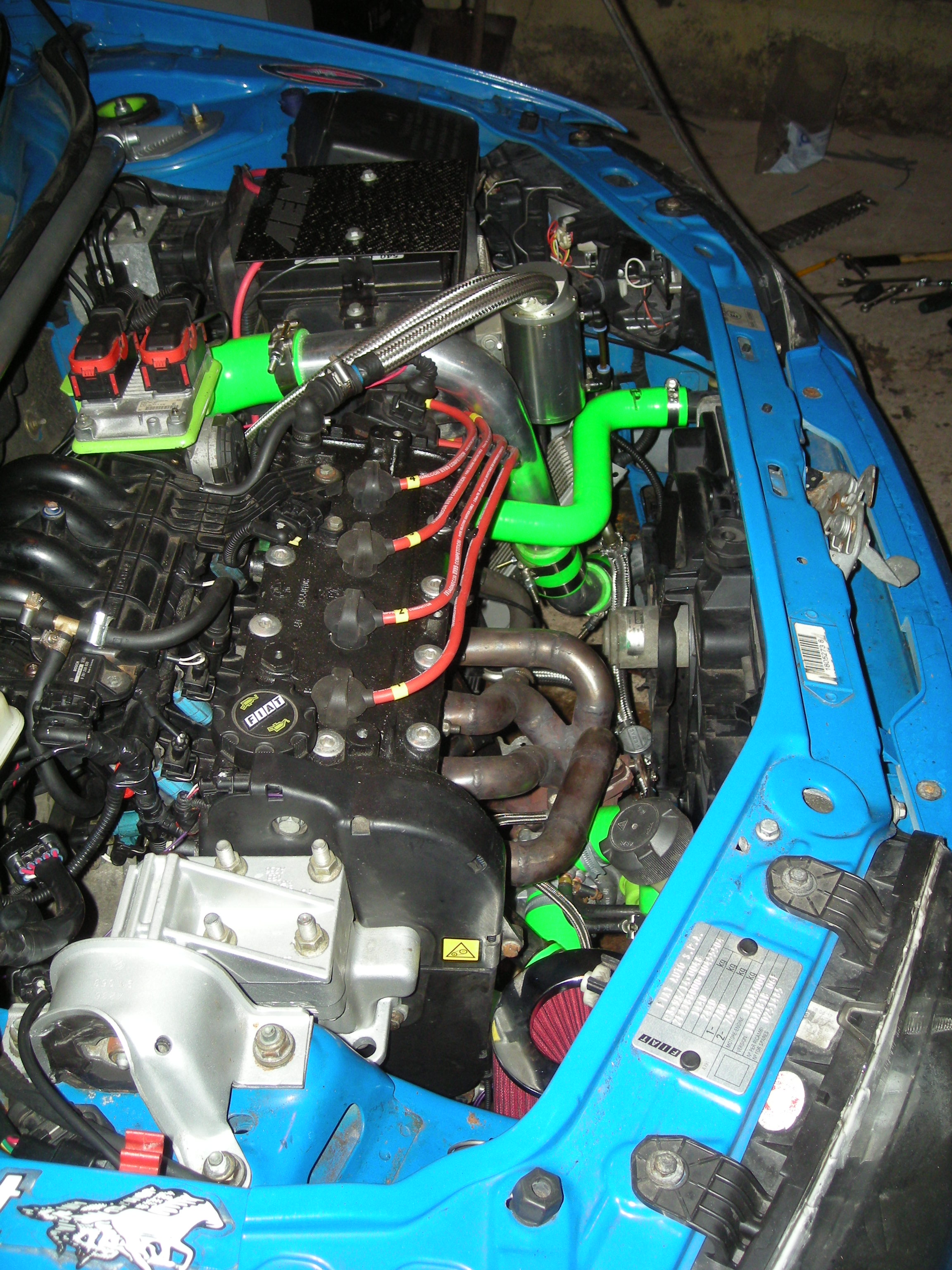

So this is what the bay looks like now

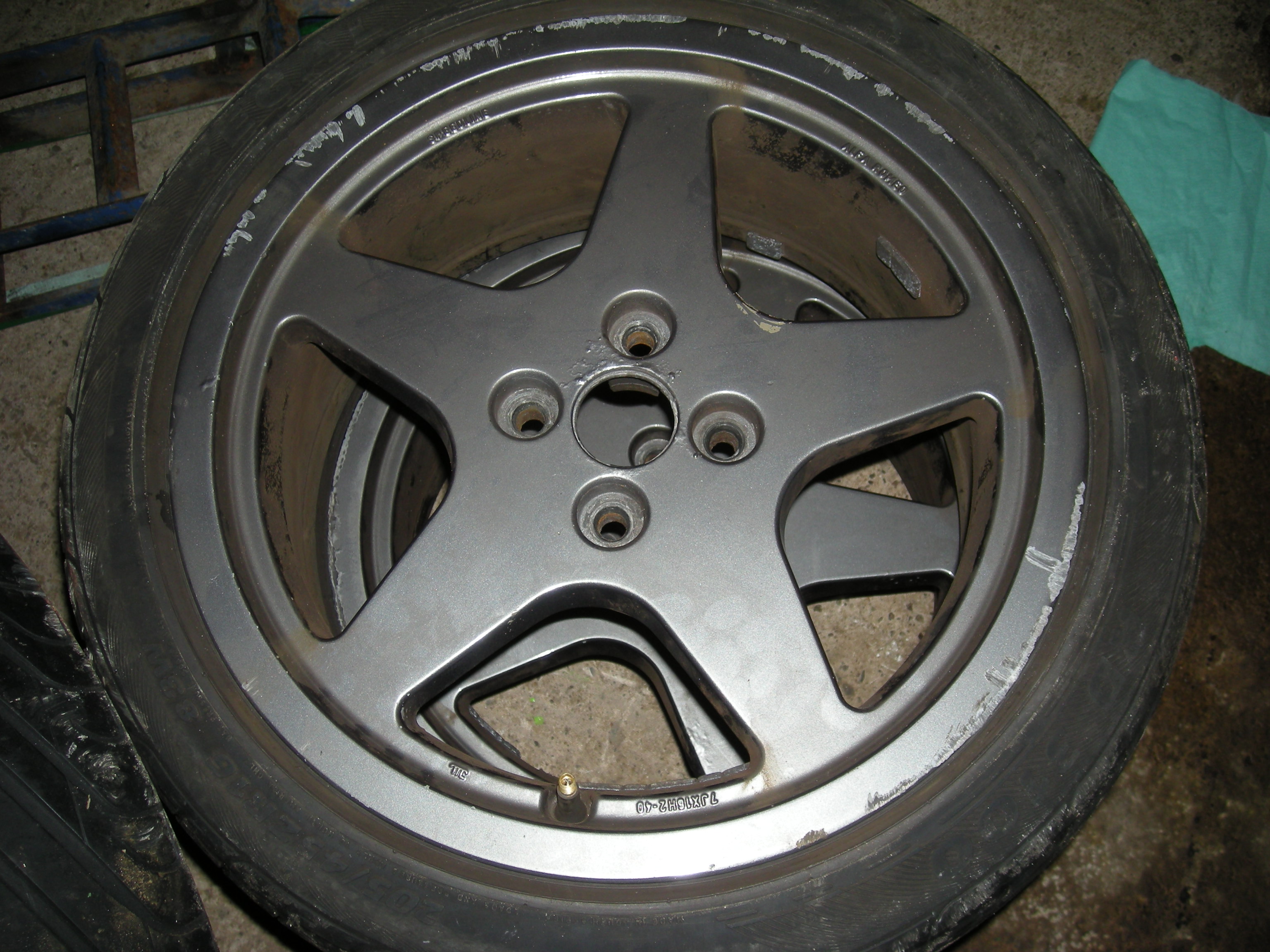

Here are my new wheels
Dont worry, i have plans for them.
