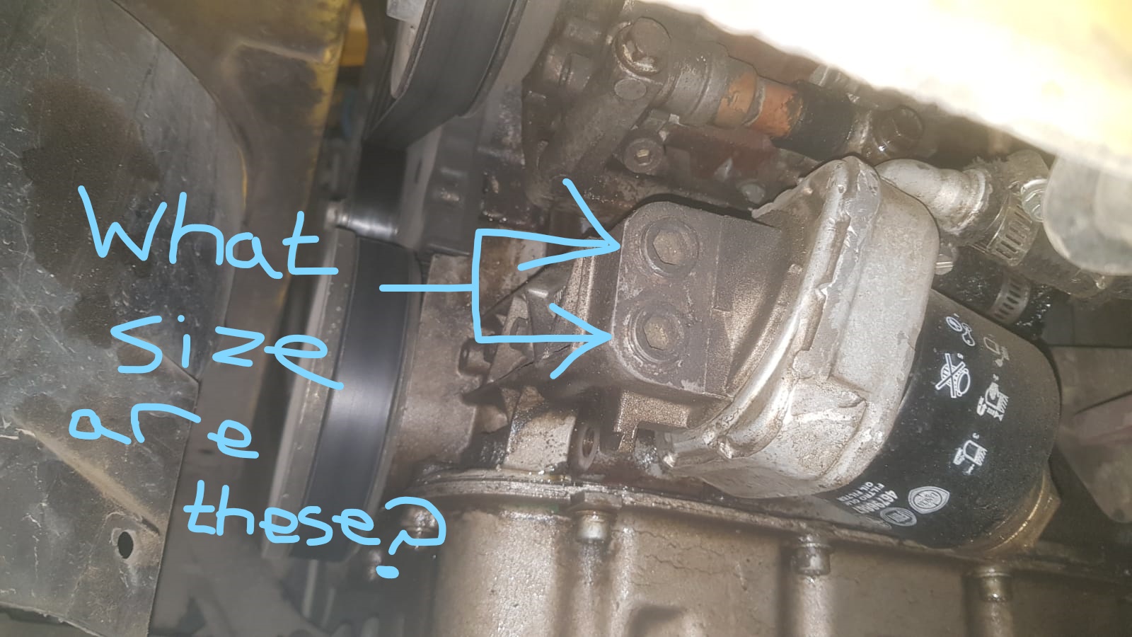

1 - Oil cooler? Temperature gauge? Fitting to oil filter housing?
I have a coolant leak from the oil heat exchanger(oil filter housing) . I tried fixing it, tried sending it to the welding shop. still leaks (well now at least it doesn't drip) so I drive like that in the meantime. (I got a U-Shaped bypass in my car for any unfortunate that is to come with this cooler.)
Getting a new one is way out of reason. (around 450-600 US dollar for a new one, not going to risk for a second hand one) so I figured making an external air to oil cooler (10 rows or whatever that will do the trick) instead of the OEM coolant to oil cooler.
The thing is I want to know I am making the oil 'cooler' and really making an improvement instead of the opposite. so the car won't have trouble lets say on the track or long highway trips.
There are 2 Allen key bolts on the original OEM heat exchanger (part n. 60610797)
*I try to attach the pic I took from my car*
So I thought of ordering a temp gauge with a sensor to analyze the temperature with the OEM part and aftermarket cooler.
but I can't seem to find any that will fit right now.
I measured the Allen bolts on the cooler they're e.d. is 18mm.
I can't find any fitting right now or a sensor or a gauge that will do the trick.
any help in this matter will be highly appreciated. maybe I'm just overthinking things and should just make the 10-row ex. cooler and cancel the OEM one and that's it. but I want to be sure that's alright for this car.

About the oil fitting, these are M18x1.5. I ordered a couple of fittings m18x1.5 to AN-10. to 10 row oil cooler.
but you should consider getting an oil filter adapter because it will have a thermostat which will open the circuit only when the engine is hot.
